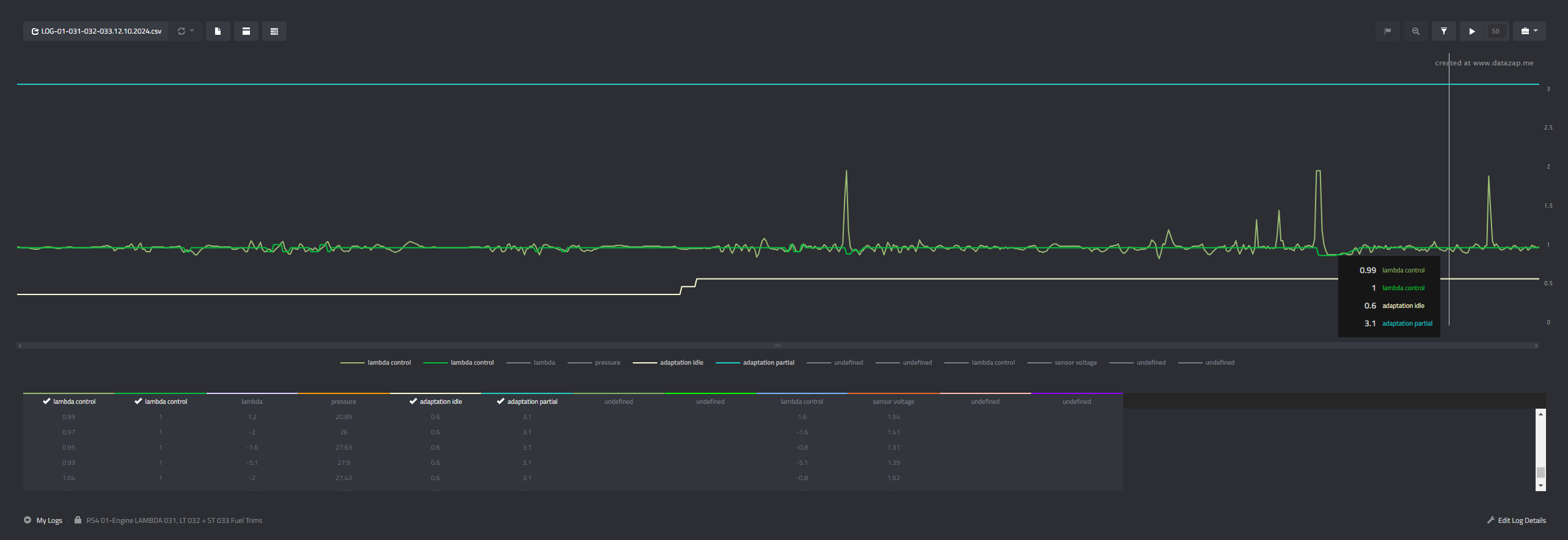

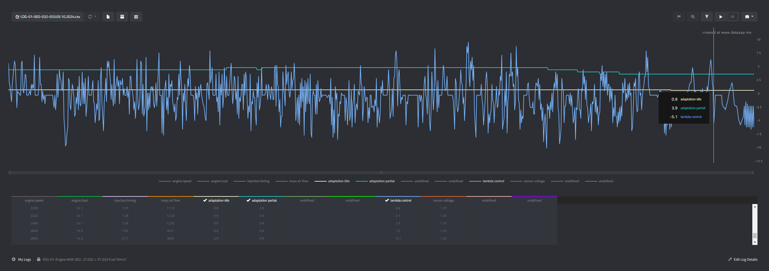

Secondly - is the Fuel Trim Values being logged.
Currently, VCDS is reporting both banks on the RS as running LEAN with Positive values being reported across both Banks:
Long Term Fuel Trim Bank 1 - 01-Engine > MVB 032
Adaptation (Idle) B1 S1 0.9%
Adaptation (Partial) B1 S1 3.9%
Long Term Fuel Trim Bank 2 - 11-Engine > MVB 032
Adaptation (Idle) B2 S1 0.4%
Adaptation (Partial) B2 S1 5.9%
Although it's still early days since getting the RS back on the road, the idle figures across both banks don't look too bad?
On the other hand, the initial readings whilst under load (Partial) seem quite high across both banks @ 3.9% and 5.9% respectively. Which to me, suggests a Fuel Pressure issue whilst under load..
-Wondering what your Fuel Trim Values are across both banks?
So.
Looking at pages of VCDS .csv data on Excel can be a real bore - i gotta tell you :drink:
I export the live data into Datazap.. dont know if anyone else on here uses it?
It's a great tool for Troubleshooting the data more quickly and easily:

Post by r8wut » Wed Nov 20, 2024 11:33 pm
[a few decent Weissbier later.. -works wonders]
ok, so we can see it's clear the Misfire's are isolated to and occurring across all Bank 1 cylinders 1-4 now.
Immediate thought was likely a faulty o2 sensor (even though they're all new) , o2 reading false air, exhaust leak, improperly sealed DP flange etc.
- but then, we don't see any o2 sensor related DTC's ?
In my experience, most of the time misfire is caused by lack of Cylinder combustion due to the absence of / weak spark, poor fuel metering, or poor compression.
I've heard of stories where running out of fuel or being very low could end up with crap being sucked through the tank and fuel system, causing a misfire.
I had thought of this, as my fuel light had only just come on.. was it a co-incidence ?
to be frank, it did sound like Fuel deprivation to me at the time..
Here's a prime list of Possible Misfire Causes :
  • Ignition system
    Fuel injectors
    Fuel pressure / Fuel Supply faulty
    Possible Leaky / Faulty HPFP :
    allowing fuel pressure drop resulting in long cranking issues
    Overfuelling, poor Fuel economy
    Running out of fuel
    EVAP canister purge valve
    Evaporative emission system
    Low Engine Compression
    Base engine problems
    Controle Module damaged
    Air Intake System leaking
    Ignition Cable(s) and/or Spark Plug(s) faulty
    Ignition Coil(s) faulty
    Exhaust Gas Recirculation (EGR) Valve (N18) stuck/open
    Camshaft Position Sensor (G40) faulty
the Issues experienced, some of which were already present:
  • Hesitation / jerky whilst accelerating from stand-still
    Sometimes stalling when coming to idle
    Sometimes slight Fuel Smell in Engine Bay
    Very slight Fuel Smell in Oil Filler Cap
    Sooty Exhaust
I carried out a Major Service few months back, so we can rule out the following:
  • New Audi Injectors
    New Audi Spark Plugs
    New Audi Coil Packs
    New Fuel Filter
    NOT Pulling Timing / Timing near perfect
    NO MAF DTC's logged
**new 4x o2 LAMBDA Probes -> NO o2 (Lambda) Sensor related DTC's , for example: lambda signal implausible, Heating Circuit Malfunction / Open Circuit etc.
So, I don't think it's :
  • The new o2 Lambda Probes or Zinram DP's
    Spark related (although I will be pulling all Bank 1 plugs now - if not at least to give them a clean)
    Engine Compression
Which leads me back to my original concerns with Inadequate Fuel supply volume.. now more likely Fuel starvation as a result of faulty HPFP(s) - which appear to be the original 2007 yr units
Installation of new Audi OE / Hitachi HPFP's with Cam followers up next ..
Anyone care to share any similar experiences or thoughts on the above?

Post by F4rdy » Thu Nov 21, 2024 12:42 am
Ensure the oxygen sensors are plugged into the correct connector for each bank/ecu and not switched over/mixed up
If same
Swap front o2 sensors left n right
Could be faulty o2 sensor miss reading causing missfire on one bank
