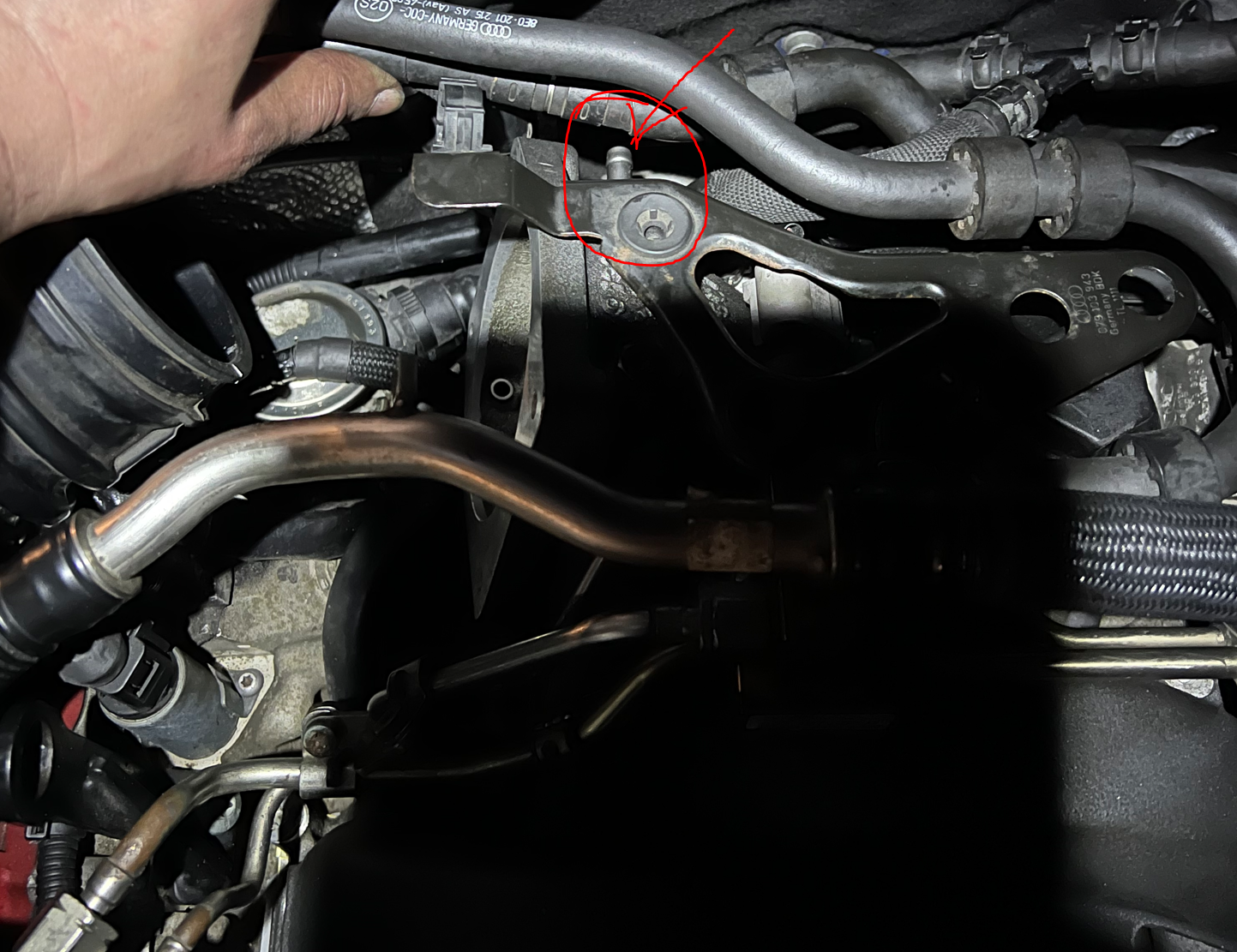

Having had the manifold off for a month or two while fixing a load of bits on the car and carbon cleaning, i seem to have mislaid a rubber cap.
Its very odd, i bag all the bits carefully, to the point i question it was on there when i removed the maniflold, but cant believe it would run without it....
Could someone take a look at theirs and advise if it has a retaining clip or just the rubber cap?
It goes here:

I just had a look at my manifold (which is still off the RS) and mine doesn't have that inlet bit - manifold design appears to have changed slightly in that it seems to have been hard capped out at the factory.
Mine is a 2008 yr model, so I had a look at ebay .. and another 2008 yr manifold listed appears to have this inlet, like yours, albeit capped off with the rubber cap
here's the pics from the listing:

I would pickup the rubber cap from the dealership.. probably not much.. maybe came / dropped off when removing the manifold?

Thanks guys, will pick one up.
I may have taken it of and lost it, its been too long, started this project last year!
