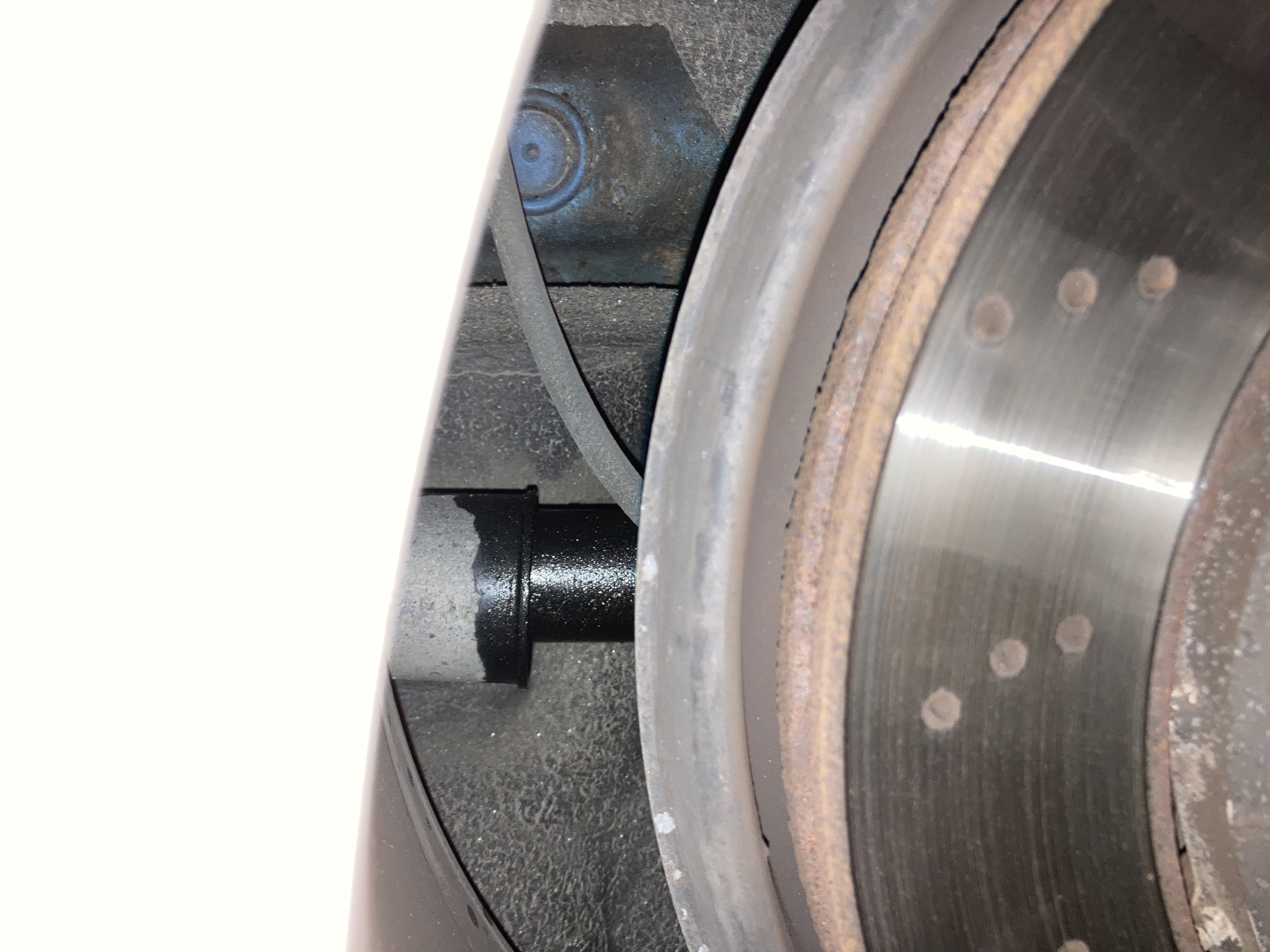

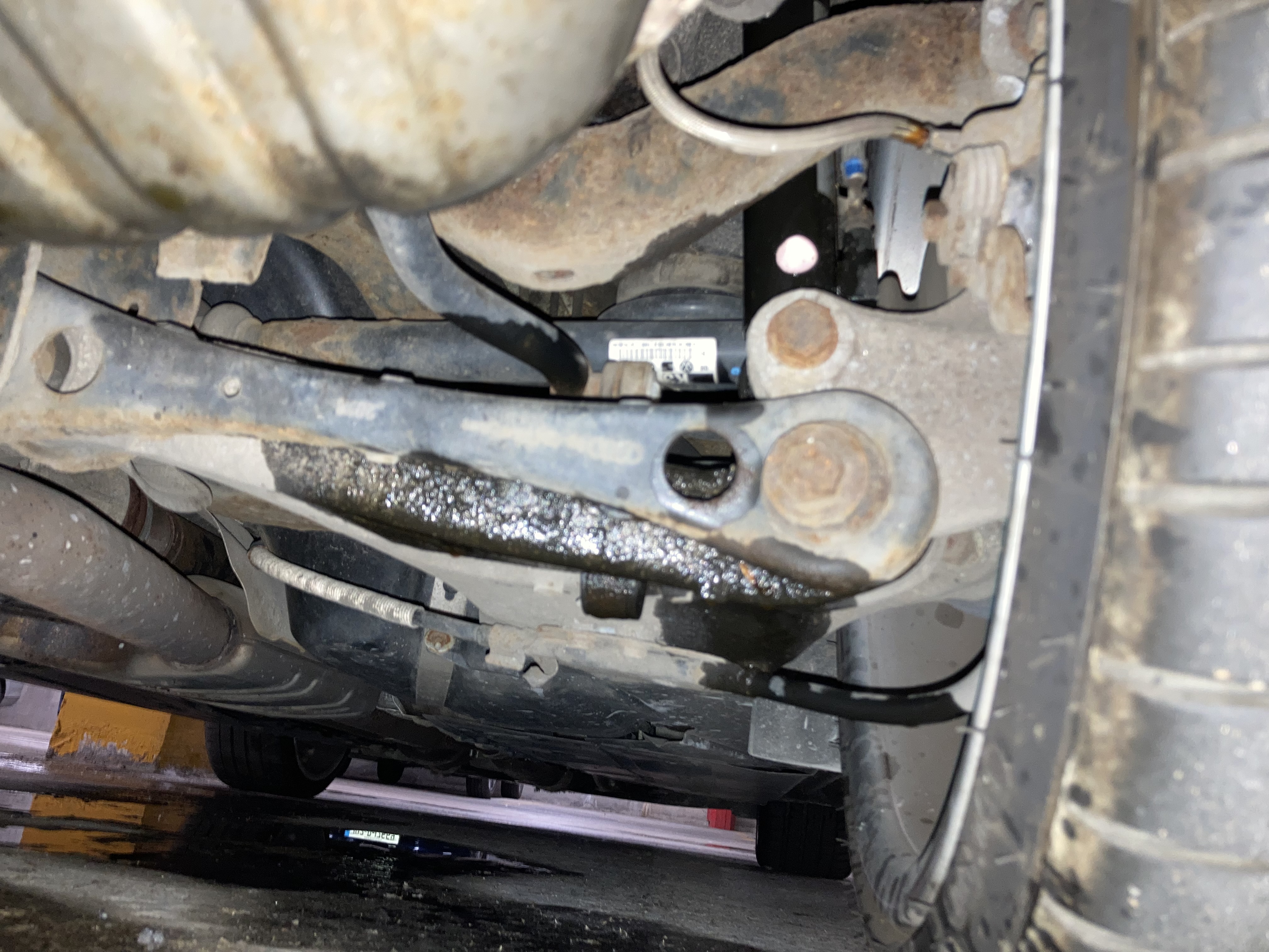

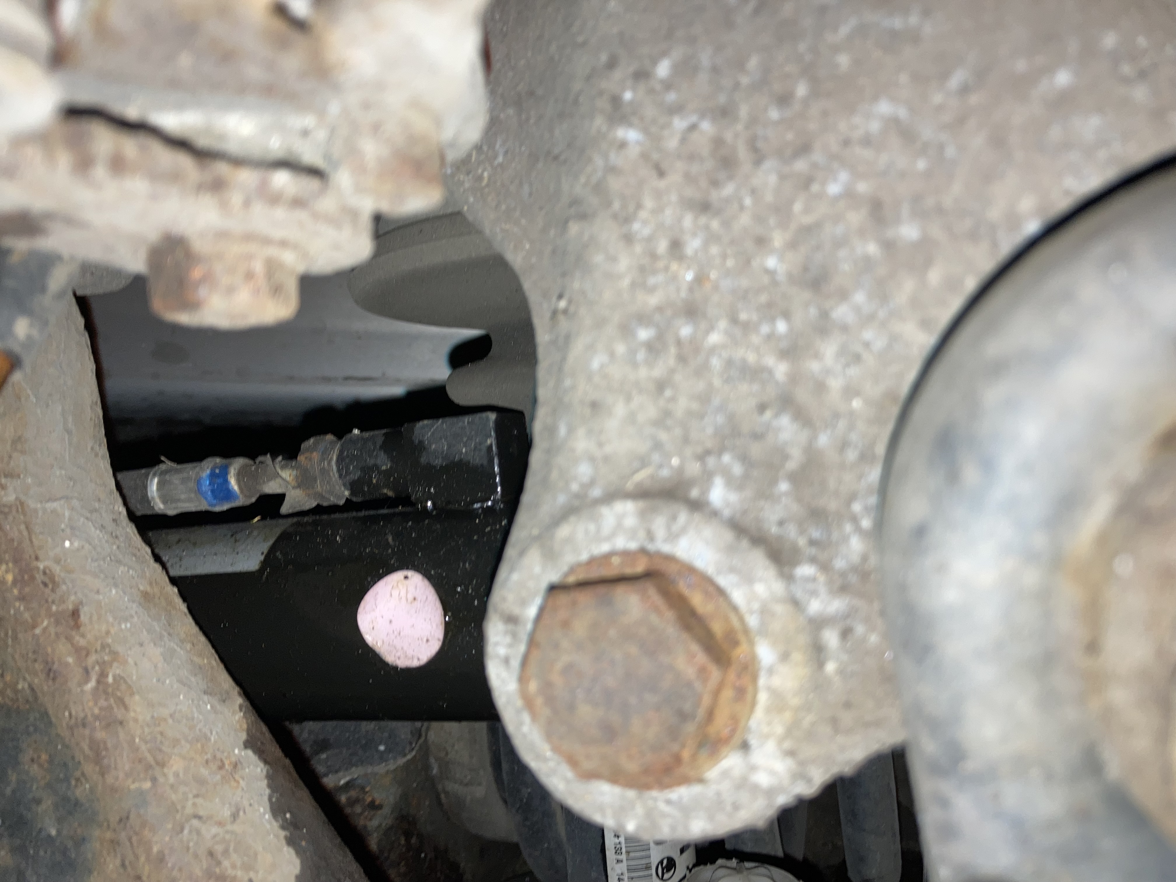

Hey all,
As the title suggests, I've had a rear drivers side DRC Shock fail after about 5k miles. I bought the shock brand new from Audi, I got it fitted by an independent and then the car went back to Audi for a re-charge of the system.
Driving home yesterday I heard the dreaded knock, I thought it couldn't be as I've just had 4 brand new shocks and all the flexi's and hard lines replaced. Massive amount of money spent. But got out of the car and checked and low behold, rear shock is pissing oil. It's coming from the shock and not the connection so it isn't down to instalment, don't to the component failing.
All work was done in October of 2021 and as I said I've done 5k miles since.
Surely a part shouldn't fail that quickly. Have I any recourse with Audi? How would any of you approach this?
Here are some pics below. Some are sideways but you get the idea.
Thanks in advance for any help!
B
B

If you had it installed and drove it without it first being recharged you most likely damaged the shock and even the rear central valve.
They have to be installed and charged at the same time.
If that wasn't the case then it may be that you hit a pothole, or the shock itself is faulty early.

I had it installed at an independent that is about a 10mins from the main dealer. Didn't drive the car. Trailered everywhere. Id say it moved about 5-10 meters if even between installation and being recharged. Possible it got bumped around a bit on the back of the tow truck but could that be enough to destroy a new shock?JamesBaby wrote: ↑Mon May 22, 2023 11:17 amIf you had it installed and drove it without it first being recharged you most likely damaged the shock and even the rear central valve.
When I had it all installed I replaced one of the central valves too.
Either way, credit where credit is due, rang Audi this morning and they immediately said "yeah, there's a 2 year warranty on all parts. So bring it in and we'll have a look" So I've a trailer organised for Thursday morning to bring it to them.
I don't think it's deniable that the shock has failed. It's nobody's fault, these things happen. So we'll see what happens with their inspection.
