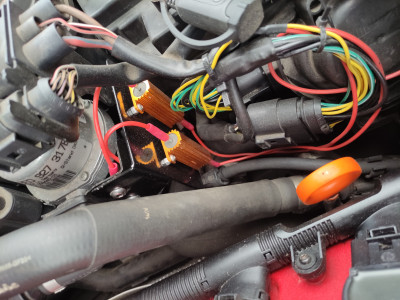

B7s are a bit awkward tbh.
I went for some standard LEDs and housed the resistors outside of the light housings.
mike

mikep99
Posts: 725
Re: DRL bulbs recommendation
Post by mikep99 » Mon Jul 25, 2022 7:48 pm
Here's what I've done... just need to clip into the existing circuits....
Oh, and got some extension cables so as not to mess with the OEM wires
