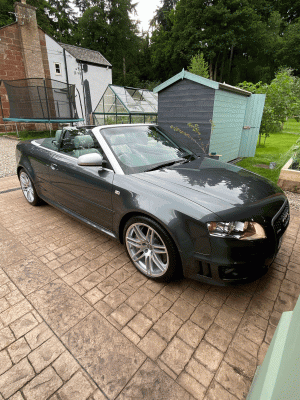

I have just purchased another RS4 Cab - my Forth !! I have not had one for 7 years,
This one has only done 22k from new - 06 plate,
it seems to haver vibration issues and judders - I have had all wheels balanced,
The tyres have sat and have not done a lot of miles in the last few years
Wondered if anyone has any thoughts ?
