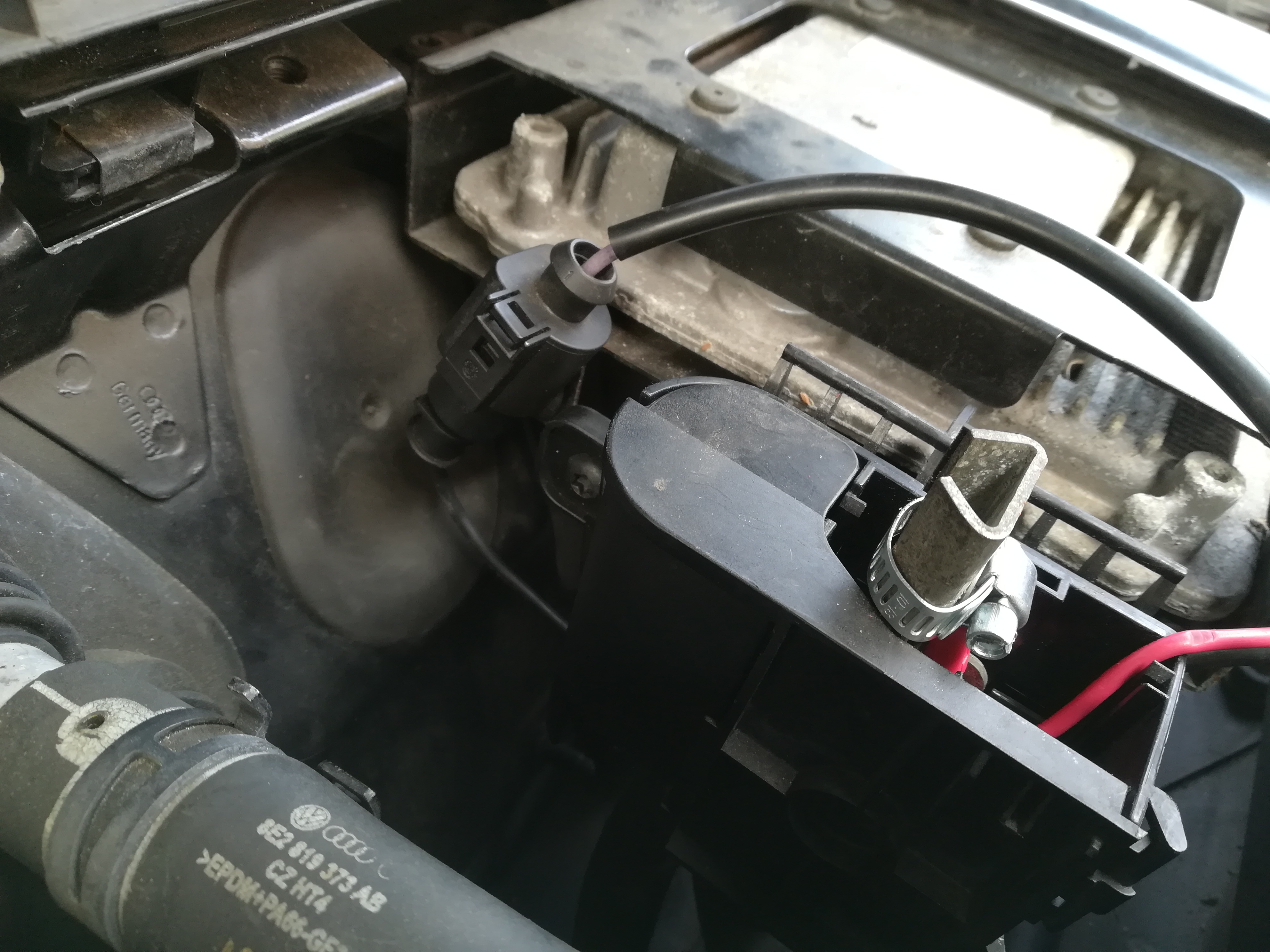

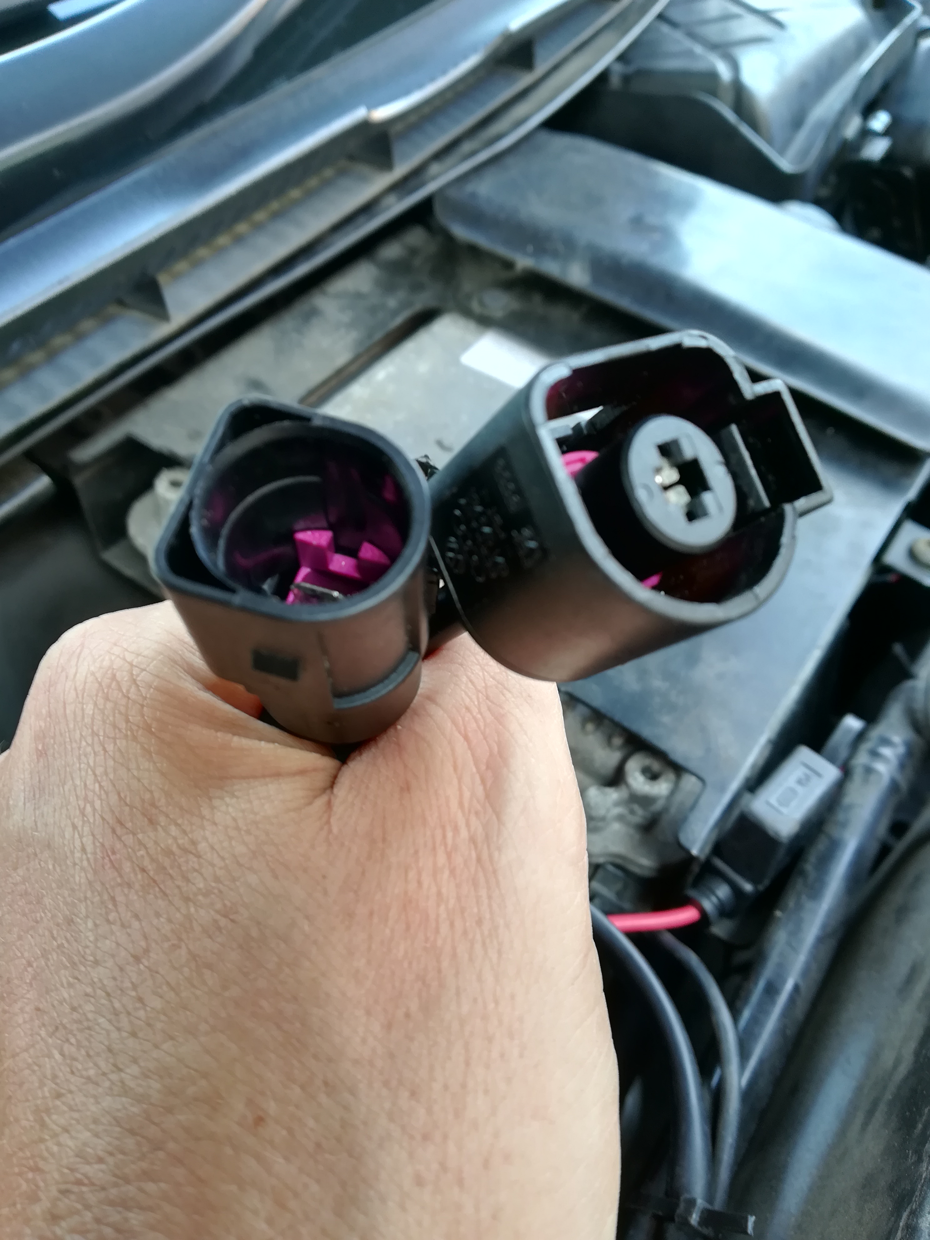

Sounds similar to the issue I had.
I've come to the conclusion that when the under bonnet temps are high, the amps on the starter wire from the ECU drop for some unknown reason.
You can start it by shorting the starter wire with the positive terminal, there's a connector right next to it. See pics.
For the time being, I've put a relay on the starter circuit which lets the starter pull the power from the positive terminal when starting.
Not a had a problem since.... touch wood...
HTH
Mike

mikep99 wrote:
Fri Jun 04, 2021 11:03 am
HTH
Mike
Thanks Mike, I'll give that a shot

Just make sure you short the side of the connector that goes to the starter, not the ECU
