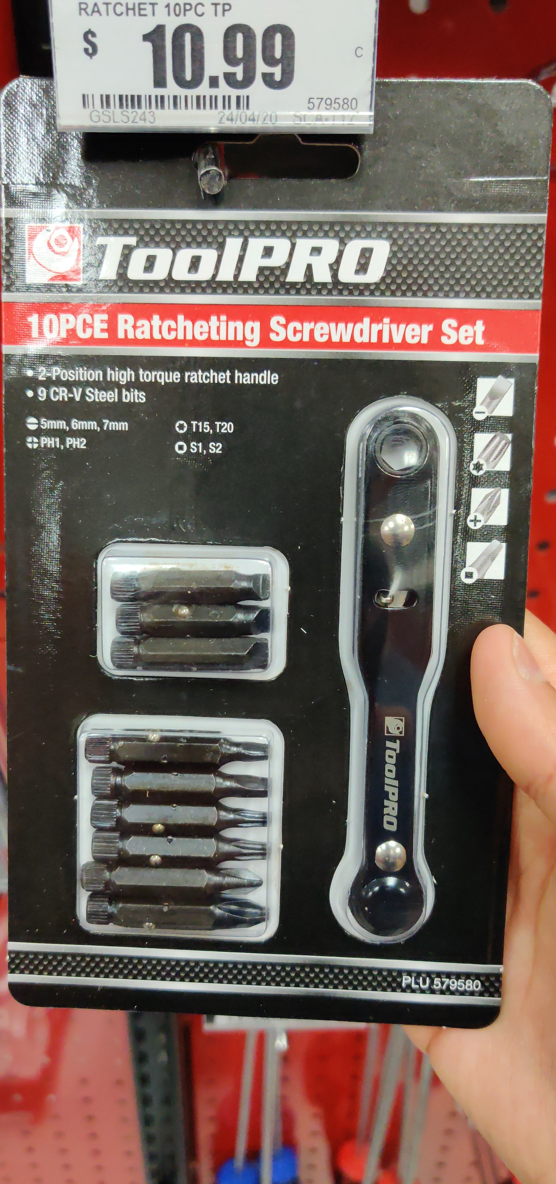

I have recently just started my own CC too and wanted to remove the flaps.
I manage to remove the flaps without taking out the core plugs by using a very small wrench screwdriver.
My plan is to leave out the separators too as they are only useful with the flaps, I've done quite abit of research and came to conclusion about leaving all the rods and actuators in place so it doesn't throw any codes.
Attached a photo of the tool I used to remove the flaps.
Hope this helps!
