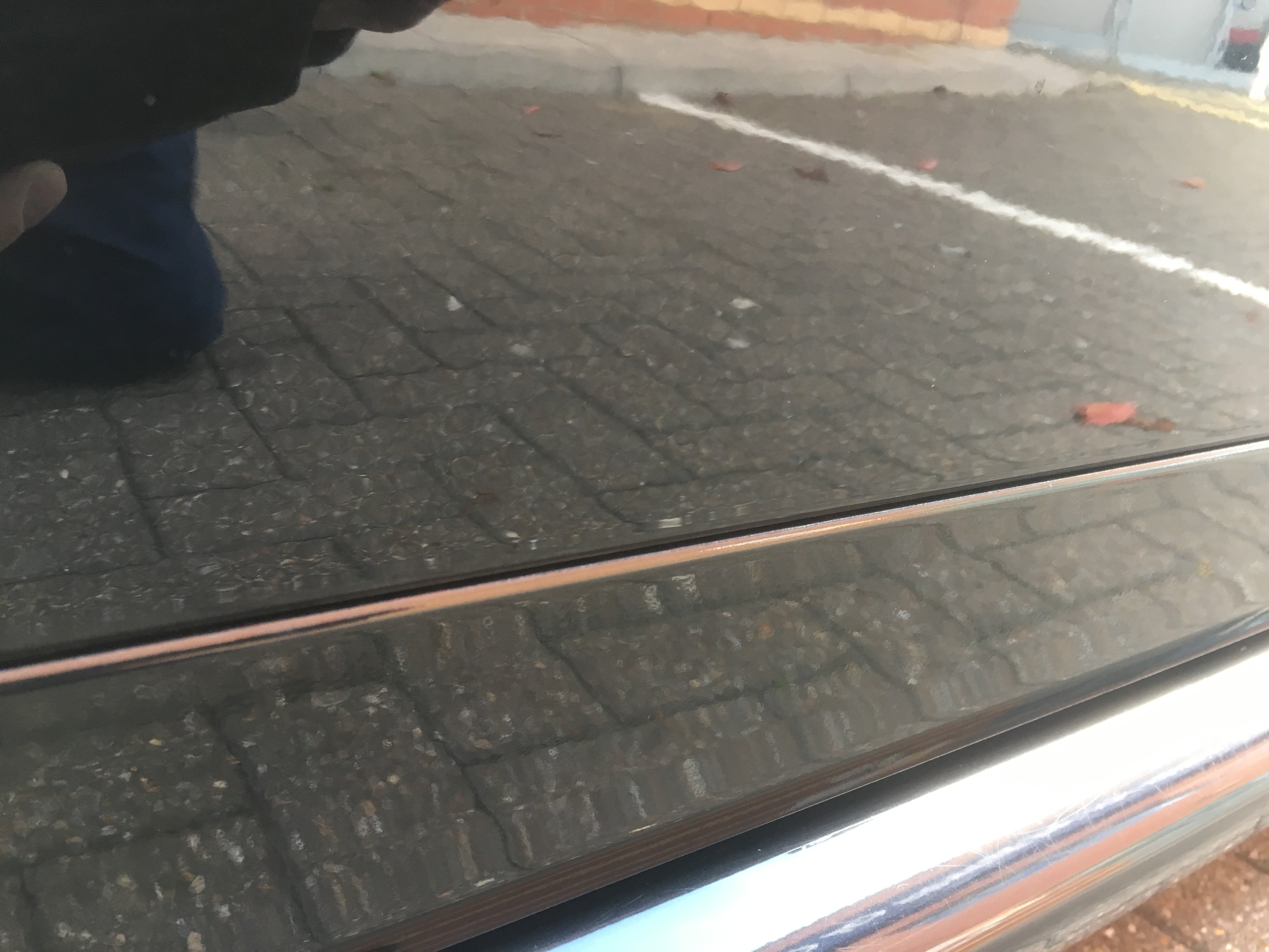

I had an issue with my passengers side door blade. The steel strip that was inside it for rigidity I guess, started rusting badly and lifting blade away from door. My assumption was due to salted roads in England where car was from. Don't know why Audi didn't use stainless. New blade from Audi was hideously priced so decided to try and fix old one.
Took it off, put it upside down on some carpet, gently popped out plastic track that the door studs locate to that fits inside rusty bit. Then slowly removed rusted section inside blade with a mixture of longnosed pliers and chisels etc. It's fiddly and took a while.....try not to bend the blade too much while doing this, you don't want a crease in it.....Then glued plastic track back into blade with gripfill builders glue and clamped.
Put back on car and looks mint. Saved a few bucks for anyone with same problem.

No. The strip taken out completely. It's moulded into the plastic.
