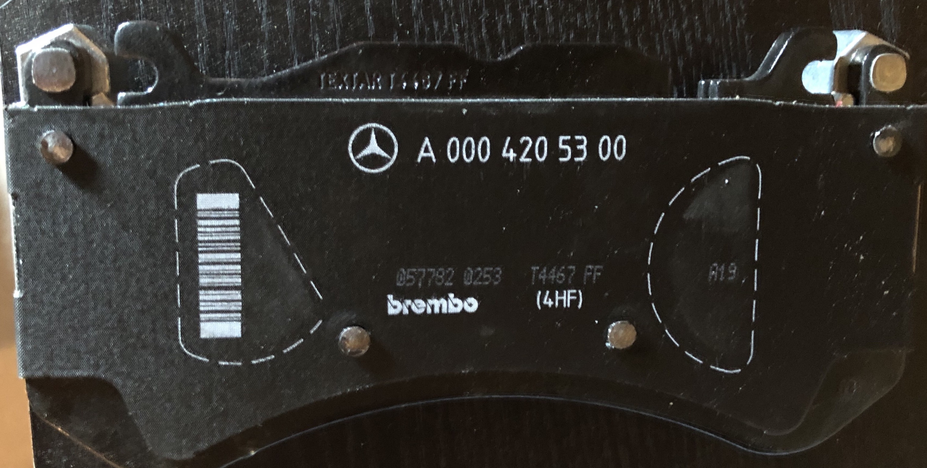

Another oem brand is Textar
My Mercedes and Brembo marked pads bought from the MB dealer are stamped as made by Textar. (Above MB star)
TRW, Textar,Lucas are oem for many MB, BMW,Audi applications
