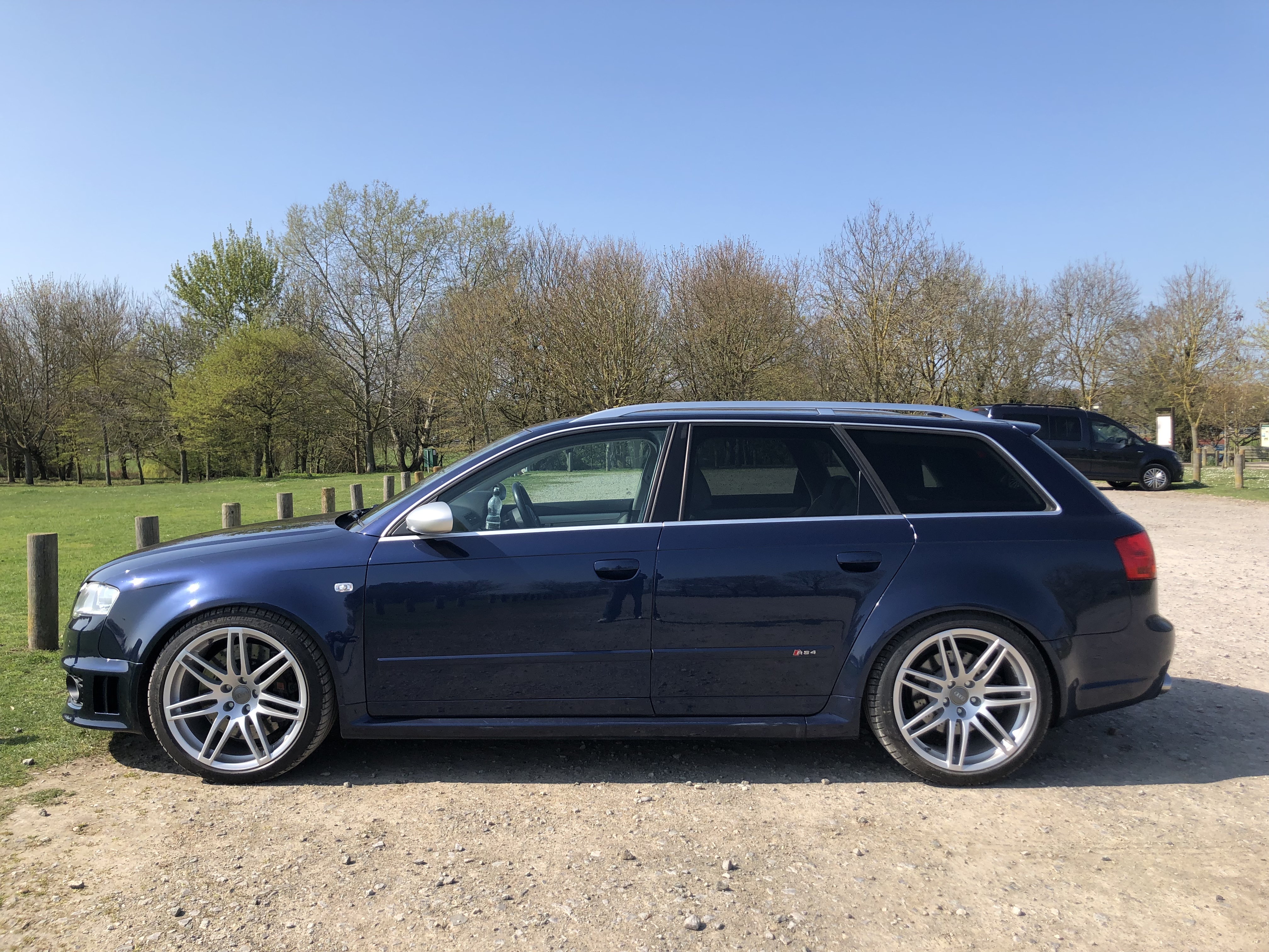

I’m on 8mm but also pss9’s so lowered a little. Gives a little rubbing when peeps in rear.

Nice always liked a Muggy😂
Thanks for the pic and info
