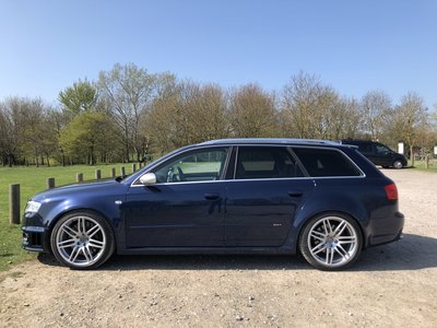

Post by Fatneck73 » Wed Jun 12, 2019 4:58 pm
I’m on 8mm but also pss9’s so lowered a little. Gives a little rubbing when peeps in rear.
Mav8
Posts: 466
Re: What size spacers
Post by Mav8 » Wed Jun 12, 2019 8:55 pm
Nice always liked a Muggy😂
Thanks for the pic and info
