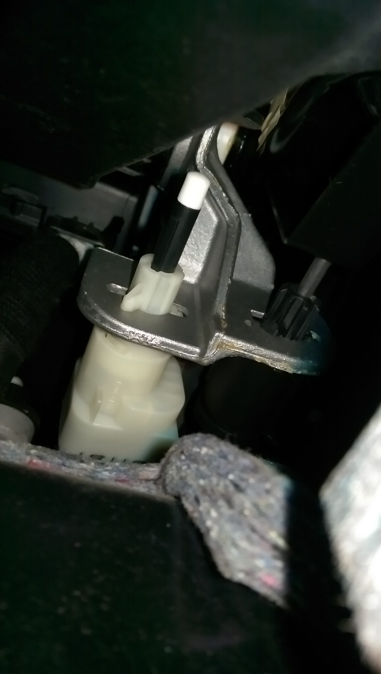

I also changed this upper clutch switch out last year due to no cruise control / holding down of starter button and used part no. 7H00927189. Bought from a local stealer and the casing was black/white £22.
This was the helpful link viewtopic.php?f=35&t=114660#p731104 I used to install as I didn't want to be breaking it after reading the plunger mechanism can be easily damaged if not installed in a certain way.

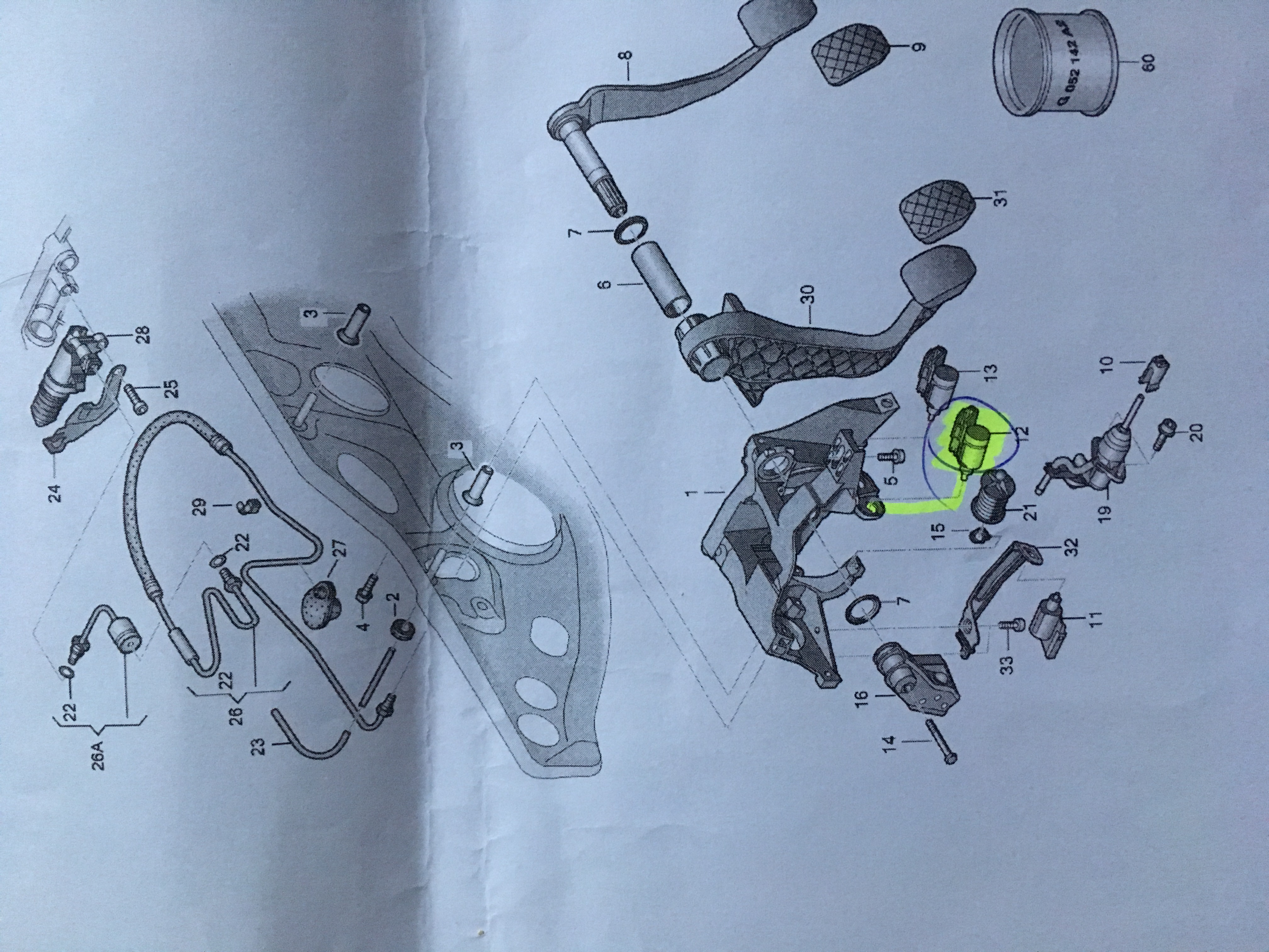

This is getting confusing. I ordered a clutch switch from Audi which according to their diagram is part number 927 189. However, this is not the clutch switch, it’s the brake switch. The diagram shows this switch as being on the left but when operating the pedals this switch is moved by the brake pedal, not the clutch. The same error appears to occur in this guide. Am I going mad?
From Audi
Current: 2007 B7 RS4 Avant sprint blue
Current: 2004/04 TT V6 DSG dolomite with BBS LM.
Gone list: 2018 C7 RS6 Performance in Nardo, 2007 B7 RS4 Avant Phantom Black (should never have sold it), 2003/03 8N TT 225 Black, 2002 8L S3 in Silver, Morgan Aero, Renaultsport Clio, Polo Gti...
