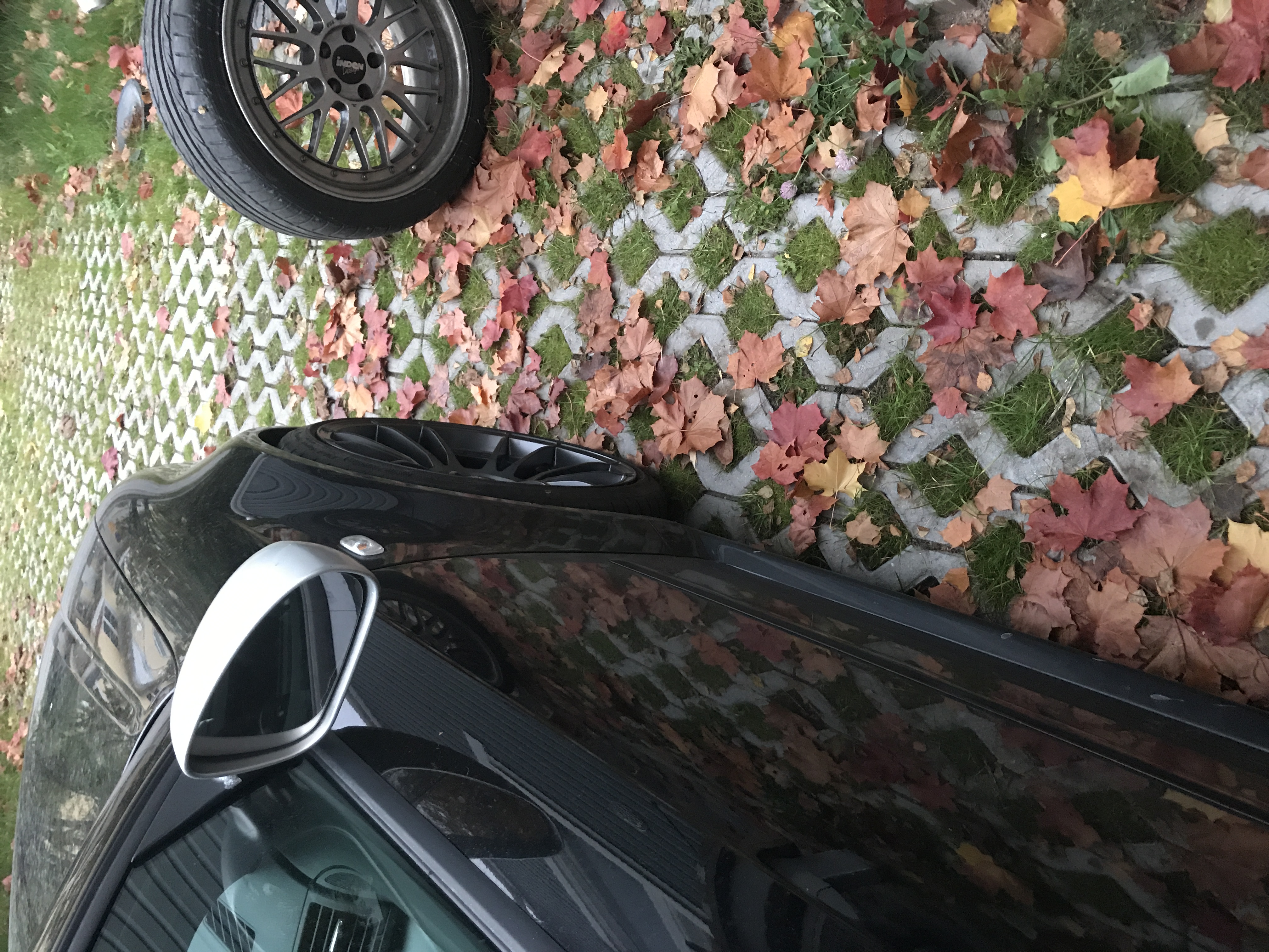

hi all,
We are slowly coming out of the Finnish winter and I am starting to think about summer tyres. I am using 265/30/19 on 10x19 ultraleggeras but when I look at the common options everybody is recommending Supersports and other "racing oriented" rubber. As I am not a racer I have however other requirements:
Important:
- Good rain/wet/cold performance
- Low noise/Soft sidewall
Good to have:
- Rim protection (if possible)
- "Squared stance" (don't like stretch)
Dont care:
- Durability (we do 5k km a year)
I know that the michelins are the best all rounders but I was thinking if other options are sensible and maybe even cheaper for my use case.
