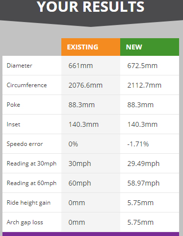

Got a set of OE RS5 20x9", ET 26 Rotors. For my S4 Avant converted to RS4 body. After much research to see what size tires people are using.
255-30-20 seems to be a popular choice. (Photos form the net with these size tires)
In Dubai getting 30 profile tilres is super expensive & might have to even import them.
Did some basic sizing on "willtheyfit.com". If, I were to go with the more easily available 35 profile. I could come close to the 255-30-20 profile.
235-35-20 is almost the same as 255-30-20. There is a ride height gain of only 5.7 mm. Which I can live with as the 35 profile would give just the slight bit of extra cushion compared to 30. Not to mention the cost saving.
Dont plan on slamming the car. A 1" top of tire to center wheel arch is ok for me.
Has anyone used a 35 profile on 20" Rotors? Pics with tire size would help.
Thanks in advance..!

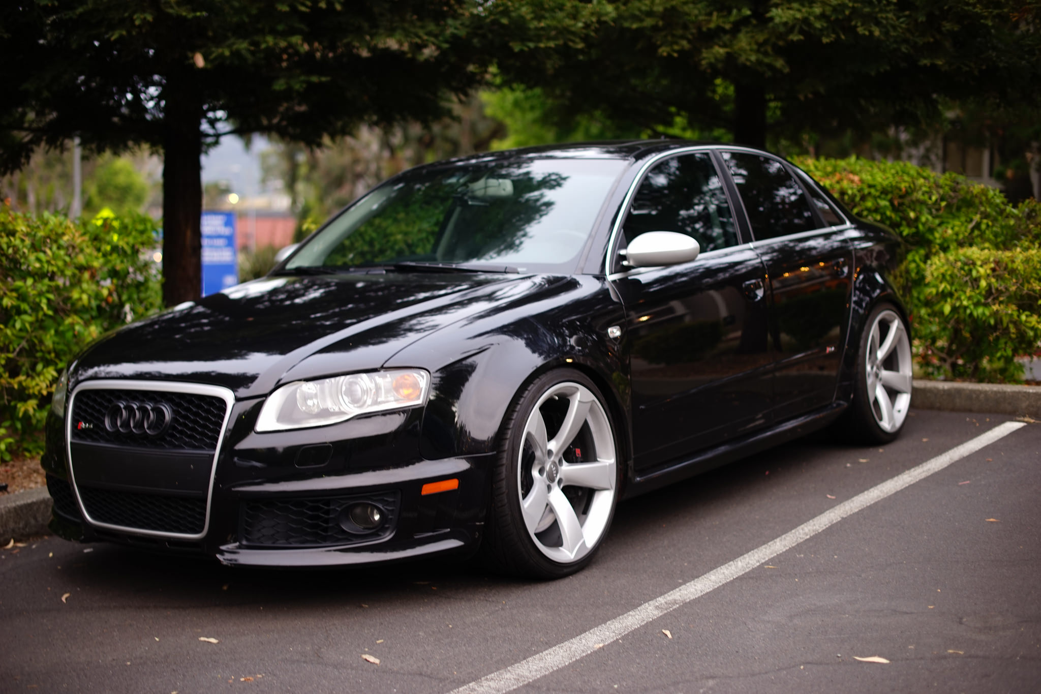

265/30/20
Et26 Oe rotors
No spacers no rub

andyg72
Thats a super tight fitment. Have you rolled the arches?
I'am actually trying to run a 35 profile.

sam-vr6 wrote:andyg72
No rolled arches
Just removed 1 of the arch liner screws
