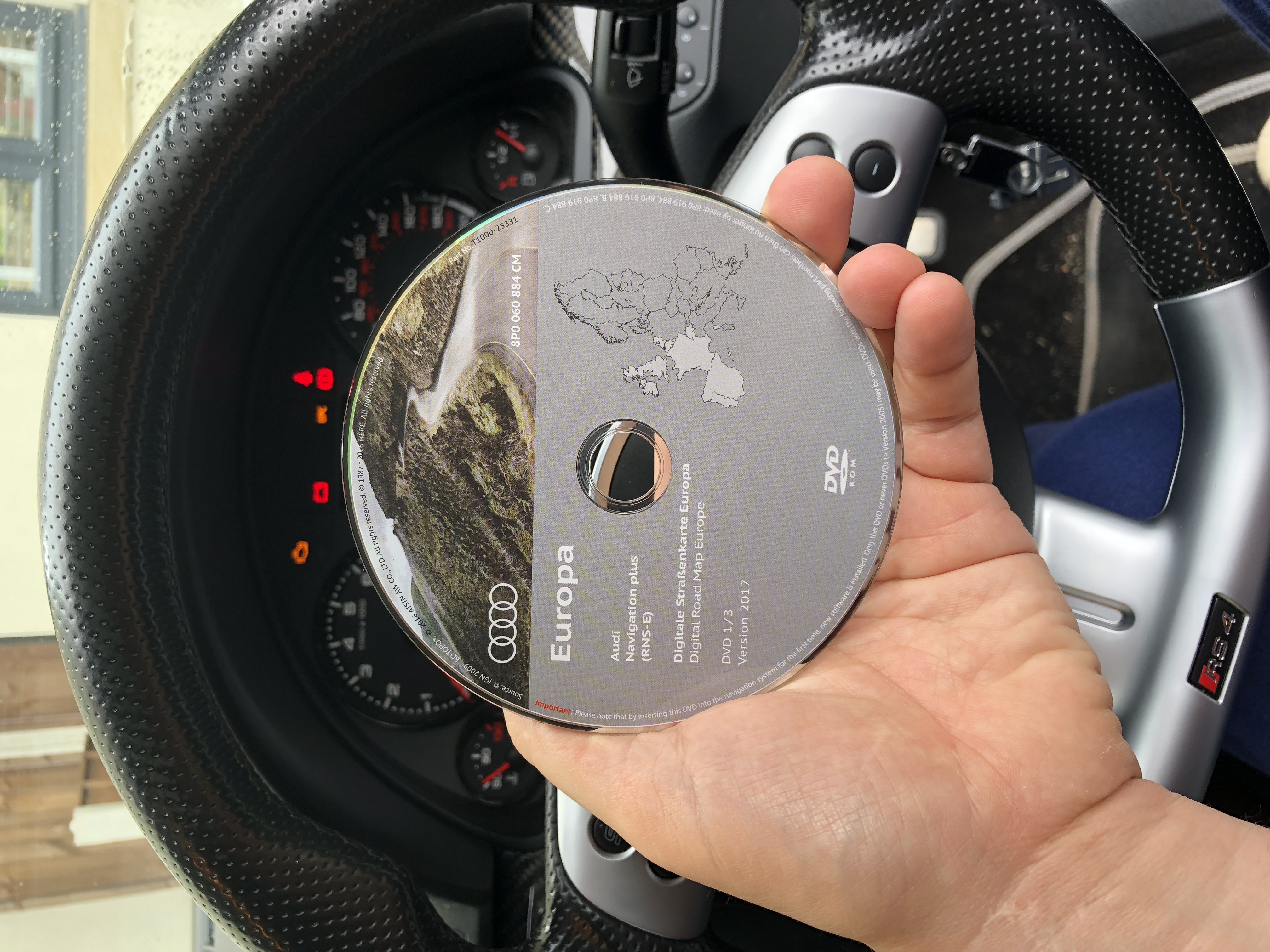

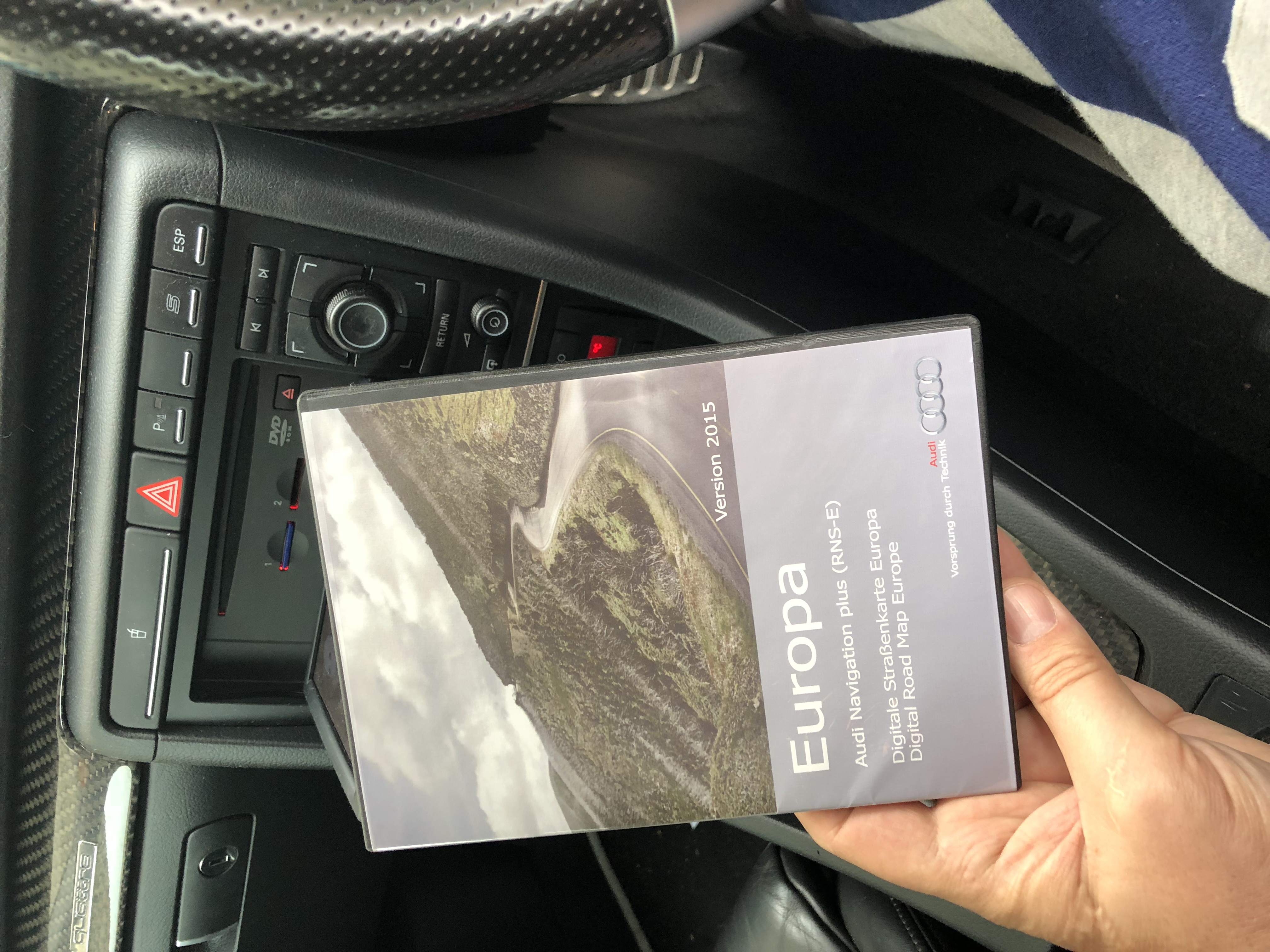

Sorry to drag up an old post for my first question, but I guess that’s what search is for!
Is there anyway to downgrade/backdate your nav system once it’s been upgraded?
Sounds an odd question but bear with me. Based on this thread I got myself a copy of the dodgy 2015 map disc with aforementioned hack for postcodes and speed cameras etc. Great stuff.
Arrived this morning and put it in... nothing. Checked the small print on the disc I’d removed (that my car came with) and it’s 2017! It says once a newer disc has been used (to update firmware) you can’t update from an older disc.
I know, I know, more fool me for not checking first. But it was a £10 impulse buy.
Makes sense but I’d actually rather have cameras and full postcode search with 2015 maps than crappy search and 2017 maps.
Does anyone know if there’s a way to revert, possibly using VCDS?
Ta!

I’m just going on what it says round the edge of my 2017 disc:
“Please not that by inserting this DVD into the navigation system for the first time, new software is installed. Only this DVD or newer DVDs may be used. DVDs with the following part numbers can no longer be used”
It then lists the part number of my 2015 DVD. And sure enough, the 2015 DVD won’t install the software.
I’m guessing when I put the 2015 DVD in, the system is looking at the part number, seeing it’s earlier than currently installed 2017 software, and ignoring the installation/update procedure
