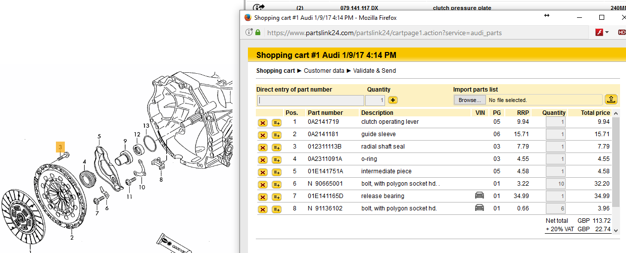

Hi, great thread BTW. Just about to sort my clutch.
Can anyone give me a definitive list of what has been referred to as small consumables?
I have ordered a clutch kit, new DMF and return pipe from rob as advised and just need to make sure I sort anything else before starting.

Here you go;
NB not current prices just a screenshot I have saved from our parts log in
Rob
