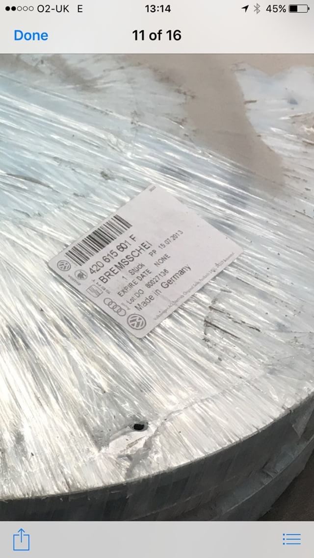

The disks are 356 but i can't remember which model they were off when i purchased mine (wasn't an R8), I've sent a message so will let you know when I hear back.

My mistake. Disk are off an r8.
