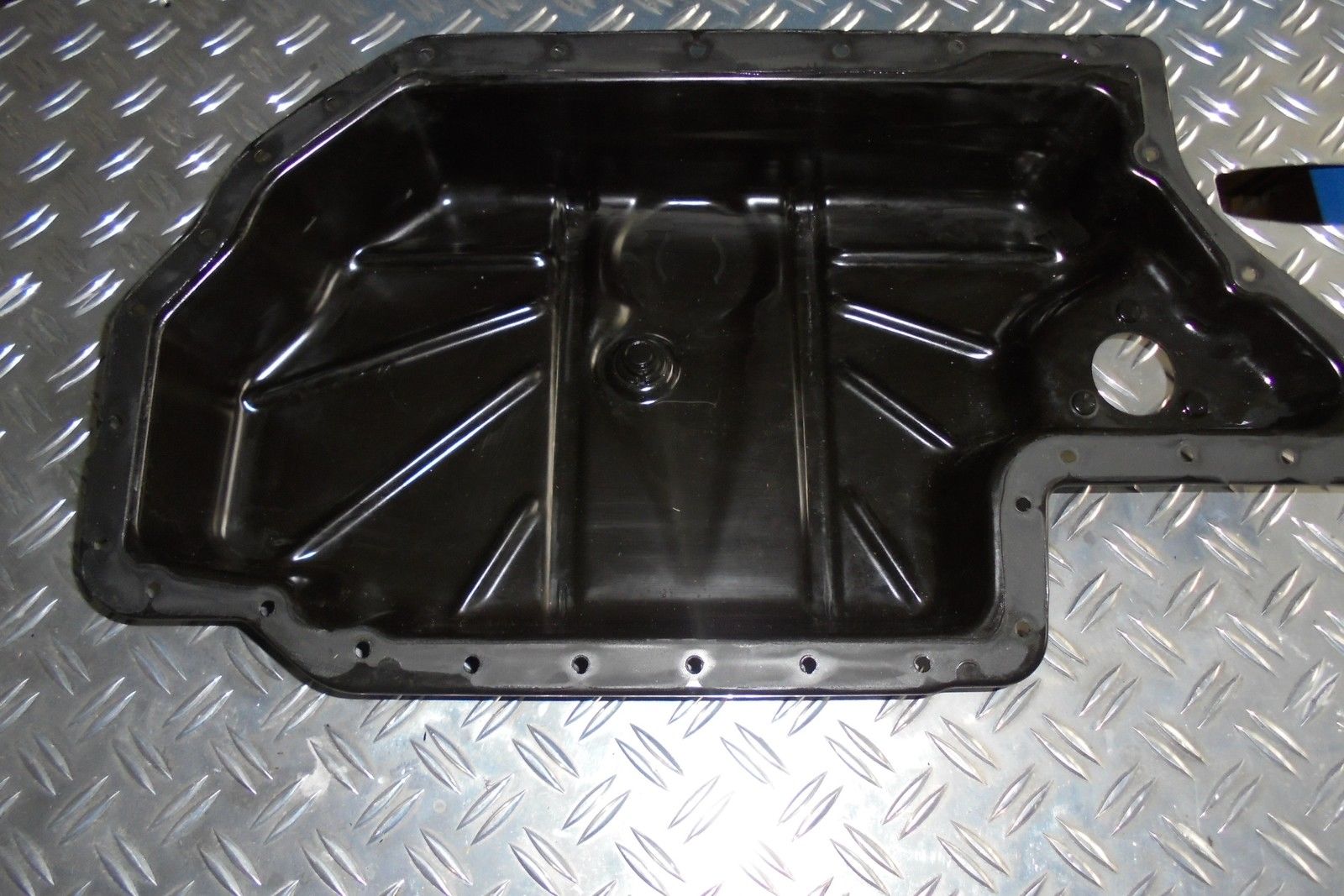

So what happen? Well... after the engine made a stange sound, at which point anyone can tell that's not right, I had the oil drained (new oil had been in for maybe 500km's) to inspect if there was any metallic particles visible. Stangely we didn't see any. When the oilpan came off it was all clear at that point.
It turned out there were two hard ruber parts stuck in the oil feed pipe. But since the pipe has a mesh inside, the parts had not been sucked futher and were visibly stuck.

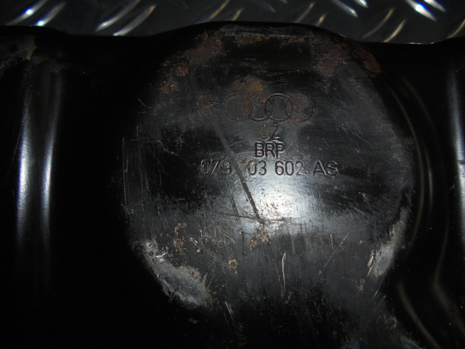

Now would be great time to look at the pictures (I got them of google just now). Basicly my oilpan looked exaclty the same when it was taken off. Inside the oilpan we saw metallic particles. Since the drain plug isn't the lowest point on the oilpan all the particles were stayed inside. There wasn't much, but now clearly visible.
How could this have happend?
So three years ago I lived in an apartment which had quite steep entrance to the carpark. Most probably the oilpan got damaged at that time. If you look at the pictures there is a part which is lower that the rest of the oilpan. That is where the feed pipe is located. The ruber parts are suppoused to be between the pipe and the oilpan. Looking at the picture which shows the inside of the oilpan, you can see where the ruber parts are in contact with the oilpan.
So from my experiance thus far, I'd say any oilpan which has been in contact (lightly damaged) most probably will have the same problem. The oil starvation will slowly deteriorate the crankshaft and cause engine failure.
Knowing this now I'm sure it could have been prevented to some extent. Saddly taking off the oilpan will require taking off one coolant pipe as well. But if you see similar damage to the oilpan (even slight) I'd suggest to have your car checked. Will be cheaper down the line!
