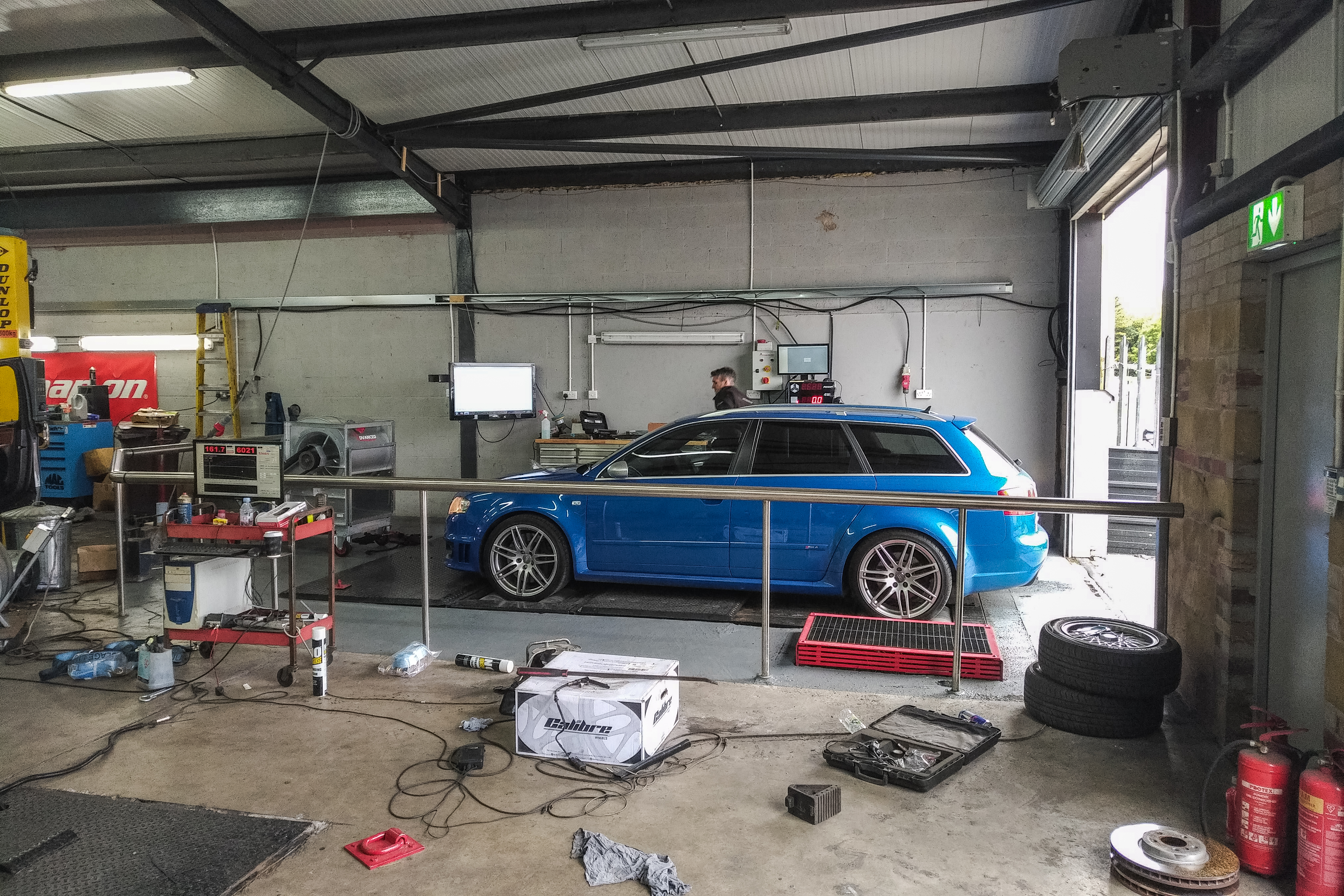

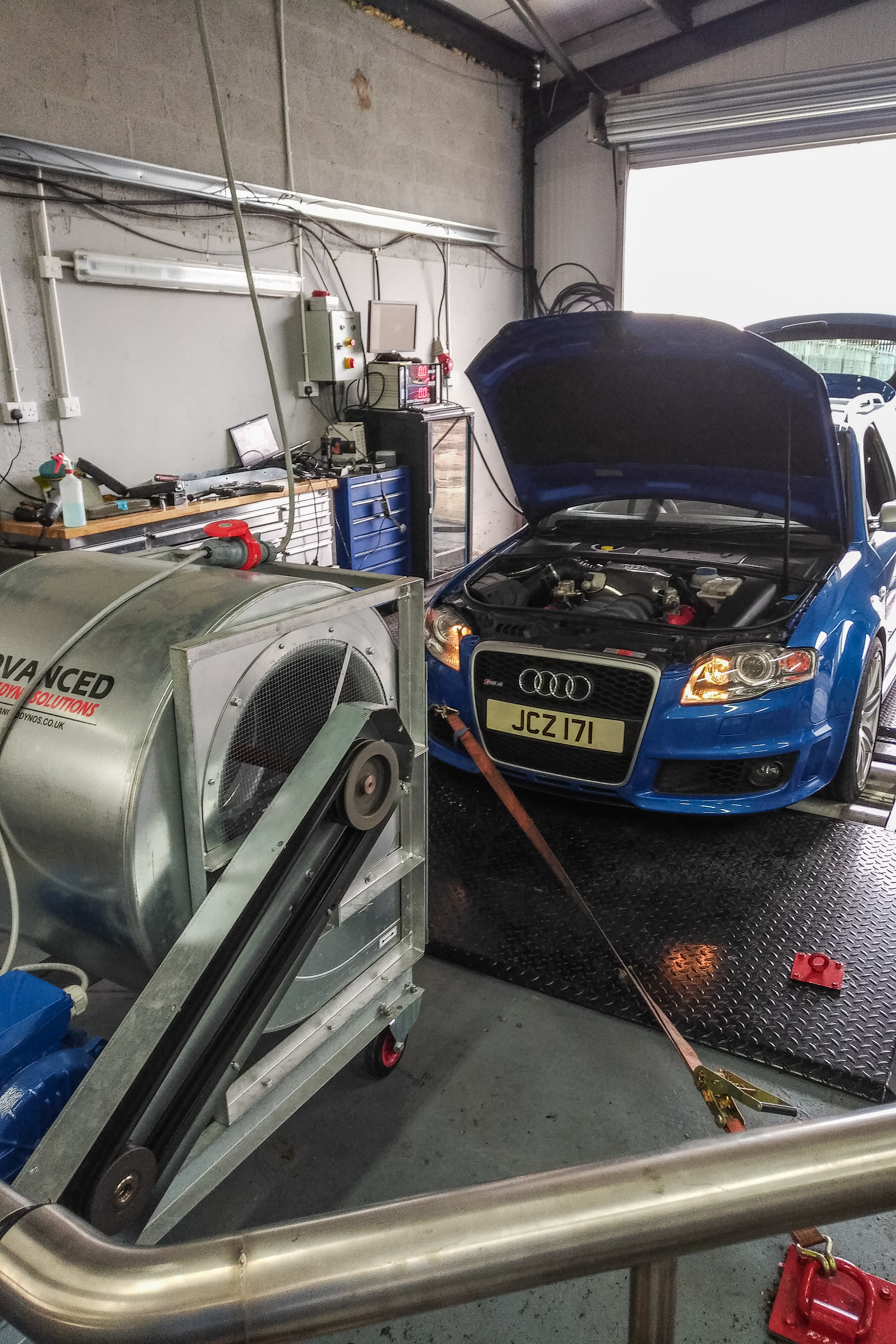

I bought a 2006 RS4 avant a couple of years ago. She has 59k miles on the clock. Mighty clean inside and out. Over the past year I had been toying with the idea of getting the boat across the water to MRC and getting a carbon clean and remap. However my local tuning company Autotune recently got a new 4wd dyno and local Audi garage McAvoy Motors a walnut blaster so I thought I would do a test to see what the local guys are like.

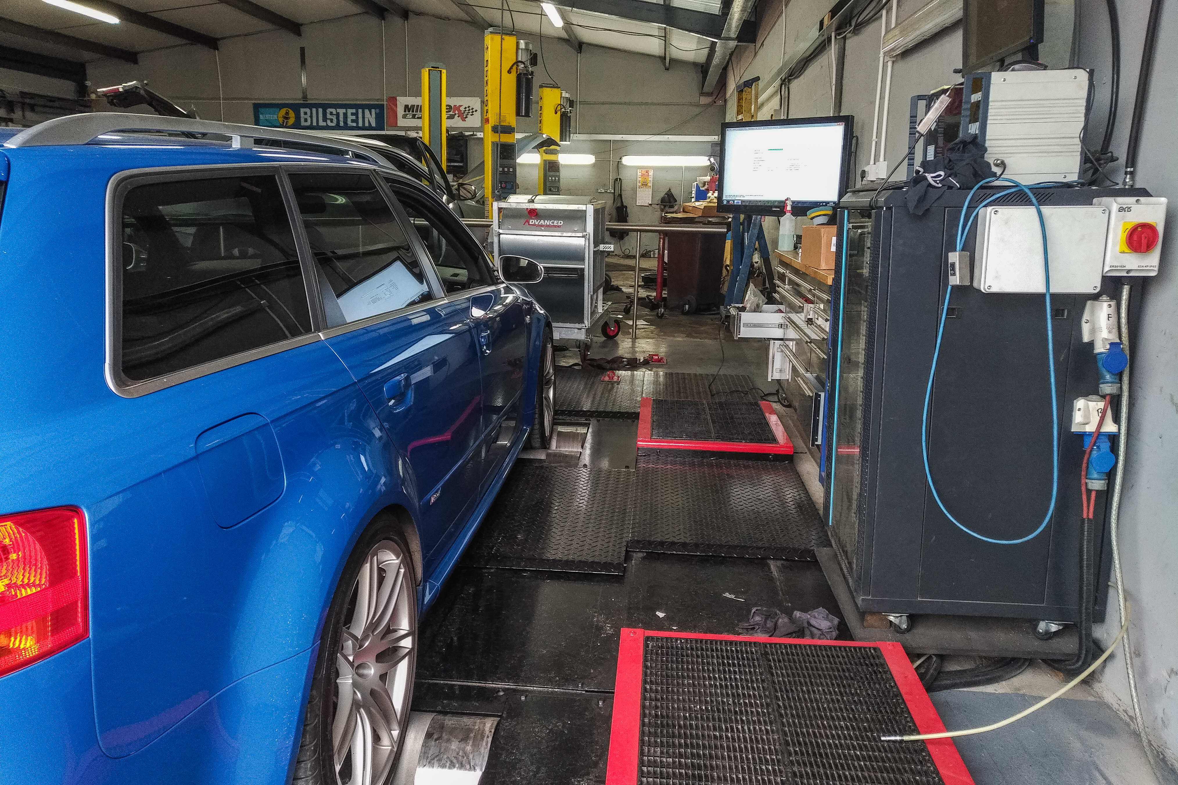

First up was the before dyno.

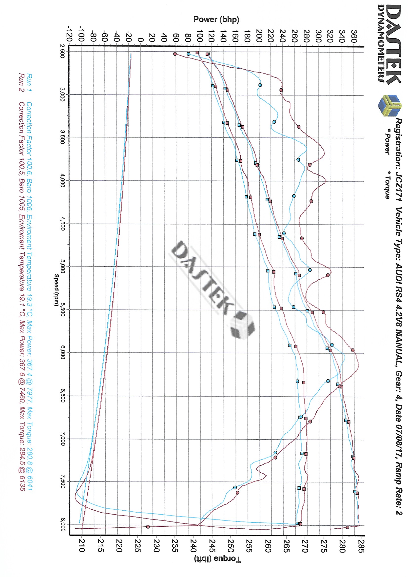

The first dyno had 3 runs.
All pretty similar readings
So pre carbon clean it was 367.6bhp,

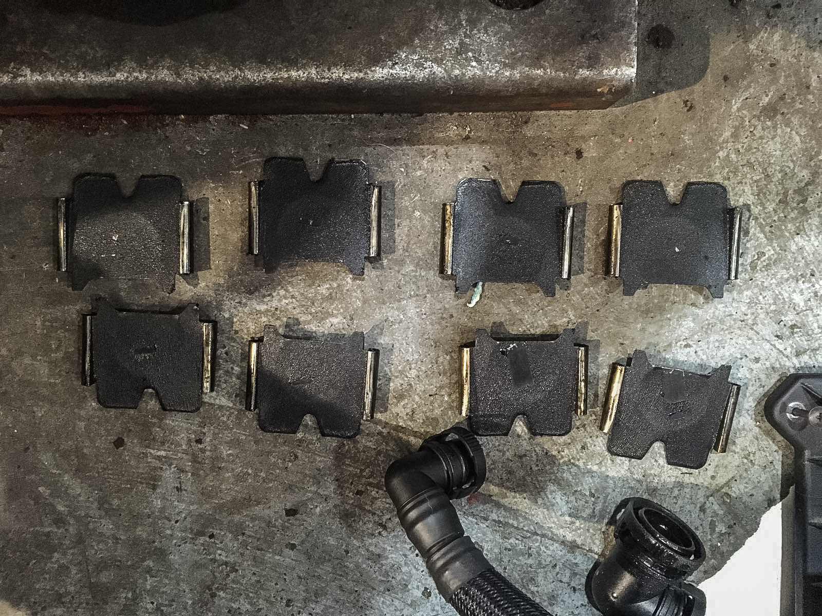

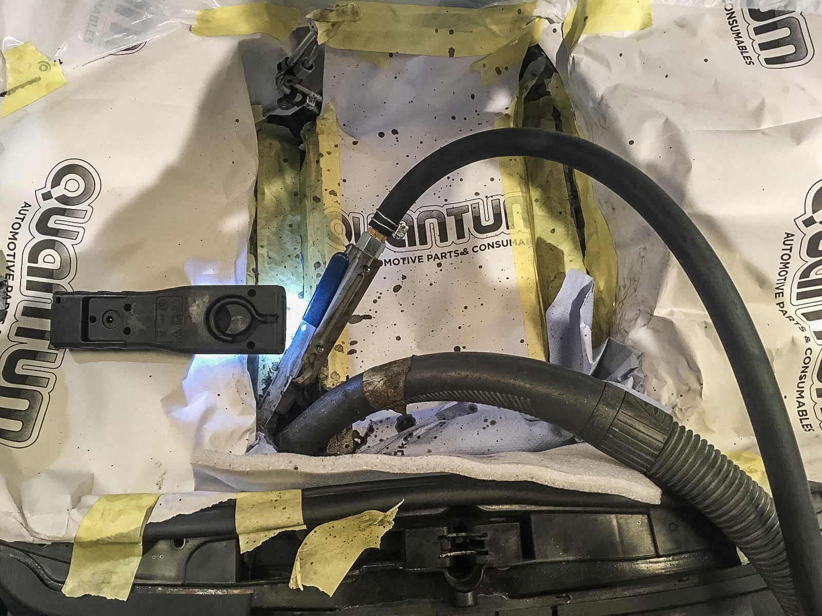

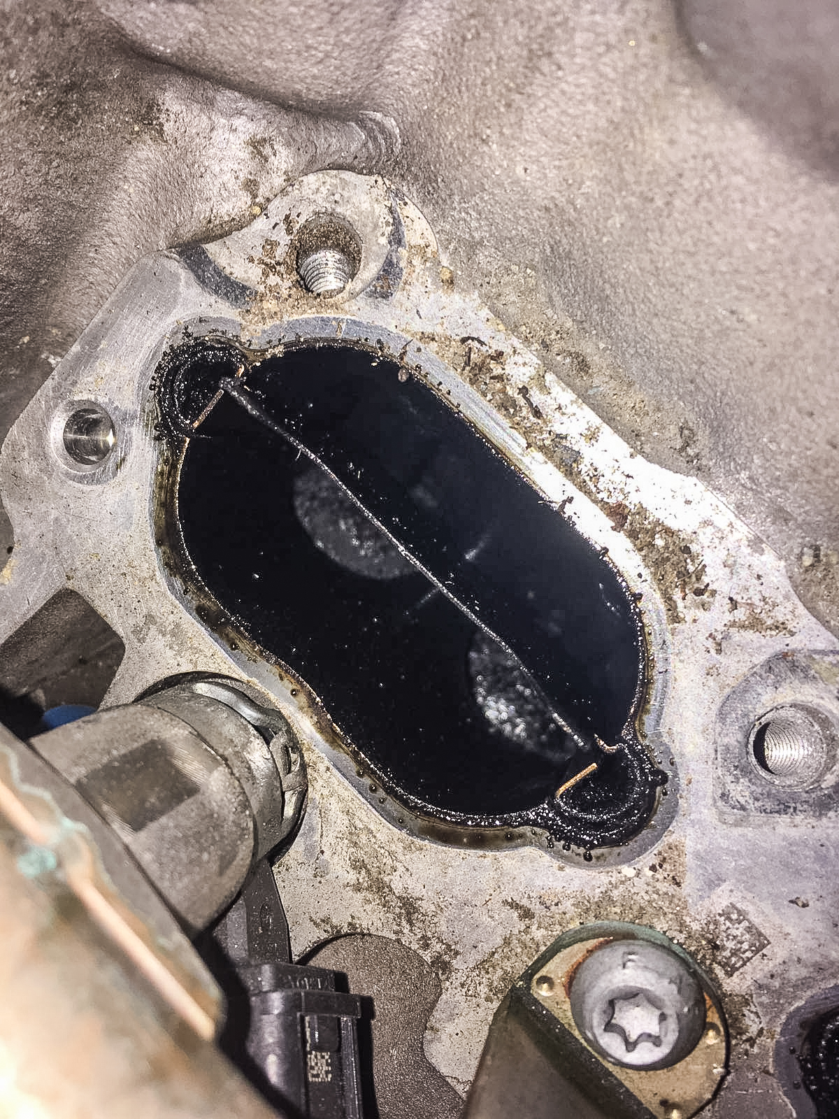

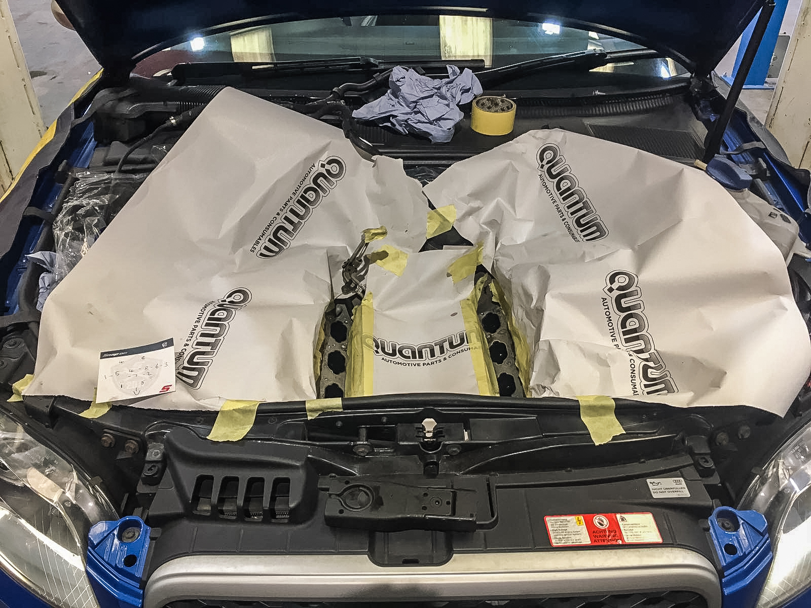

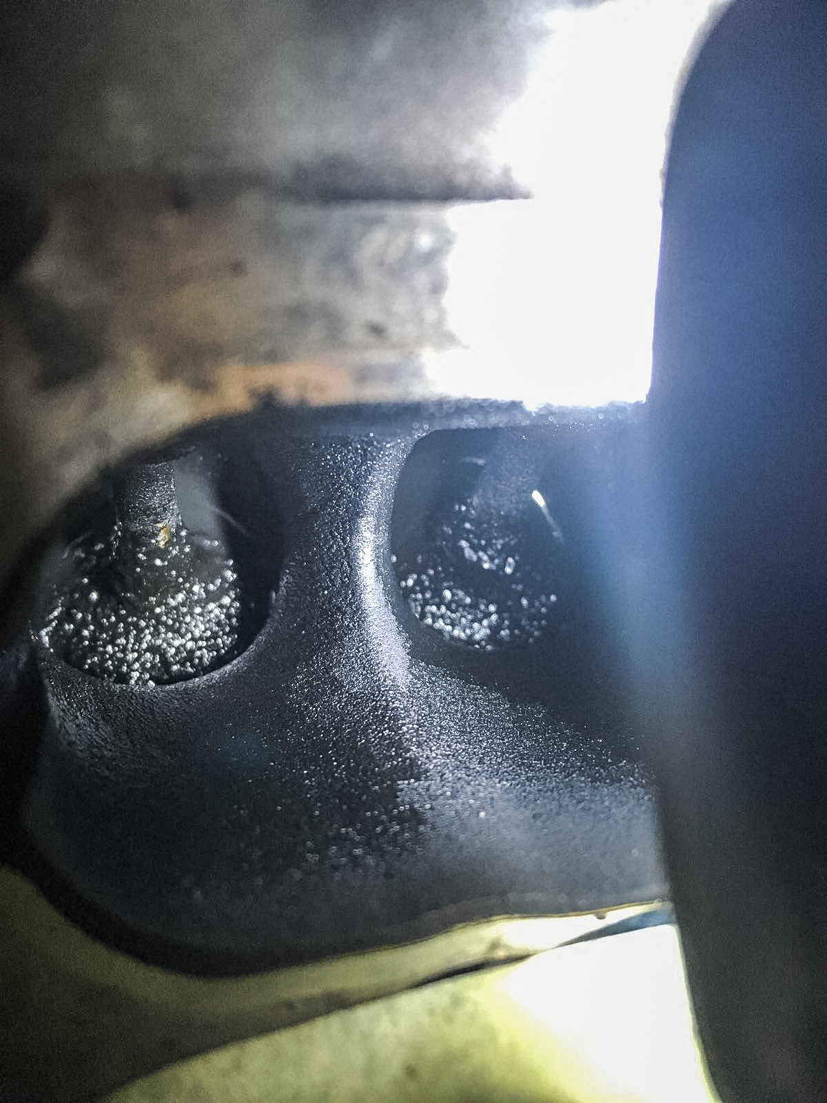

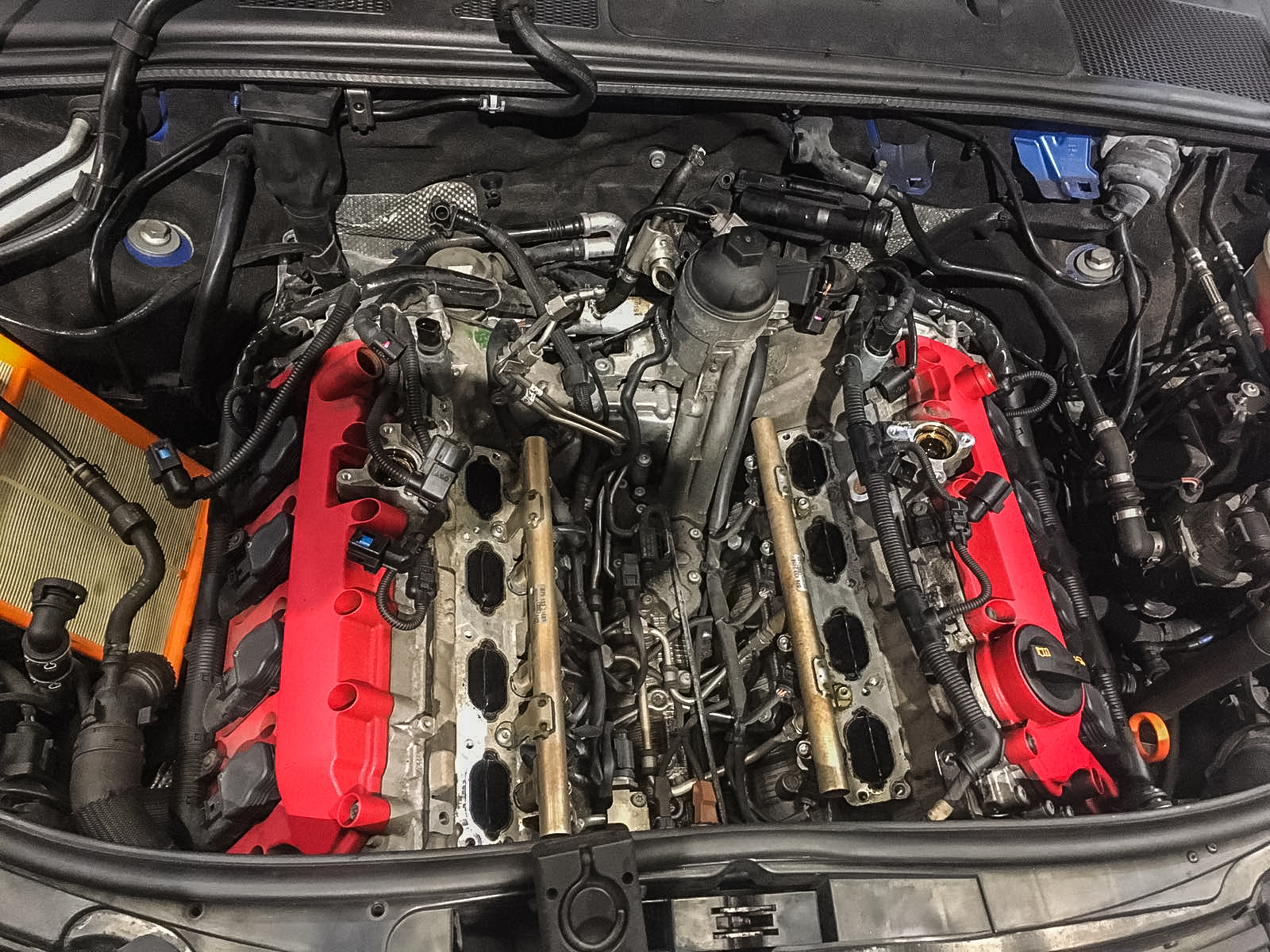

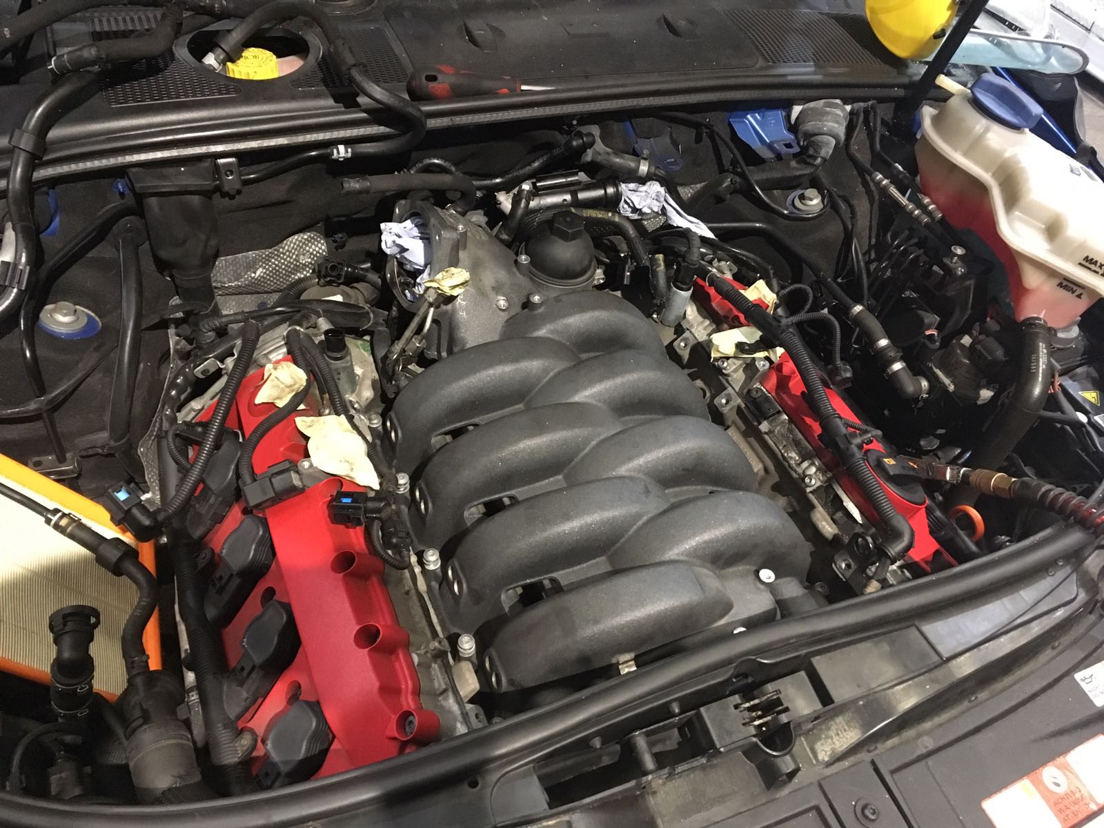

So now onto McEvoys for the carbon clean.
Andy took photos off every inlet before and after as well as videos before and after.

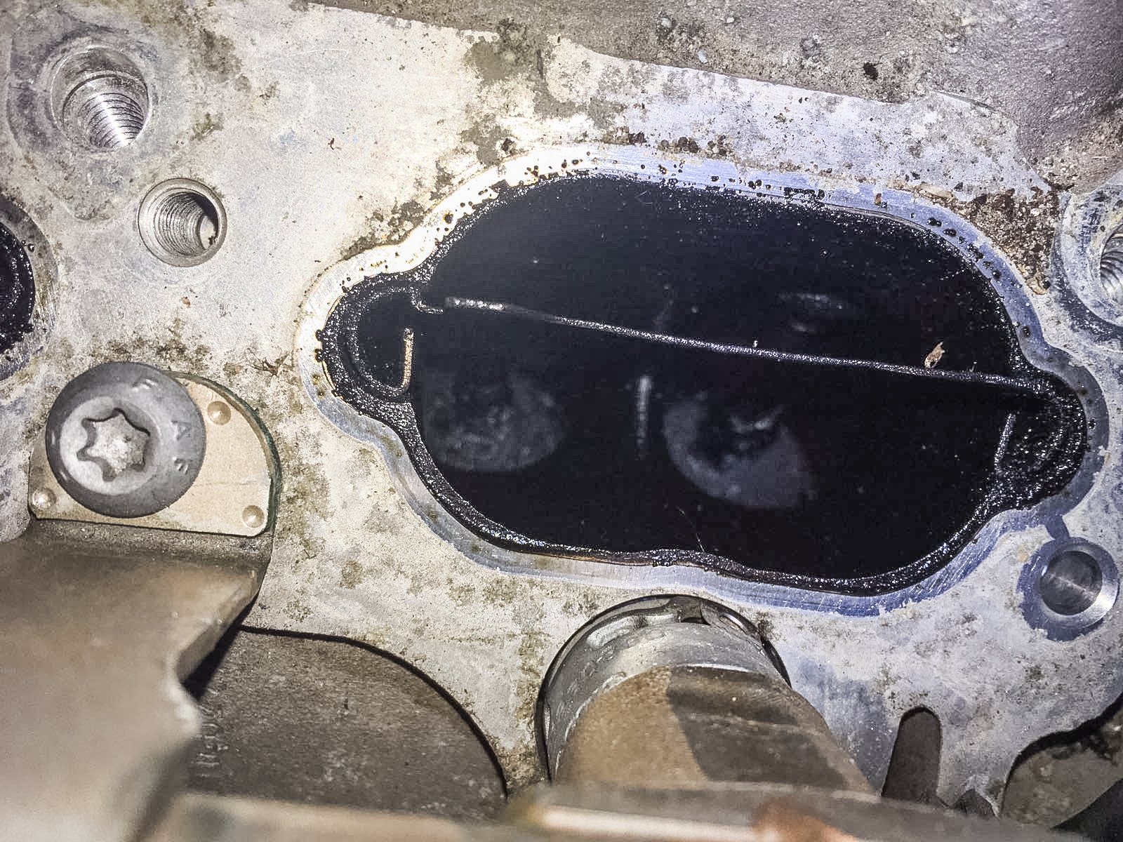

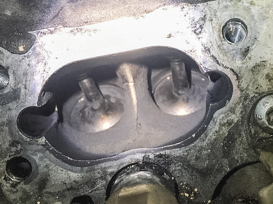

Andy said it was not too bad but I figured that from the dyno before hand.

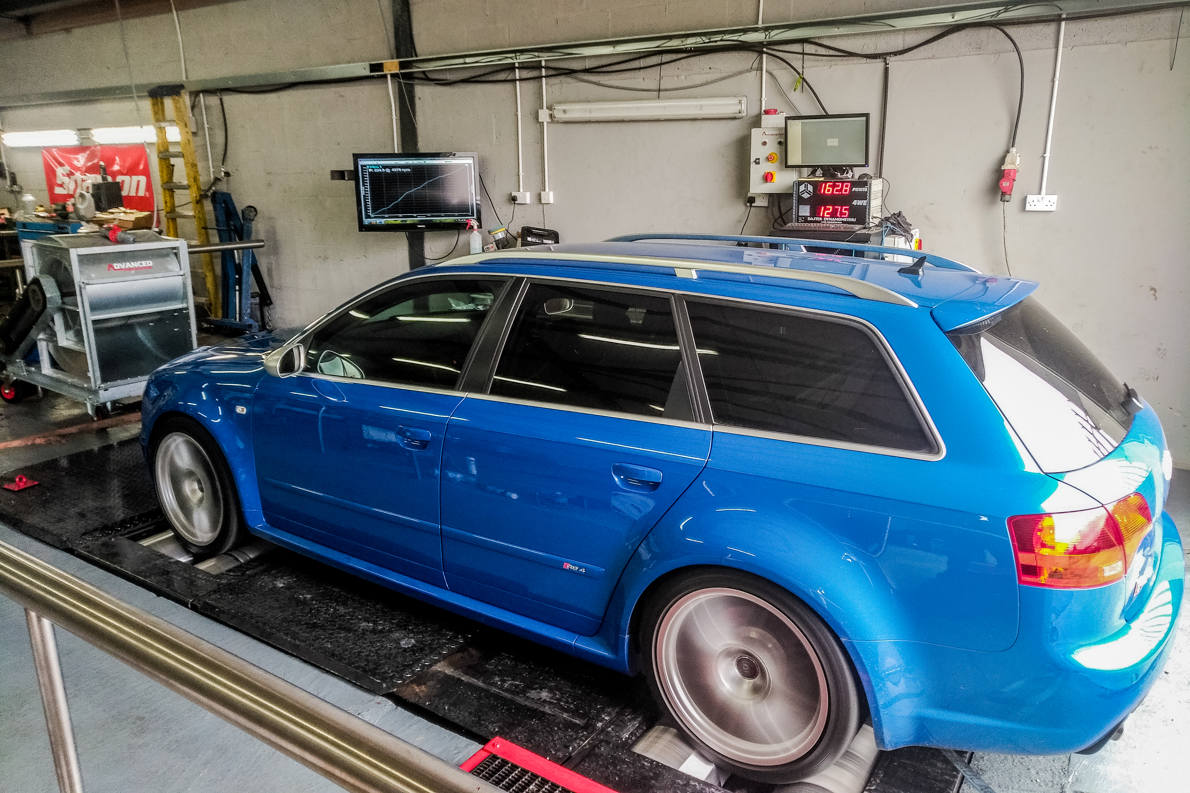

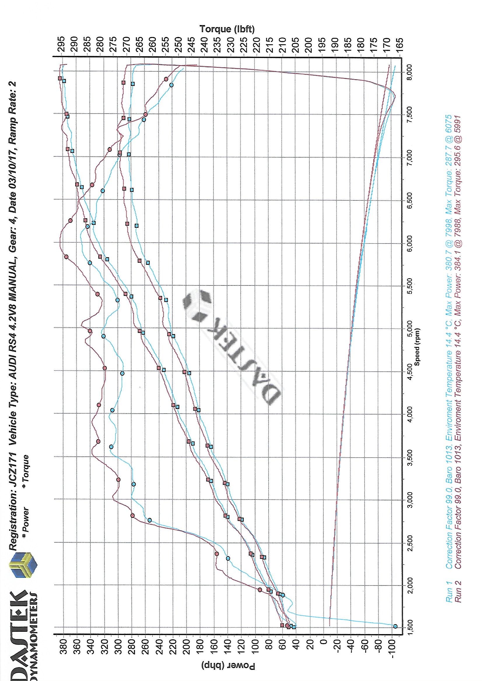

So back up the road to Autotune for the results.
After carbon clean she made 384.1bhp. Ryan said that if we had shell v power or 98ron over here you could add 5-6 bhp to all figures.
hector8
Posts: 193
Joined: Wed Mar 25, 2015 5:50 pm
Location: Co Down
Re: Carbon clean and map (Before and After Northern Ireland)
Post by hector8 » Tue Oct 03, 2017 3:49 pm
Was pretty chuffed with the results. The car is totally standard so anywhere between 380 and 390 to me is a clean good going RS4.
Ryan then custom mapped it and managed to get another 13bhp on top and the gearing is splendid to drive. Pulls through them all with ease
396.6bhp
May not sound like a lot, but the drive home was like night and day. Especially at 5500rpm. I have over 40bhp difference at this point in 3rd and 4th gears.
So to sum up.
Pre carbon clean - 367.6bhp
Cleaned - 384.1bhp
Mapped - 396.6bhp

Andy who done the carbon clean took videos with pen lights of every valve before and after. That is where you can really see the difference.
