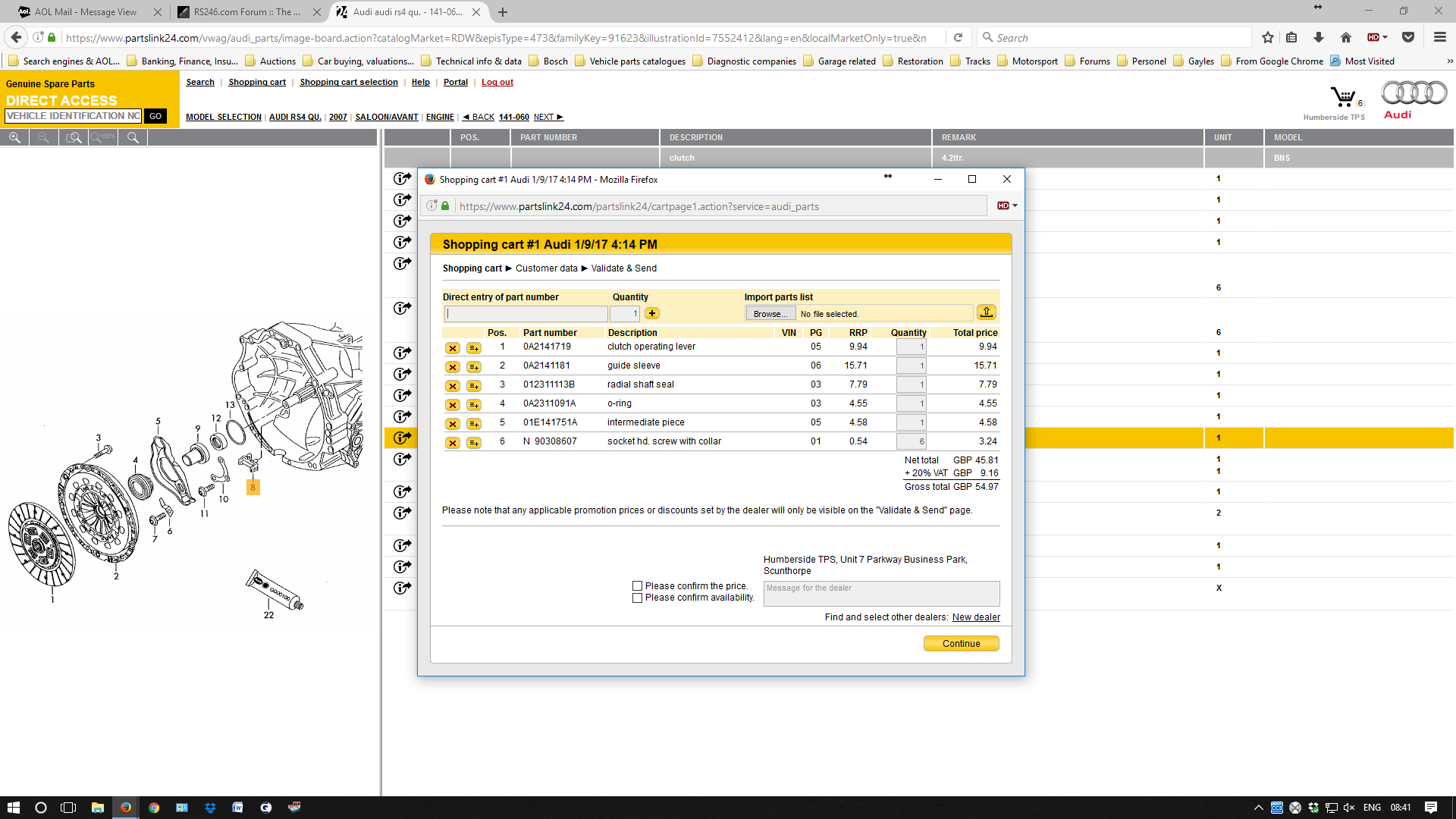

Change these parts:

Would also suggest speaking to Robnic on here and getting the updated metal braided clutch pipe.
