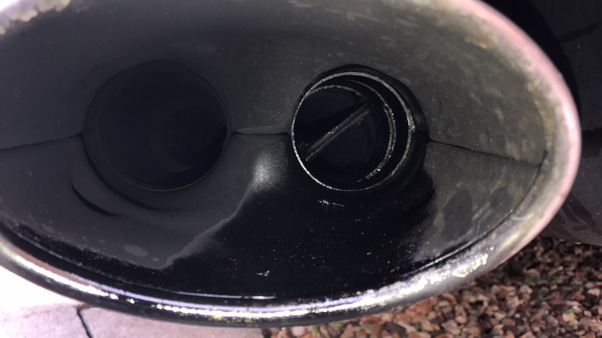

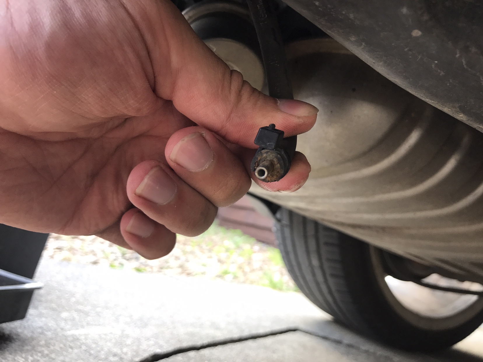

My OEM exhaust valve was closed when the car was off! I opened by my self because it was always closed! So now open but When I switch on the car flaps still open! It is possible that the issue is the vacuum? If yes what can be cause? Flaps
always open now! Tried to disconnect the vacuum pipe and it was look like this: so i connected back!

They will close under no vacuum normally (engine off). If your engine was off and the valves were open then they are stuck. You have now opened them manually and now they are stuck open. You may not have a vacuum problem. More likely the valves are stuck. You might be able to free them off.
