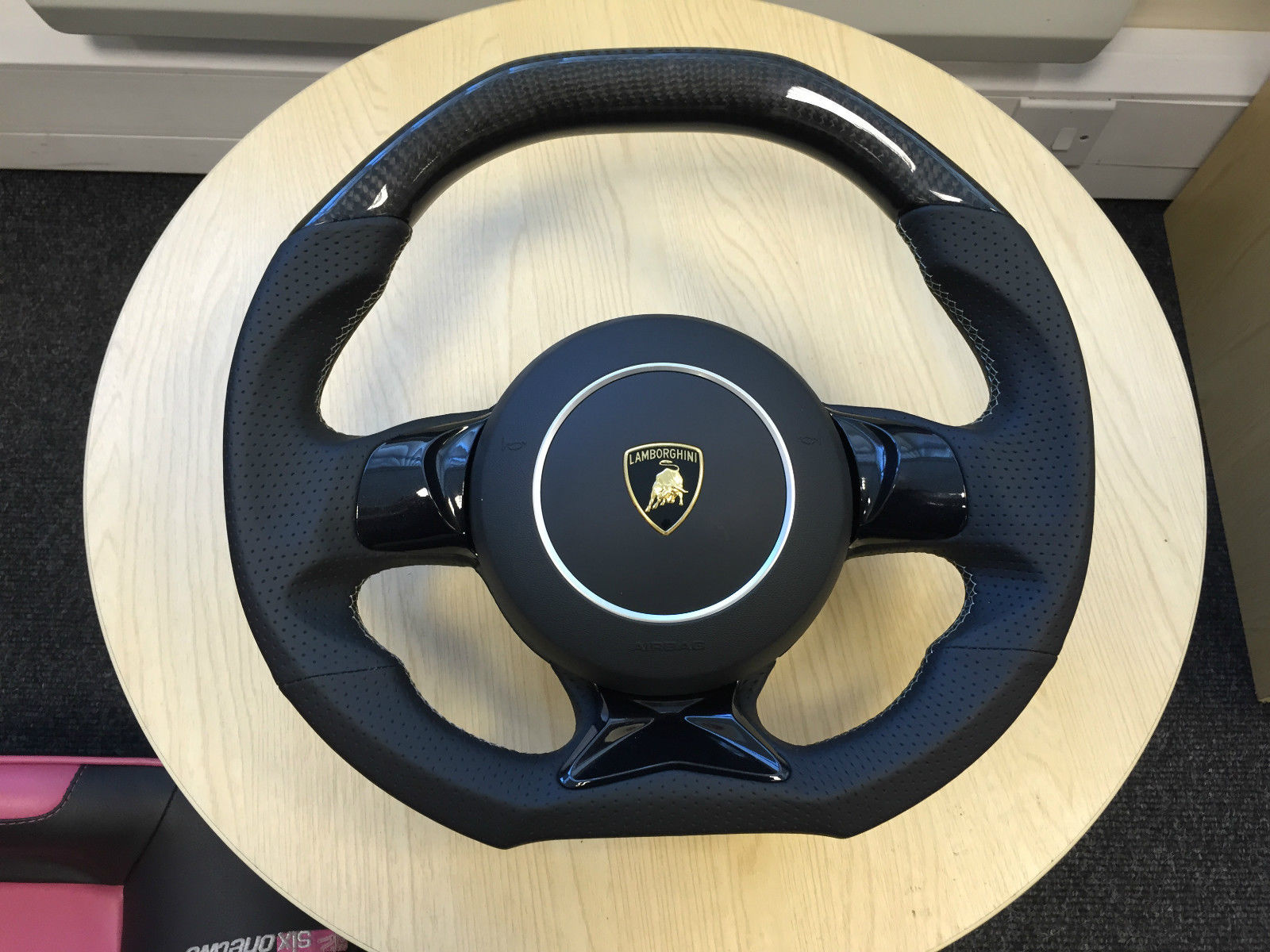

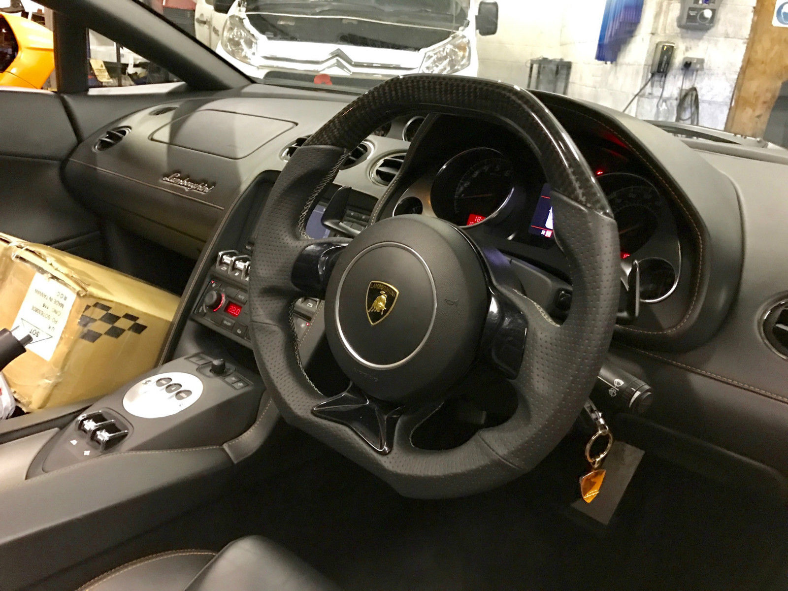

Is the R8 wheel any thicker that the RS4? Why do people switch to the TT/R8 wheels?
I would personally go for a Lambo wheel. I was looking at them a while ago, get MRC to map the car in permanent sport mode and away you go....... They would look really cool in an RS4 and in the price range of the above. Just switch the air bag over or sell it to help pay for it.

jonytek wrote:
Thu May 25, 2017 5:14 pm
TT-RS and 'late' Gen 1 R8 wheels are the same thickness as the RS4.
It's the early R8, TT-S and S-line wheels which are thinner, hence trying to find the above 2. I guess that you could always get a thinner one re-trimmed to be thicker.
