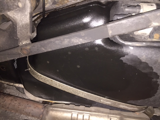

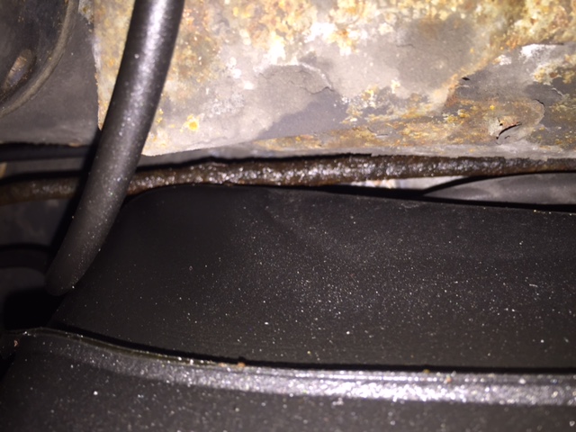

My DRC has just gone pop for the 3rd time. Seems that the underside of the car has a lot of corrosion and one the pipes that go over the fuel tank has given up. I'm waiting on a price to come back from the local specialist as I've asked them to do both pipes on the basis that a second pipe now is going to be cheaper than doing the whole thing again in a couple of years.
It's going to be an expensive December as it's in for a service, a replacement drivers door lock mechanism ( only opens with the key ), temp gauge and warning speaker repair which is a cluster out job and off to a specialist, and finally the DRC work. Oh and it's Christmas.
Got some pictures just come through of the pipes

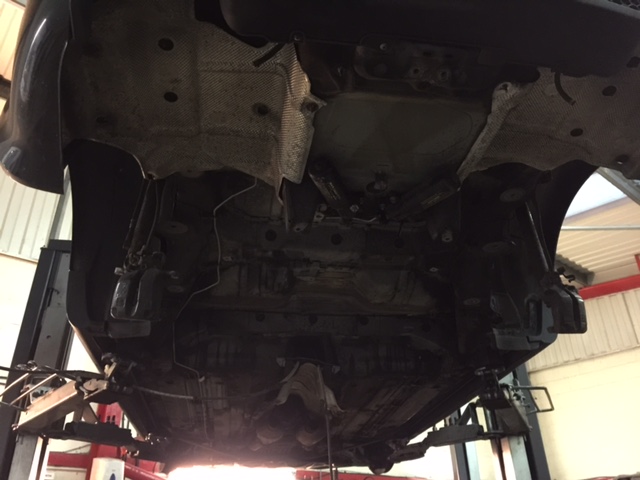

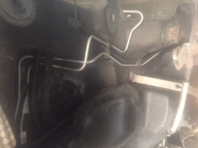

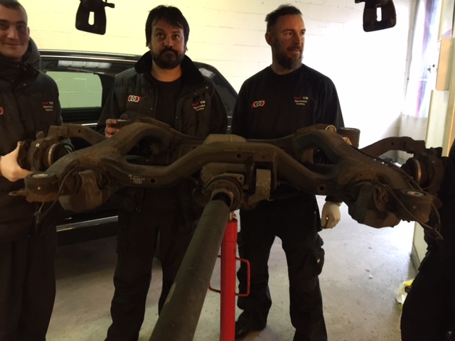

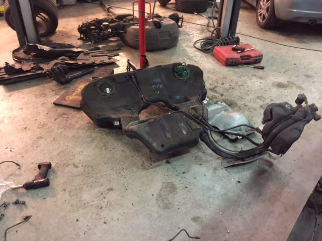

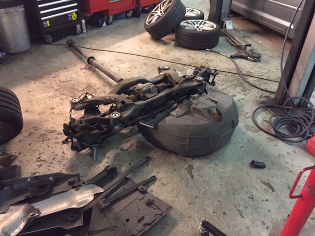

I've just got my car back from the specialist. Seems that there was a lot of corrosion on not only the pipes that run front to back but also the ones up above the fuel tank. It's a massive job to do, pretty much the entire rear of the car had to come off. They even took a few pictures to show how much of a mammoth task it was
Also, had a service, drivers door lock assembly replaced and instrument cluster repaired so that's me out of cash for a while, which is a shame as I wanted to get the alloys done by Pristine just after Christmas.

Wow big job. I'd get all the bits steam cleaned before re-attaching.
