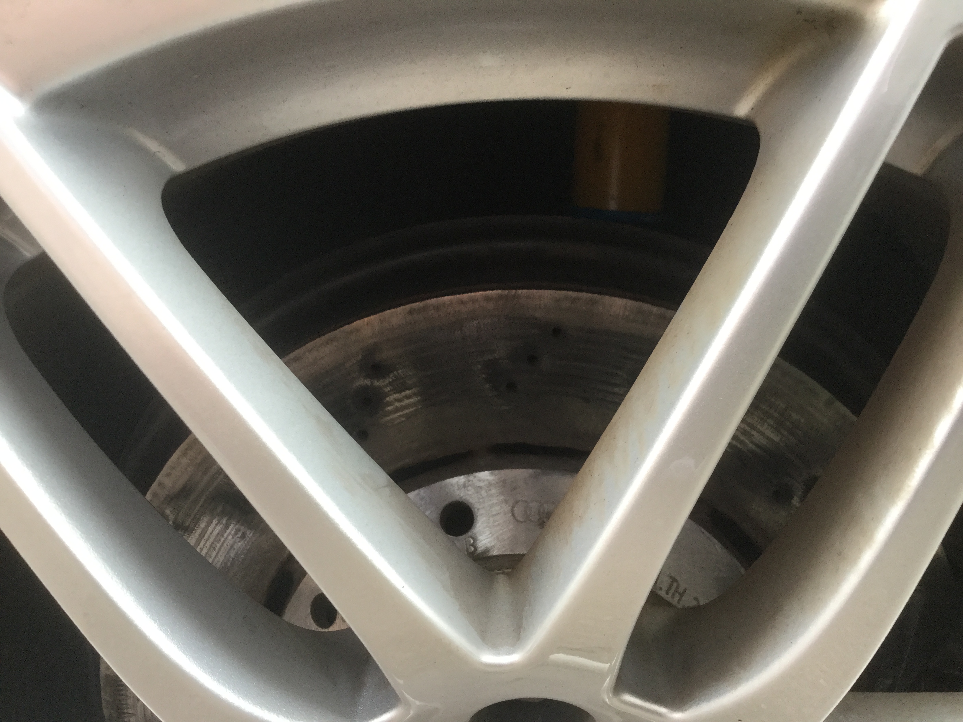

I just got the rs4 mot'd and the rear brakes were a corrosion advisory, i just removed both today, cleaned them up and refitted them. Pads still have plenty of life and the discs are at 21mm.
I took her for a spirited drive and then had a look, rear discs have barely been rubbed, front discs are like mirrors as youd expect.
I know the fronts do most of the work but i feel the rears are doing next to nothing, any advice? Can i change the bias?

you dont want to change the bias-the rs4 has huge rear brakes compared to most cars-they dont do much work by design
if you alter the bias the rear might step out at speed under braking or mess with the abs/traction etc
i dont use my car much though and the rear brakes do look similar to my fronts,but when i do use it i make sure and go heavy on the brakes to remove deposits/surface corrosion etc

My brakes look similar to your Rico. I think they're past skimming etc so I'm just going for new discs and pads.
