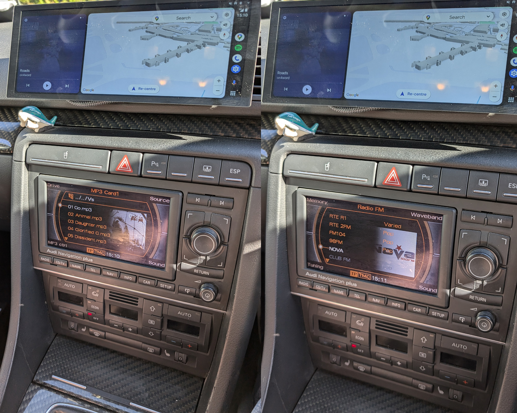

Hi all. Tried searching to see what the latest thread is on this topic of RNS-E and SD cards and this one wins.
I've had the first generation ("192") RNS-E in my B7 since I got it, the one with the CD/TV button, and only just today after 14 years of owning it have discovered https://rnse.pcbbc.co.uk/
This is still getting developed and updated in 2024 and I think for the price he's charging (15 GBP) it is utterly amazing what he has done, especially for the Gen1 units.
Disclaimer: I am in no way associated with the developer, I'm not sponsored by this or anything like that, I'm not getting paid to post this. I literally went down a google/forum rabbit hole today trying to get stuff going for my raspberry pi Android Auto project and found this on an Audi TT forum where they just love messing with RNS-E units.
So yeah today I stumbled across this software, managed to get it loaded onto the head unit, and now I have:
- full support for 32gig SDHC cards in both slots (I'm even running microSD cards inside an adapter perfectly)
- radio station logos on all Irish/UK radio stations
- huge improvement in mp3 capacity and artwork displaying for every album
- scrolling song titles on the DIS

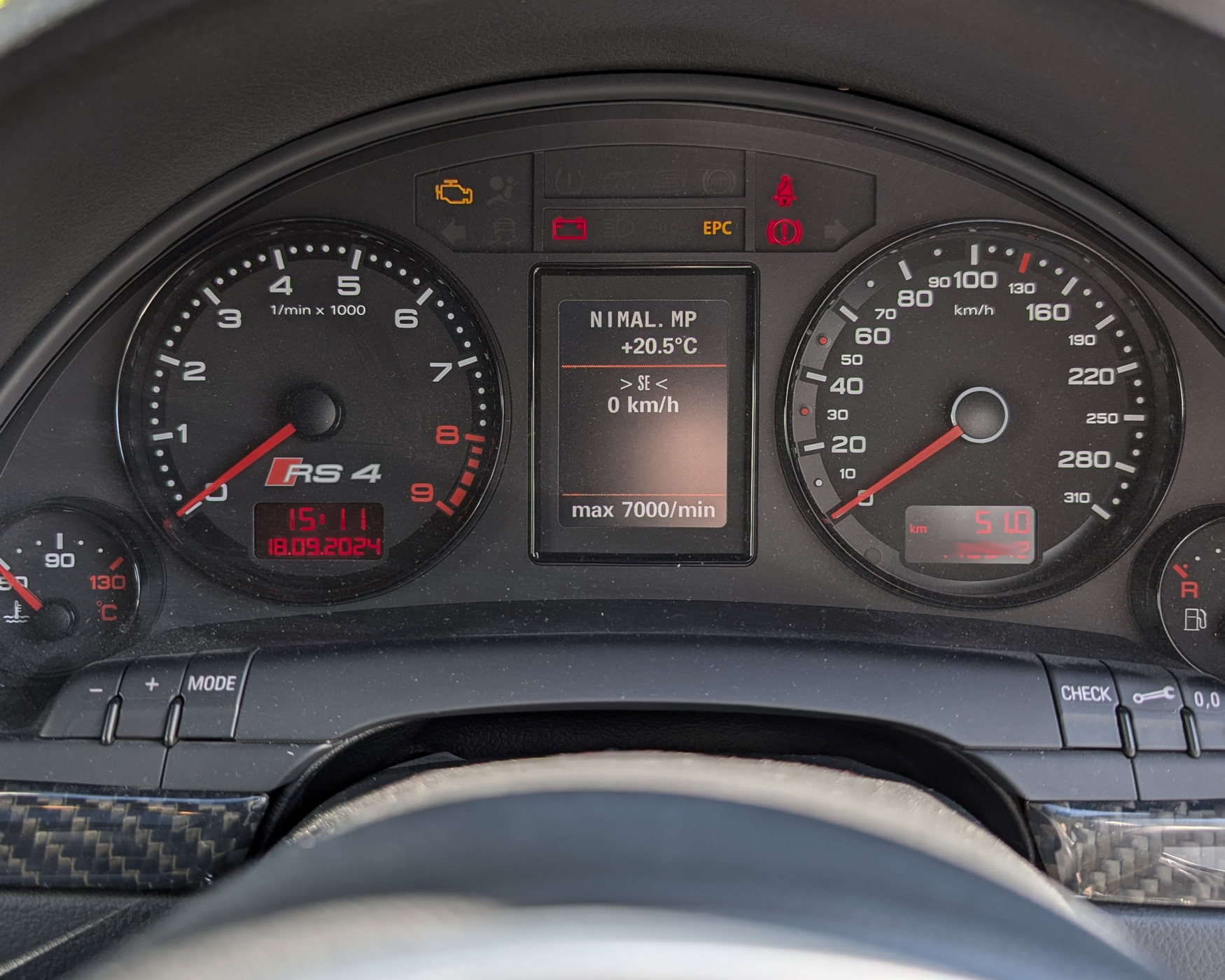

- digital speedo displaying on DIS below the compass
- 2020 maps running off the sd card - no disc needed
I think this is absolutely unreal that someone has developed this so well. The guides on the website are top notch and everything just.... works. So rare these days. There's even a free utility that will scan your SD card and apply all the artwork file conversion properly.
Hardest part of it all was finding a CD-R to burn to get the firmware updated loaded onto the head unit! Had to dig out an old dusty computer with a burner drive in it and find a burnable CD. At least a decade since I've tackled that. The guide on website says to use CD-R and not DVD-R but I'll come clean and admit I didn't have any CD-R/RW lying around and chanced it with a DVD-R and it did work.
Maybe I'm very late to the party and everybody knows about this but for those that don't I'm putting this up here. Absolutely worth the afternoon of tinkering to get it going. It has breathed new life in my very dated RNS-E unit and I'm chuffed.

Excellent find! TYZyox wrote: ↑Wed Sep 18, 2024 3:05 pm... have discovered https://rnse.pcbbc.co.uk/
