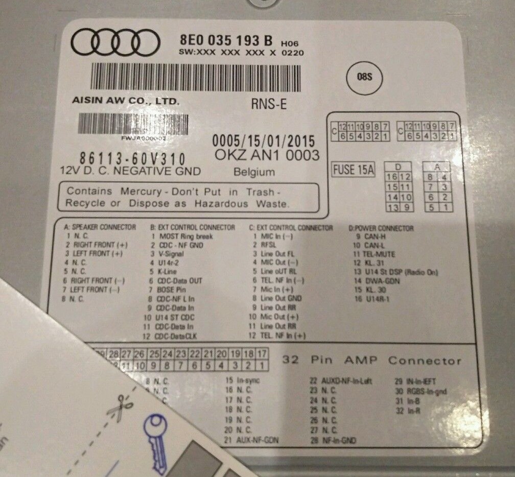

Thanks to those who had offered up an rnse.
Managed to get hold of an apparent 8E0 035 193 B, which seems bizarre, given the 8E0 prefix. Will soon find out - once I plug it into VCDS what it comes back with. The double din cage, climate control and kufatec adapter also en route.

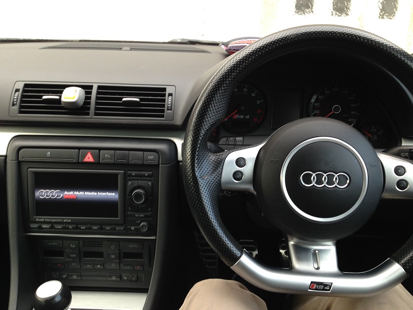

Post by mongo » Sun Jan 31, 2016 3:36 pm
All fitted early birthday! Looks much better. All coded to the car, the firmware has SDS so im currently getting a mic error, but will see if i retrofit bluetooth and ami to hook this up as well.
