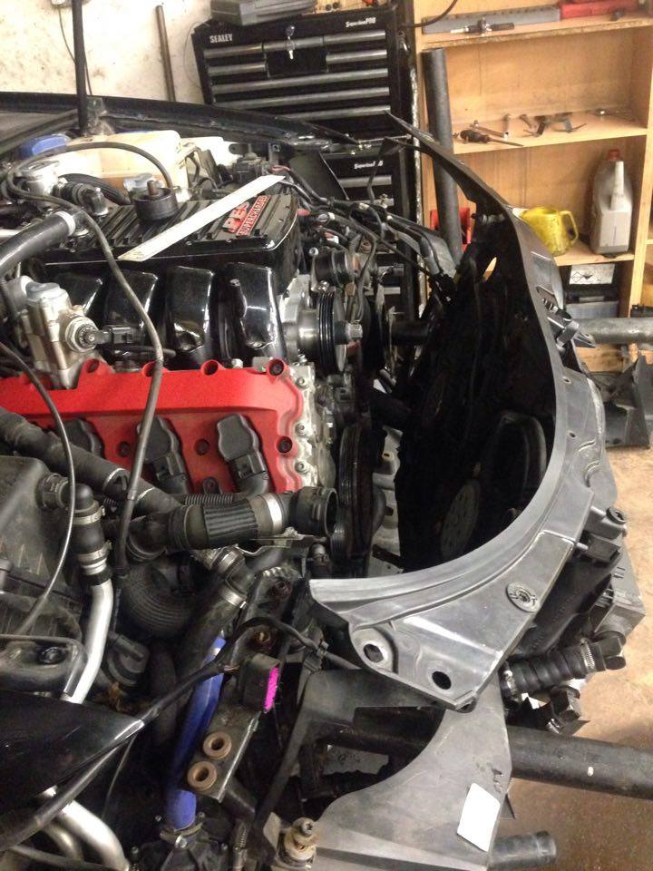

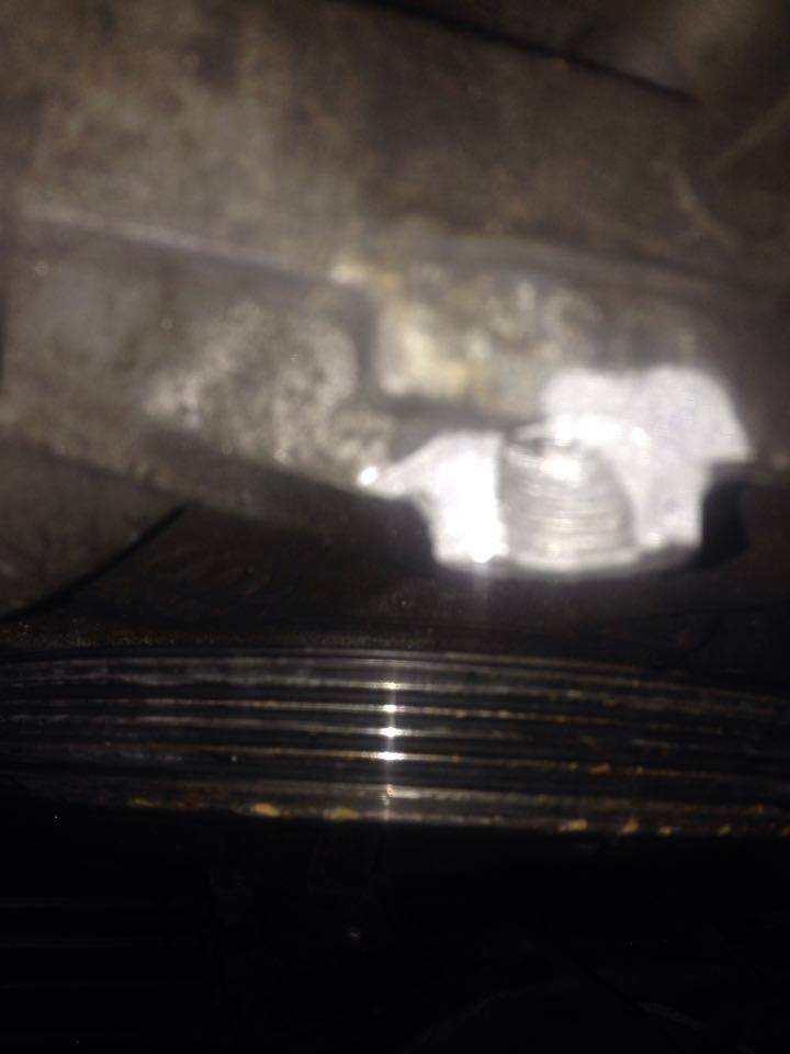

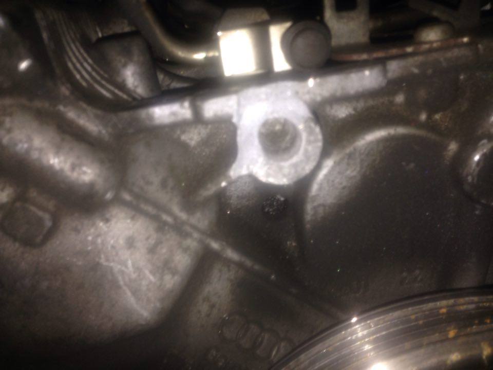

well not really any pics of it as you can barely make out where its is , but its in at my pals machinist/ engine repair workshop ,getting the whole front off for access to get the repair done , , i think the reason for the failure was the securing bolt came loose which allowed the pulley to move a bit which stressed the bearing too much which overheated it and the bearing race cage failed which caused the inner race to shoot sideways and jam in the outer race which stopped the idler pulley and the belt then jolted the pulley and snapped the piece off the block , thats the theory anyway , but a new design has been devised ..after much research and discussion with SKF bearings they had a suggestion ..
2 bearings of a different spec will be fitted to a custom machined hub my pal will do on his hub which will half the load on the bearings as they will spin at near 20 000 rpm due to pulley size /engine rpm , so a plan is afoot for that , the original bearing was a normal spec deep groove single race bearing , the new paired bearings will be better sealed , higher temp rated grease and a higher tolerance to allow for expansion
the original billet anodised pulley will be machined out and pressed onto the new bearing hub for correct alignment so the whole assembly should be good for the forseeable future
EDIT , couple of pics from today , not the best quality , the phone doesnt take close ups it seems lol , not my pics as i,m offshore just now , more to follow hopefully better focus :roll:

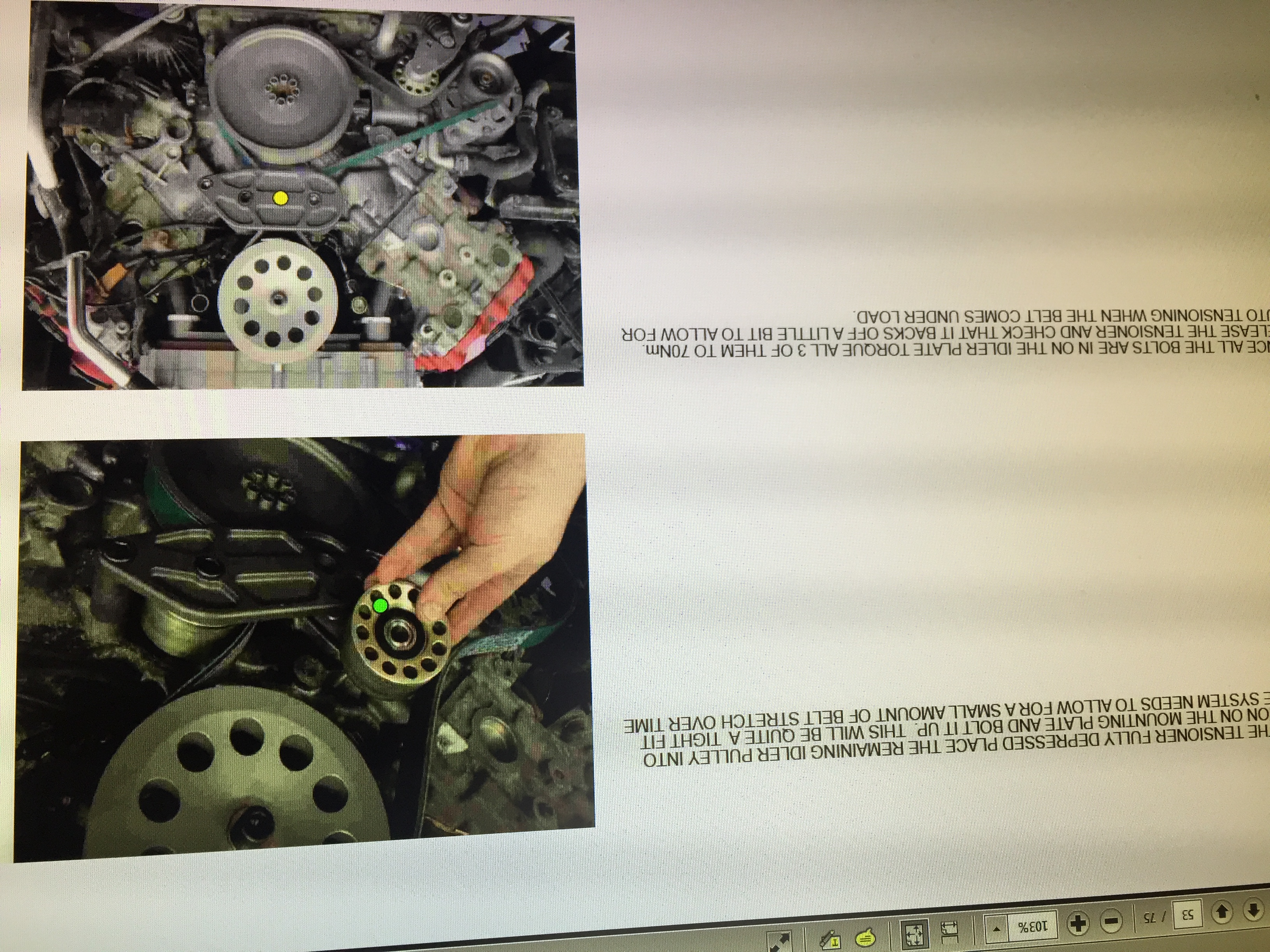

Hi mate,
Had a chance to look through my pulley set up this morning, thought you might find this interesting
TTS do not use the standard idle pulley mounting point probably for fear of what's happened to yours, so they have a better system buy mounting a seperate plate
I have photographed this from my info
R

looks like a better idea for sure , bearings look about the same size as mine , , i,ll see how this progresses , maybe TTS could supply this for me the belt is wider than mine , but dont see it being an issue , but the left hand bolt as you look at looks like it is mounted into bolt hole which has broken on mine so not ideal for the plan, depends on what they get done to it also the TTS has a different pulley on the tensioner and the idler is removed , quite different really .

Yes the belt has been upgraded to an 8 rib versus Audi 6 rib, the engine pulley is lightened and balanced
The idler is still there it's under the plate with the yellow dot
Like you say, see how they get on with the plan, and it gets resolved mate
Just gives you a different idea going forward
Richard at TTS is a good guy, and very knowledgeable with our cars
