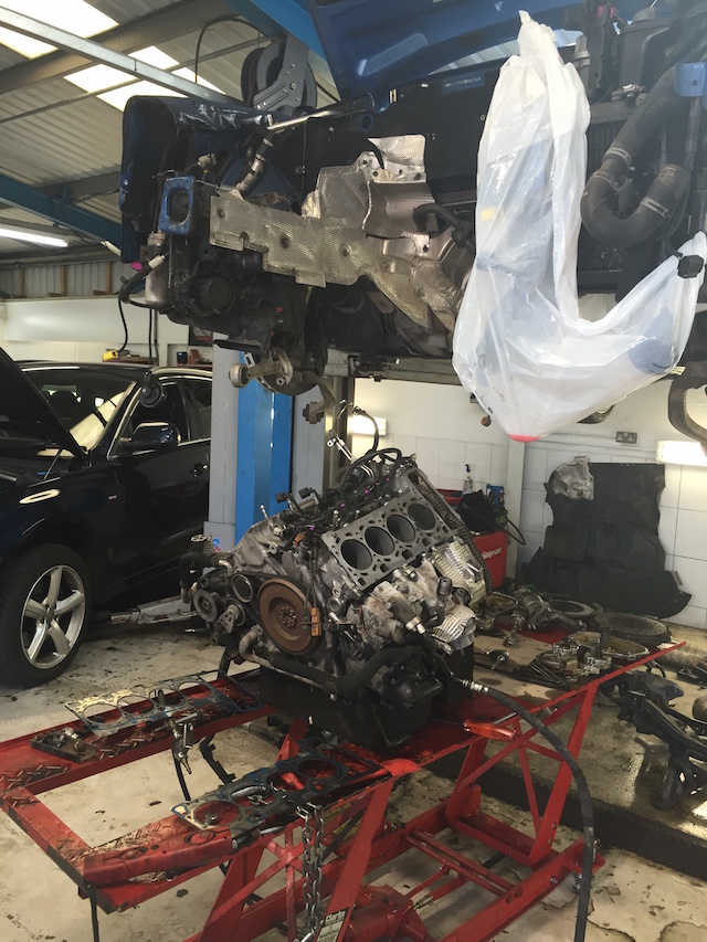

Just wanted give a shout out to A4Audi in Clydebank.
I've just had my car in to get the timing chains done. Andy the manager there was spot on, his knowledge and customer service was second to none. I would highly recommend them if you were looking to have any work carried out on your car.
I had a full timing chain kit fitted with all Tensioners and guides, new clutch and front brake service with new pads. Kept me up to speed with the progress of the job and also sent me some pictures throughout the job. First class service. :bowdown:

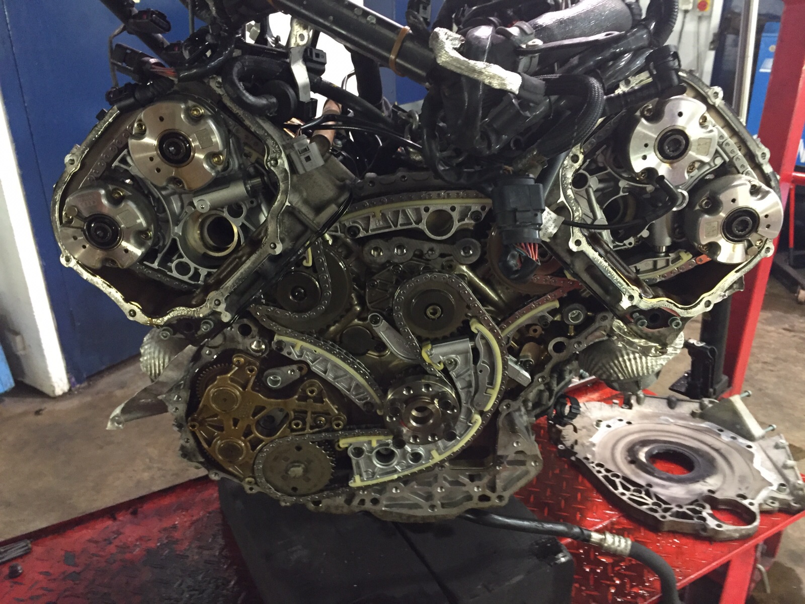

75 thou
The oil cooler burst causing the chain to jump a tooth, so it had to be done. :thumbsdown:

Baz4 wrote:Sorry to hear your having trouble with the rs. Excuse my ignorance but how does the oil cooler suddenly blowing cause the timing chain to jump a tooth? I'm not dubious just panicking a little as its a job I've considered doing but thought I'd wait till the pipes look completely shot. Now I'm thinking it might be worth doing it just for peace of mind.
Hi Baz4
The timing chain has hydraulic oil Tensioners 4 off so when the oil cooler burst the engine lost oil pressure causing the Tensioners to relax and allow the chain to go slack jumping a tooth. A4Audi did a superb job sorting it out. :thumbs:

By the power of grayskull!!
Thats organised chaos going on under those chain covers..... i cant 'unsee' it now... :-)
Glad youre all sorted.
