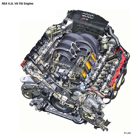

Post by audi_do_dat_den » Thu Nov 05, 2015 6:53 am
As moondog says, im certain there is only one engine type from 2006 to 2008.
The pic shows the pulley setup on these engines.
If there was an idler missing, the belt may be running too loose and eventually glaze up and fail.

Re: My car is eating alternator belts!!
Post by Ellis » Thu Nov 05, 2015 9:41 am
Yup looks like pulley arrangement is the same on both variants...
