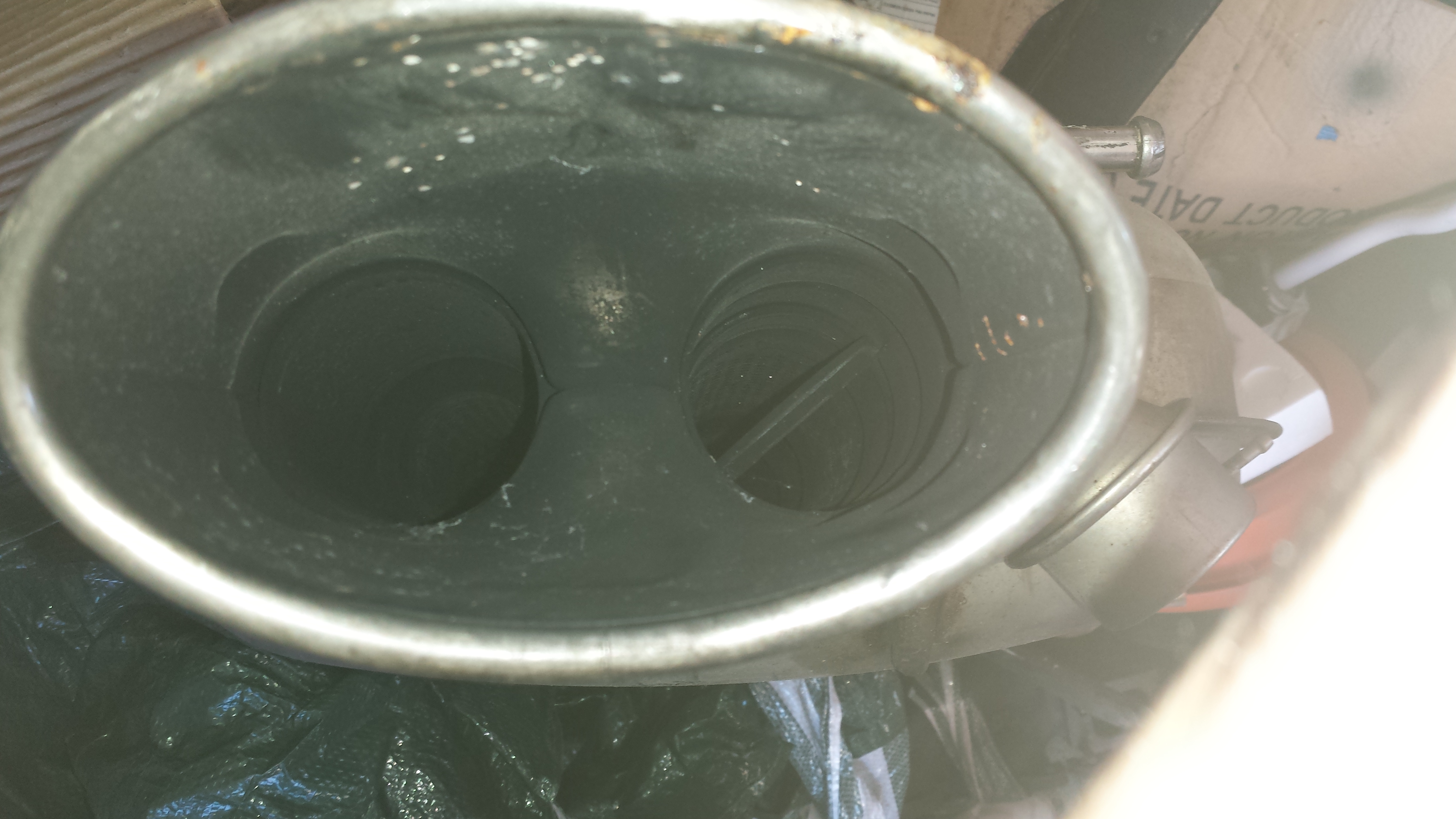

[attachment=0]
The valve without vacuum will be open, they open by the bottom half as its sat on the car swinging into the exhaust. Note the orientation of the flap isnt horizontal, it rotates at 20:10 for passenger side and 22:20 for drivers. So to move a seized item, gently tap 20:25 passengers and 22:35 driver side. Once moving you will need to lever the flap back and try again untill moving freely. Use plenty of penetrating oil. Might be easy to pop off the vac lines as they will be helping to hold um closed.

Hi guys
The RHS valve was open
The LHS valve was closed, I manged to get this open with wd40 and forcing the valve open (it won't shut though it's stick open)
But it still sounds the same?
