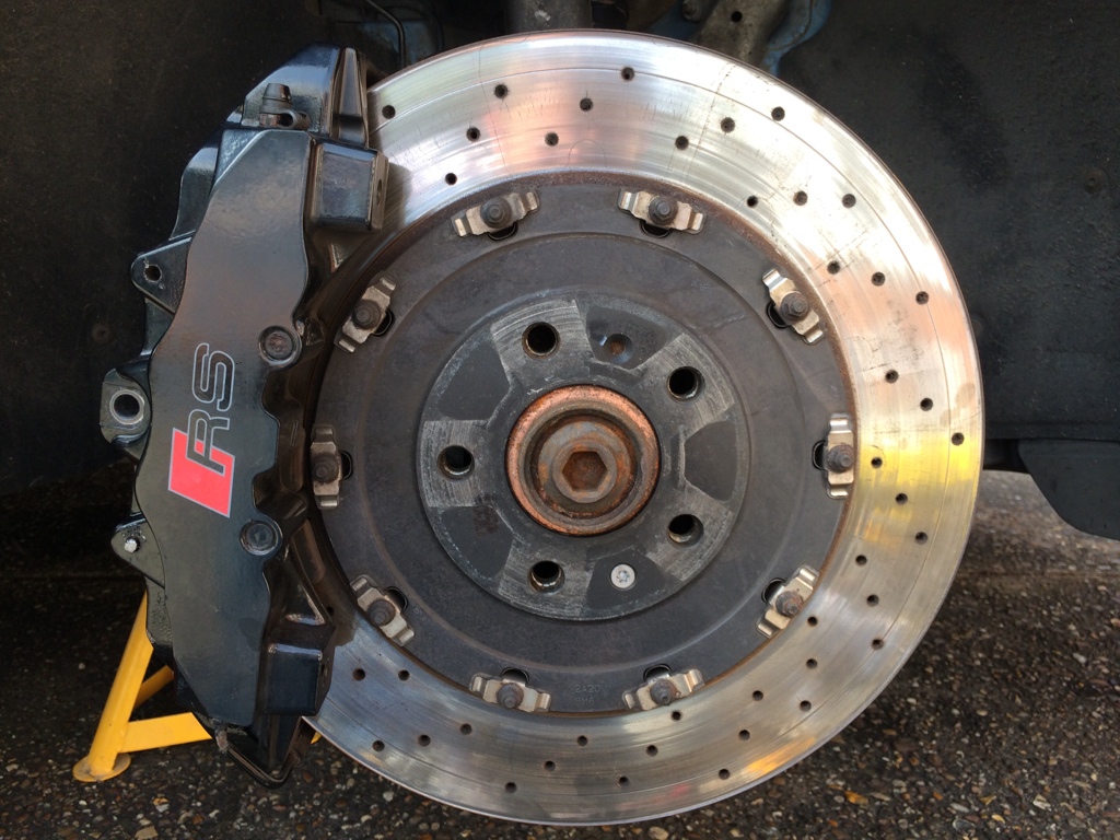

I've took my brakes apart to try and find out why they've scored. The pads are trw(has anyone heard of these?) and I know they were replaced at the same time as the discs so I'm wondering if they're aftermarket also? I can't see any markings suggesting that they are Audi on them. Cheers in advance

They look OEM to me. Same hole pattern - that's all I'm going on. Mine used to get grooves in them as well when they'd done a lot of miles. I don't think that's a worry. You should probably measure the disc thickness though, see if they need replacing.

TRW are one of those companies that make OEM stuff for VW/audi.
I don't think the discs have any VW/Audi markings on them, certainly not on the front, but not had mine off to look behind.
Mine have worn the same as yours, just running them till pads wear out and replace both

Audi discs have the 4 ring stamp, part number and min thickness stamped onto the outer face leading edge where the air feeds into the vanes.
Audi pads are made by Pagid to their own spec and that same specification is not available from directly from Pagid themselves or via a third party. TRW are not an RS4 OEM product, they don't perform as well and have ruined your discs by the look of it. General forum opinion for a good pad are genuine Audi items or Ferodo Premier as recommended by MRC.

Thanks guys. Just off for a vernier to check the size of the discs. The pads are due replacement anyway as there's only 3-4mm left on them. I can't imagine they are oem as they have no pad sensors on them.

Surrey Sam wrote:If your vernier gauge is unable to get the correct thickness due to the lip, then you could put a couple of coins onto the disc faces and gain a measurement that includes them. Once done measure the coins to subtract that figure from the total measurement to get the actual disc thickness. :thumbs:
Good tip, thanks. Theyre Audi OEM and are 33.6 mm so plenty of life left in them despite the amount of rust........as long as the cracks dont get any worse. Time to hide the iron X!!

By the way, just looking at your pic. You have the same 8 pot calipers as me but mine have a bar going across the bottom, you can see where it would bolt on in your pic. Anybody know if it's ok to remove? It would make it a lot easier to clean.

This is the main brace bar between the 2 calliper bodies and I'm hoping gt2 has temporarily removed this in an effort to get the pads out which is why it isn't in the picture?...
Yep :thumbs:
