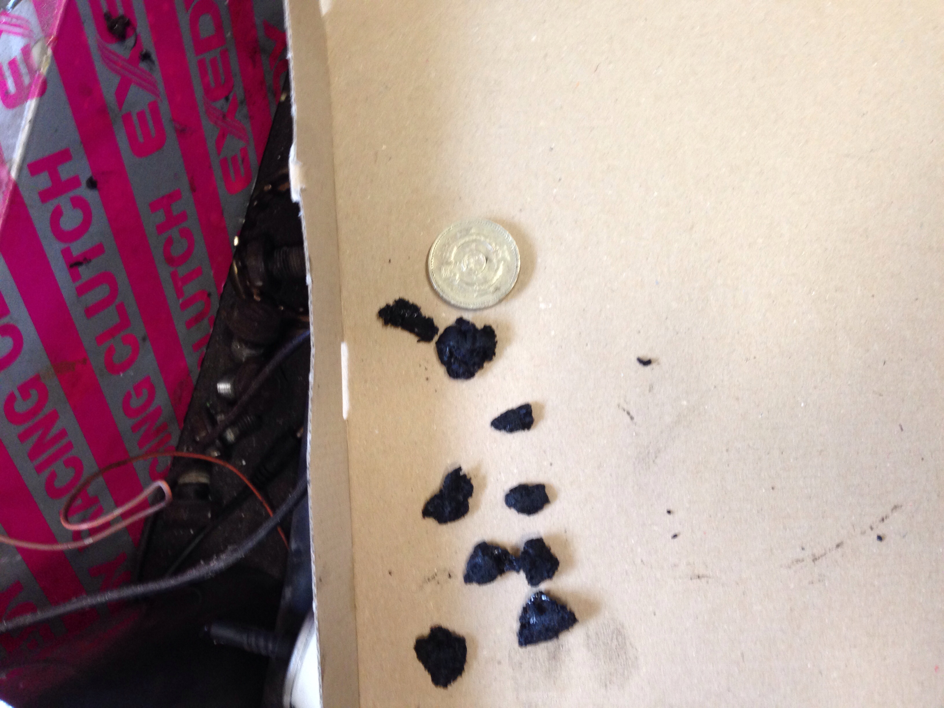

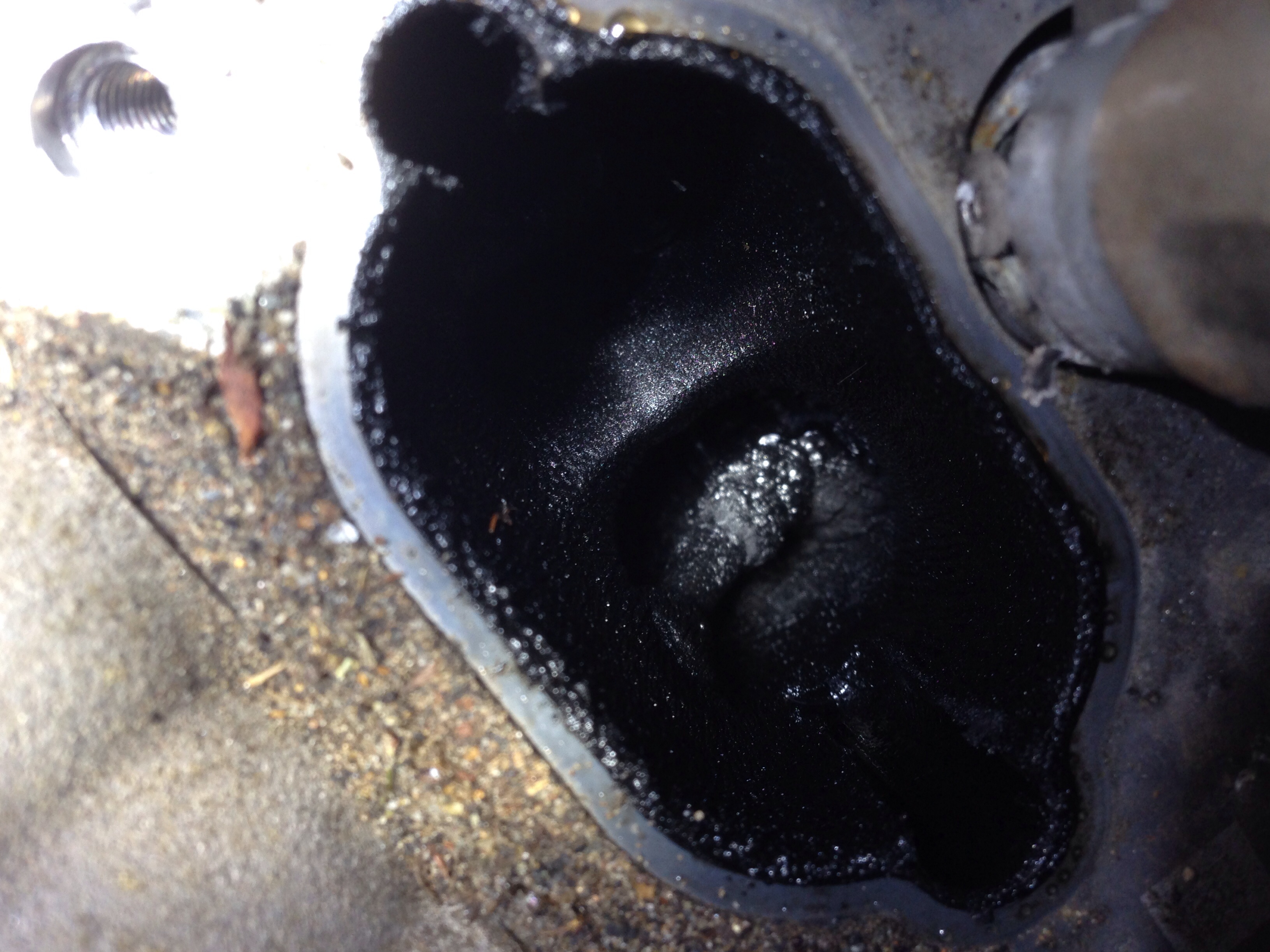

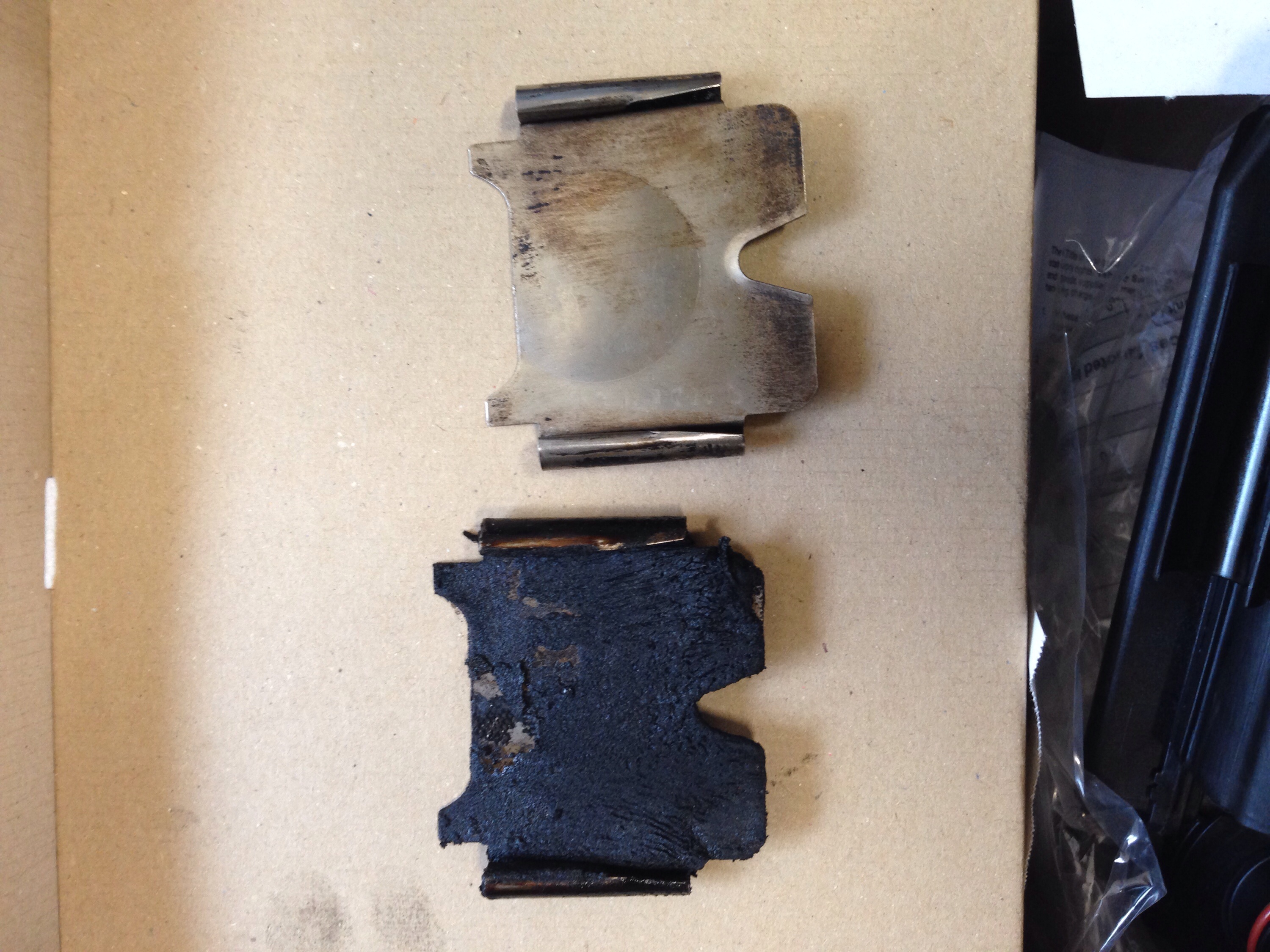

Car is in with my local mechanic getting carbon cleaned while I am away on holiday, he sent through some pictures that I thought I would share. I logged runs before I dropped it in, they showed low airflow and ignition retardation. Will log again once I get back.

That looks bad! What's the mileage?

Apparently the car goes a lot better now, I am picking it up on Saturday and will log a few runs for comparison purposes. This will be part of the service schedule from now on. The mechanic likened the restriction the carbon was causing to blocking off half the intake...

You only need to remove the inlet manifold. It’s not that hard, just a few bolts at the back that are a bit fiddly and require a small ratchet tool. Also check the vac lines and one way valve under the manifold for any damage/leaks. Having a vac leak will rob you of a lot more power then carbon build up.
There are few good DIY write ups around.
If it’s your first time allow a day and a half to remove, manually clean and refit. If you use a homemade walnut blaster it should be quicker.
I think spending one weekend every year doing a carbon clean is bugger all, even then depending on how many miles you do that may be overkill.
