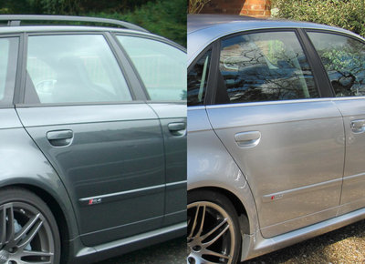

Might be a stupid question but are rs4 estate Rear doors the same as saloons some twats dented mine right on the crease and have managed to source a door off a estate in same colour please help as meant to be collecting weekend
Re: Rs4 saloon rear doors
Post by MikeFish » Mon Jun 23, 2014 11:20 pm
Littlerick wrote:Might be a stupid question but are rs4 estate Rear doors the same as saloons some twats dented mine right on the crease and have managed to source a door off a estate in same colour please help as meant to be collecting weekend
Without looking at a picture I'd imagine the top of the door is different as the roofline on an avant keeps going but on a saloon it drops. The B8 is definitely different, I'd imagine this would apply to the B7 too.
Post by MartayMcFly » Mon Jun 23, 2014 11:35 pm
Yes, they're very different unfortunately.

Post by sar » Tue Jun 24, 2014 9:26 am
the doors are the same, its just the top frame that is different, but this can be swapped easy enough.

I had a new rear door due to an altercation with a deer recently - the door is all metal...
The saloon door and Avant door are the same - as sar mentions it's the top that's the difference but one can easily switch with existing door ancillaries.
New rear door from Audi (unpainted) is £446...
