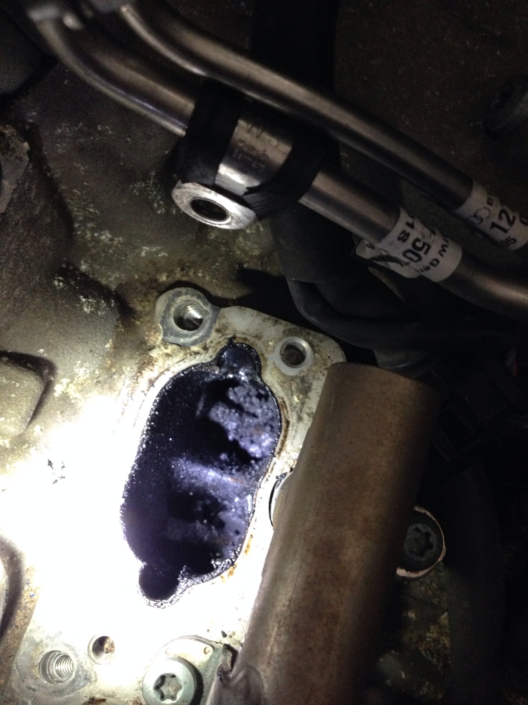

I did with a friend and we split it over two days so in total took around 14 hrs 2 hrs of which were spent trying to undo one bolt behind the inlets under where the throttle housing sits had to make a tool in the end to take it off and the actual cleaning the inlets took ages as it was really really bad here is a pic
