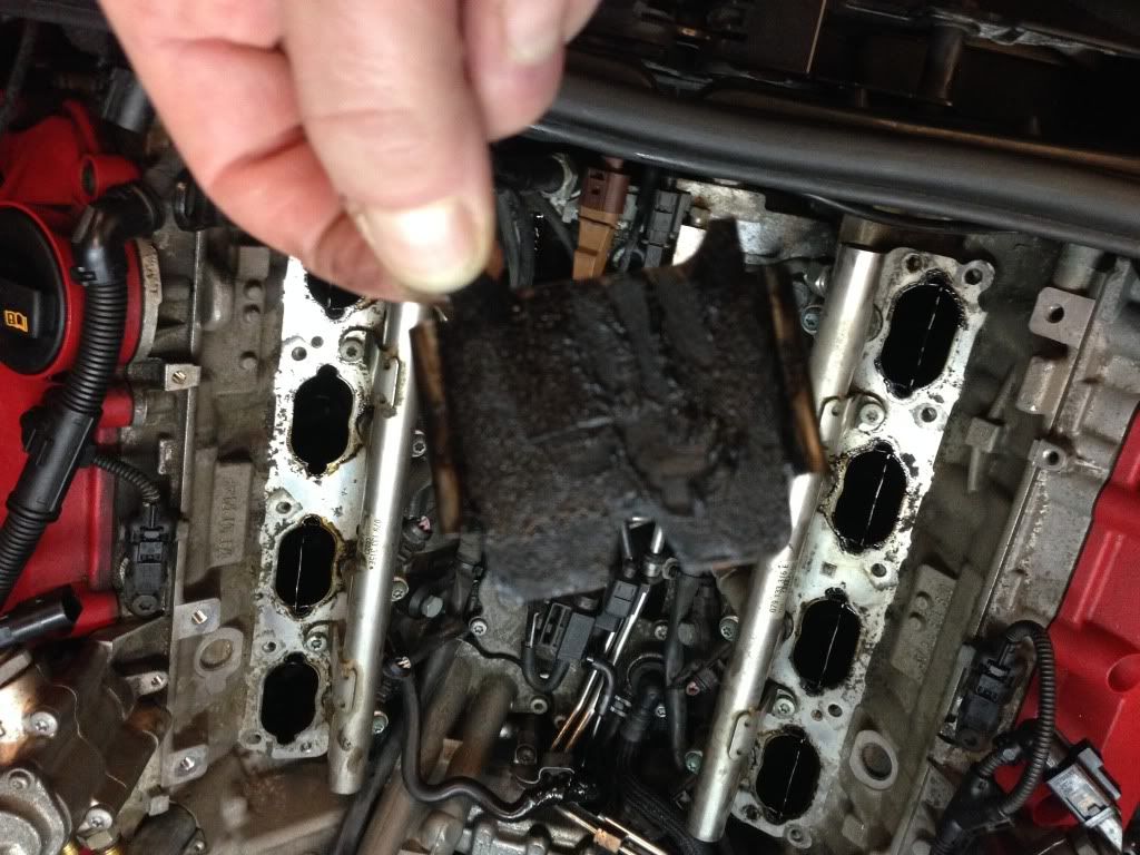

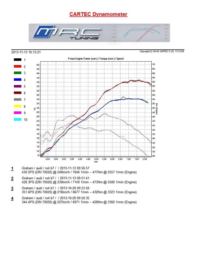

Here are some pics of my carbon clean - sorry I don't have any after shots on me at the moment but this is 90k's worth of build up. And I can say the engine feels a lot smoother and alive since having it done. Power was up from 340ish to 430ish along with the stage 2 map (no vac leaks). I can confirm the car now feels like I always hoped it would, it's amazing how you don't realise how down on power you are unless you have a go in another healthy car to compare. Thanks to Silas and Noyjatat for that!

Mine went in for the old carbon clean about a year ago, MRC said that it was 'fairly bad' in there but the car was still showing about 370 on the rollers from memory... I had it cleaned, de-flapped, and stage 2 mapped with a resulting 425 on the rollers. To be honest, I would say that the increase in performance (from the seat of the pants test - nothing scientific) is not really noticeable... however, the noticeable difference was how smooth the engine ran after and it pulled much smoother through the range.

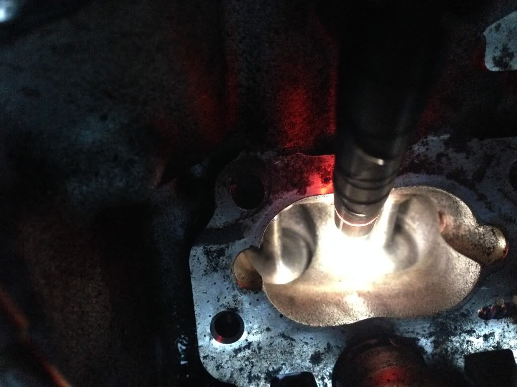

I could notice the difference at 5 and a half k....ImageImageImage
