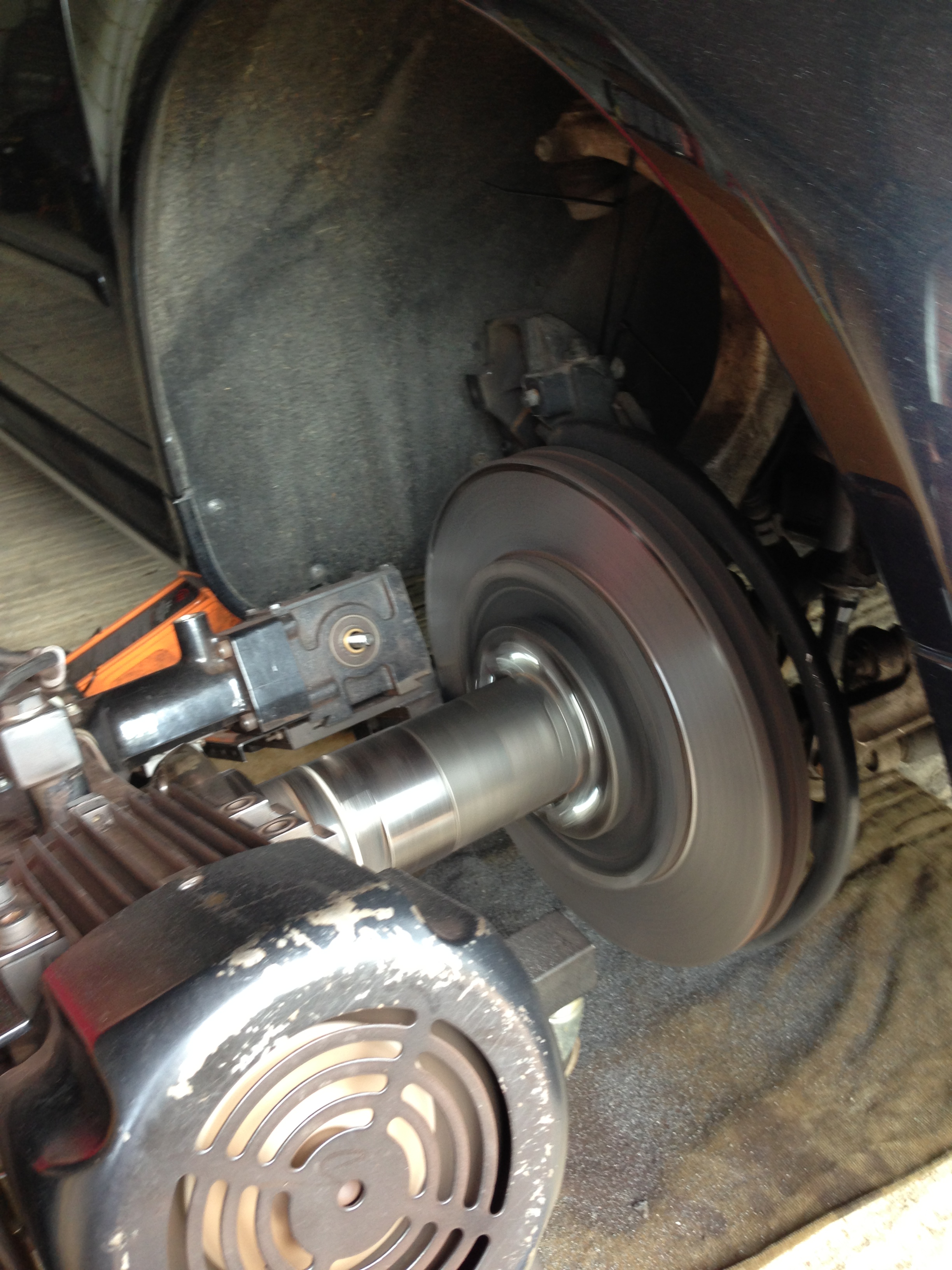

After finding this post and having tried a few of the tricks here to alleviate brake judder. i.e. heavy braking due to brake residue, clean up alloy faces after refurb etc... which didn't work I decided before I bought a new set of discs I would give Marcus @ Disc skimmers a call to see if he could work his magic as he's done previously for people.
So I booked it in and had the work done yesterday - he said my discs were quite bad and the judder must have been terrible (which it was). The front discs were skimmed down to 32.2mm so still within manufacturers tolerance of 32mm. (He won't skim below this) All I can say it that it's transformed my car and I echo the previous comments above - what top bloke who is real professional and really knows his stuff.
So if you have brake judder and don't fancy shelling out on new disks then do yourself a favour and call this guy first to see what can be done - it will save you some money. :thumb:
It cost me £265 (no vat) which included, skim, handle fettle wheels, drill out cross holes, fit new pads. (some of which you might not need)

Haha - not sure on that front? I had to pay his petrol money (£70) as it was done at my house which IMO is far less hassle. If he had to do a few up your way then it might be worth his while? Give him a call.
He recommended to go out and do 3 hard stops from 60-20 then drive a few miles and do it again. Whilst they're bedding in they tend to snatch a bit but that will fade after some more heavy braking. ;-) Really pleased now and feels much better.
