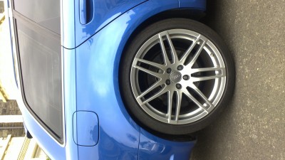

Hi All. Went in to Bristol Audi today to get my front pads changed and the egits had forgotten to order the separate wear sensors (ceramics). Anyhow, they said they had noticed that the rear right side of the car was slightly lower than the rear left and had I noticed anything. As i happens I have and that was an occasional creak, but only when my kids are in the back so I thought it might be something to do with their carseats or some such.
Anyway, I'm back in to the stealers tomorrow for them to have a look and wonder if the collective hive mind has any thoughts on what story I might expect from them? DRC was done under warranty a few years back and I've taken a couple of photos of the rear and I can't see obvious 'droop' (sports + suspension to start with).

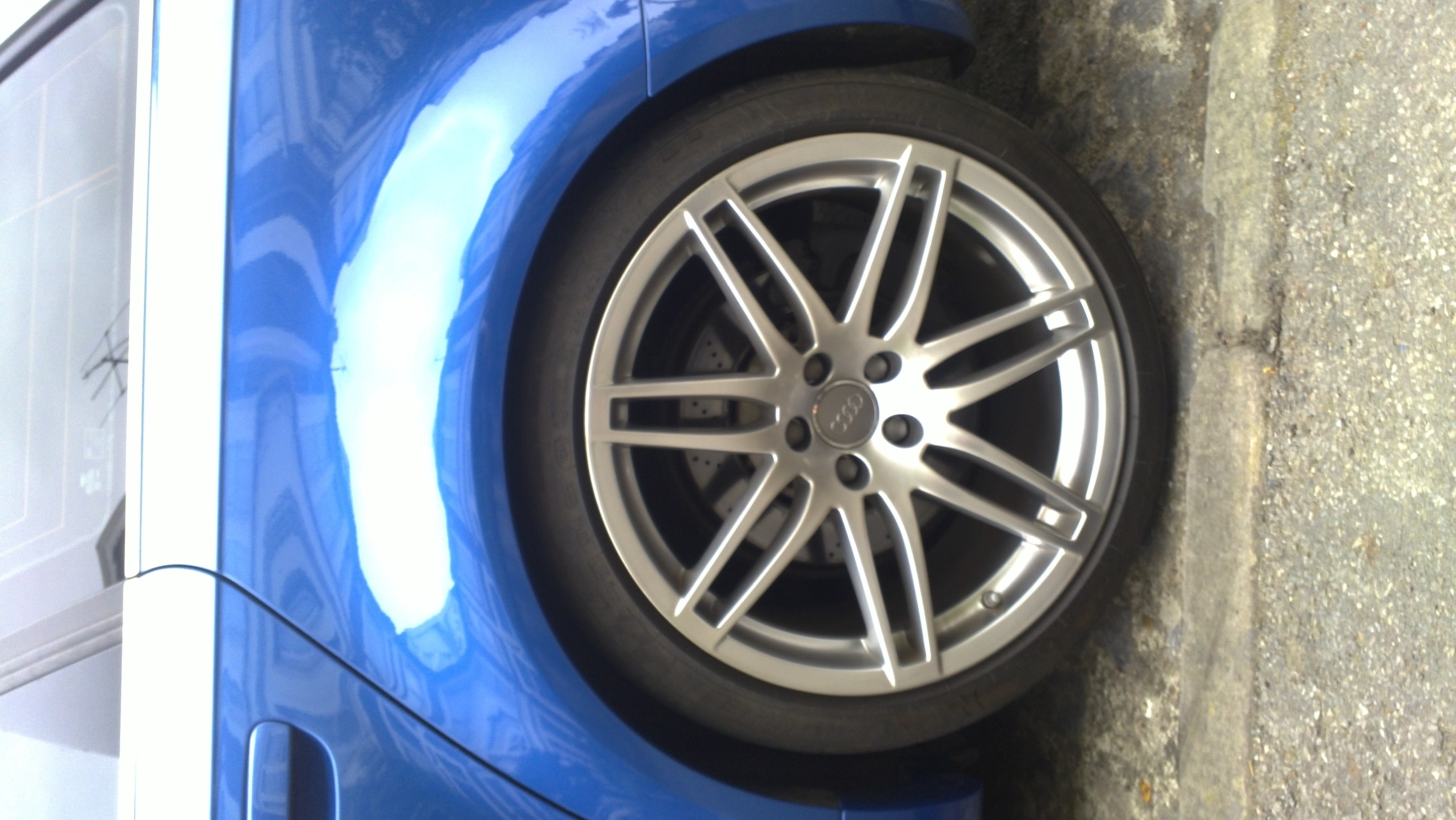

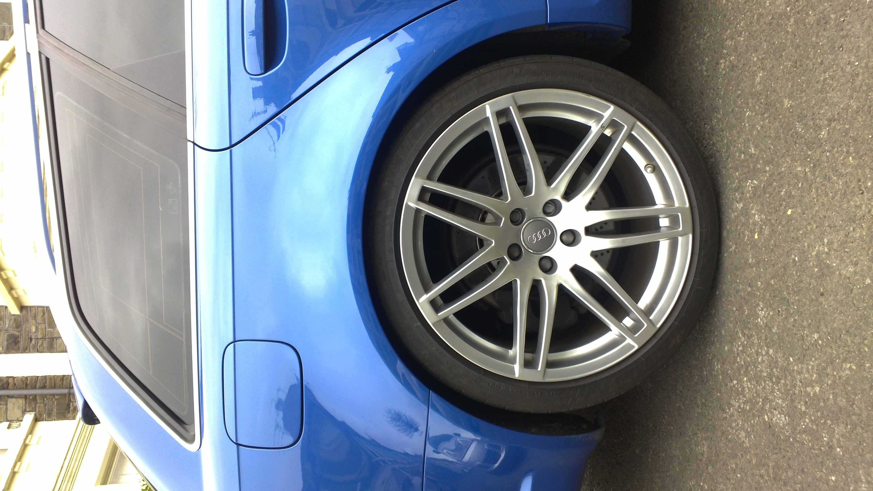

Some days it sounds aweful, some days I get nothing too. Very bizarre. I went out last night to measure the difference in height between the right rear and left rear from top of the rim to the arch and I got about 2mm difference that I think could just be the camber on the edge of the road.
Maybe the Audi guys aren't used to seeing Sports Suspension +, but it always looks low to me as I can't get my hand under the arch to check the tread depth. That seems to be how it is though.

Thanks for that Graeme. I'll do a run around the the back end for everything I can find. I have a sneaking suspicion that this might be a worn bushings issue though. Going over all manner of bumps I can get no noise at all, but in a flat car park going around corners I can get the creak and it sounds like it is form the outside.
I'll give the ARB mounts a lube first and then work from there.
Audi had a look today but were none the wiser, but I parked on a completely flat surface and it looks like the right rear wheel is about 2mm closer to the arch the the left rear. If it is a bushing that is worn then I guess that may cause it to ride slightly lower, not that the car pulls to one side at all
