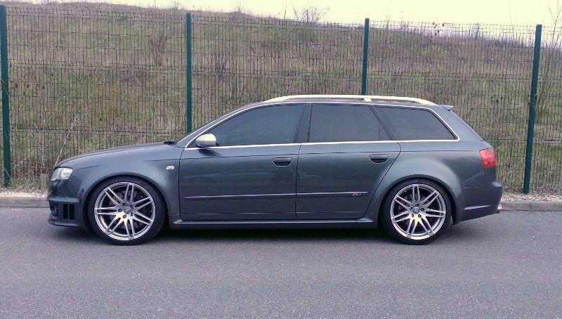

I have been running 20” wheels for a while now and have just gone back to the OEM’s for a while, they need spacing but I’m not sure what my options are running at the ride height I have, I think on standard suspension people run 8mm front and 10mm back, but want to make sure I have no rubbing where it’s currently sitting.
So looking for some advice from people who run spacers on OEM wheels but running on lowered coilovers.
How it currently looks.

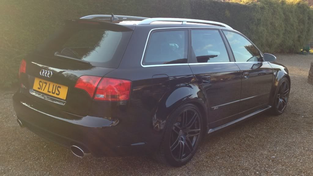

Not the best pic, as you know I'm running 275.30.19Image
