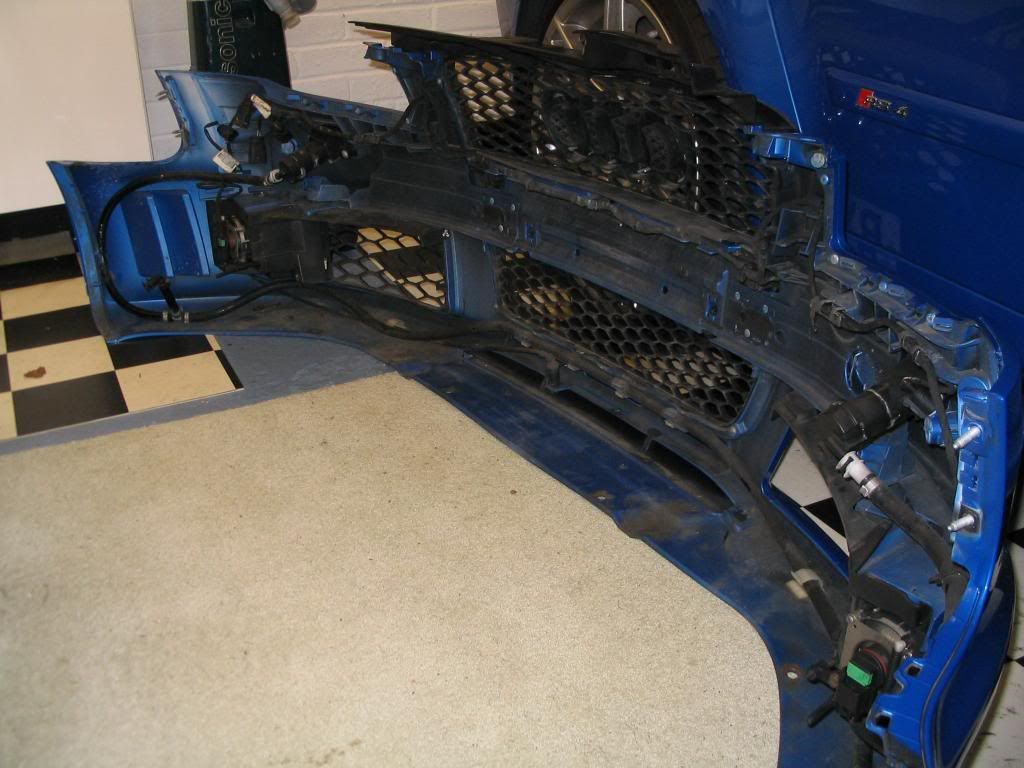

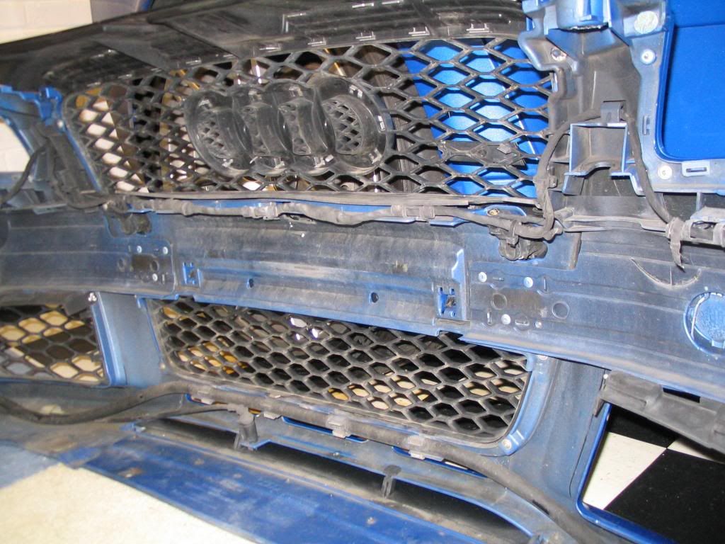

having had my bumper off recently to do aux rad and headlights, i'd say no.
not much room with all the kit around the front end.
couple of pics might help...
