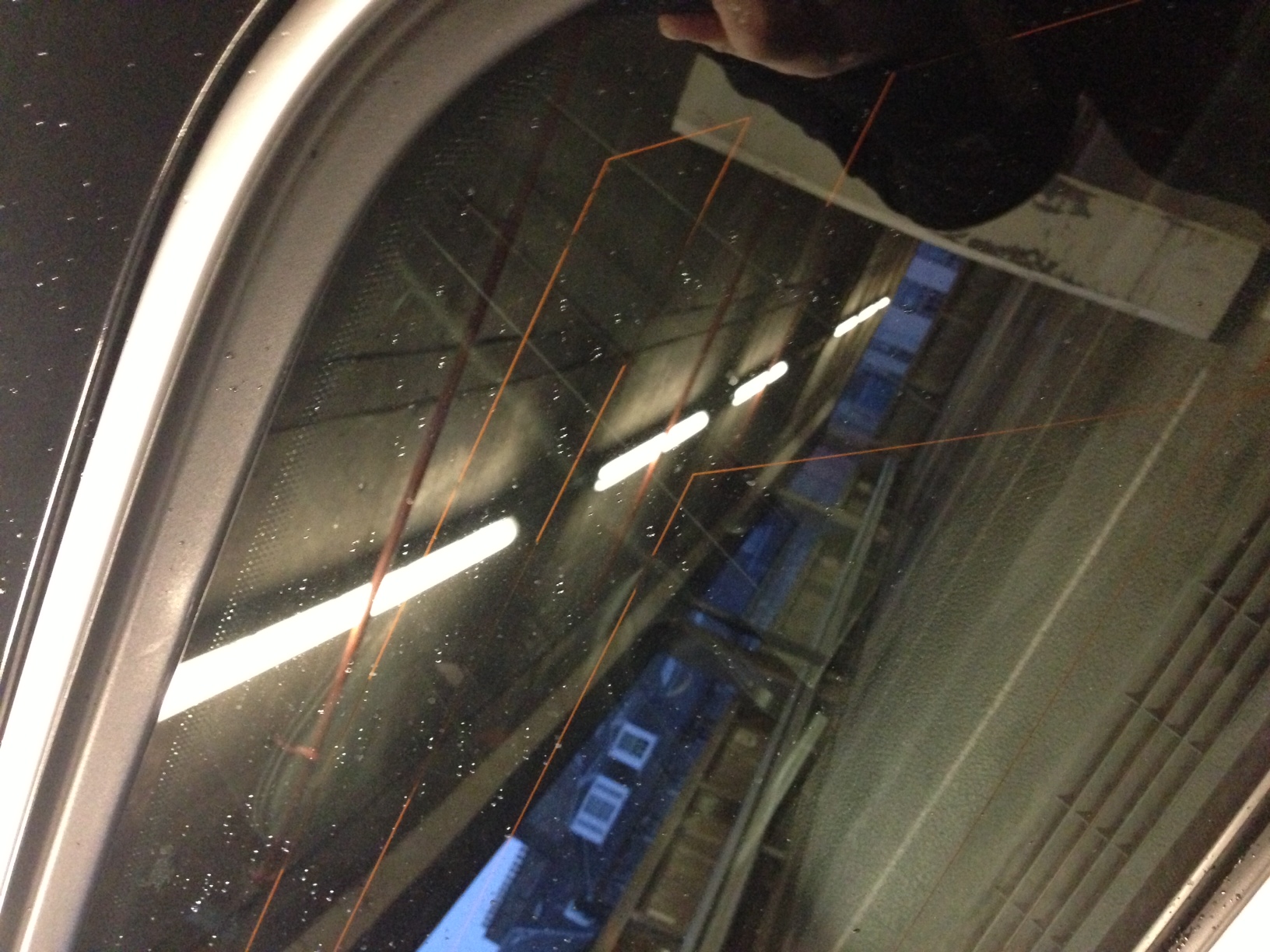

Seems I have the makings of a solution,
I bit the bullet and took it to Audi...they did diagnosis and noticed the elements that run inside the rear quarter light windows and the rear window were uneven/dark orange or broken in certain areas. The most likely cause is a dog in the rear has scratched them off and this is causing the Alarm to think the rear windows have been smashed. Its pretty clear to see in the attached photo.
Pending replacement of all 3 rear windows ...so fingers crossed
Black RS4 B7 Avant
Re: B7 Avant Alarm going off intermittently
Err... IIRc aren't they just heating elements for the demister?Mcarthurr wrote:Seems I have the makings of a solution,
I've never know a car to have internal wiring for the alarm to detect a smashed window. Normally this is done by ultrasonic sensors detecting a disturbance.
Just theen the other thread - I would say more likely to be tv aerial than alarm. Unless there's a huge fecking blindspot?

No they are not, they are a combination of glass break detection elements and radio antennas - the only heating element is on the tailgate (which is also used as a radio antenna).adsgreen wrote:Err... IIRc aren't they just heating elements for the demister?

Might the sensors be disabled via VCDS to see if is the correct diagnosis & potentially avoid new windows too if being replaced just for the alarm ?

Thanks yes good shout I checked the bonnet catch but the Vagcom/VCDS that Audi are using advise that a back window has been smashed. Also noticed the rear window takes an age to defrost and the radio signal is not good, so it could all be related. Thanks MB2 I may just do this in the interim.
