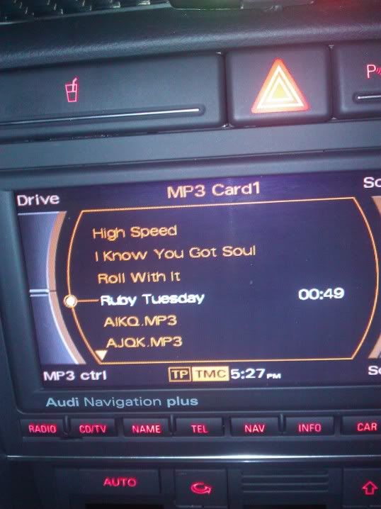

So a while ago I got myself 2 x 4gb standard sd cards, transferred some music on to one of them and of I went. problem is only some of the tracks play.
In the photo below for example, High speed is the first strack (purely by chance ! ) and then the next track that plays is Ruby Tuesday so it misses the other 2. Any ideas ??

I have got some more info though. I started thinking about where the music came from and 90% of it was CD's that were scanned into iTunes. I went back to my old ipod source files that used to feed iTunes and Coldplay High Speed shows as an MP3 and I know you've got soul shows as an mp4a file.
After conversion they all show as standard mp3 files but perhaps they are not actually, and have retained their MP4 status, hence the comment from DALO "MP4s will show on the list but won't play"
So here is the next question ! Is there any way I can convert my old iTunes files which are a mix of mp3, mp4a and m4p files to be just normal mp3 files ?

Ok thanks everyone got to the bottom of this now, just used an online converter to re-do the I know you've got soul file to MP3 and copied that to a blank new sd card and it plays fine. So it seems my iTunes conversion has not worked on some of the files even though it's changed their extension.
So anyone recommend a good converter where I can do 900+ files and either get it free or at a cheap price and it won't infect my laptop ??!!
