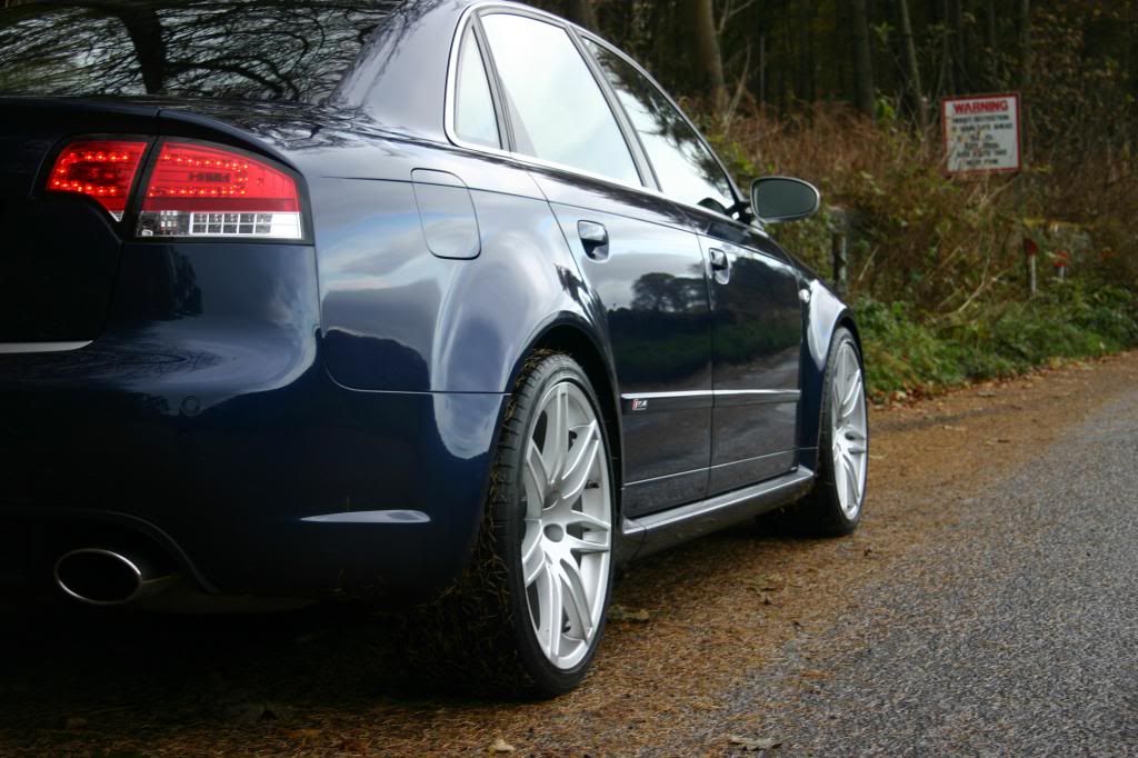

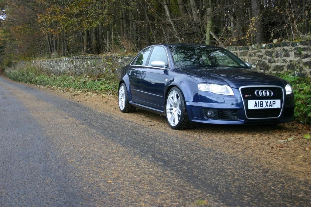

Finally fitted my springs on Saturday that i bought from Andy (RS4shaw). Big thanks. Gives the car a far better look to it now. Very happy with it. Feels a bit sharper too. :kissmyrings:
It has went from this
To this
Alex

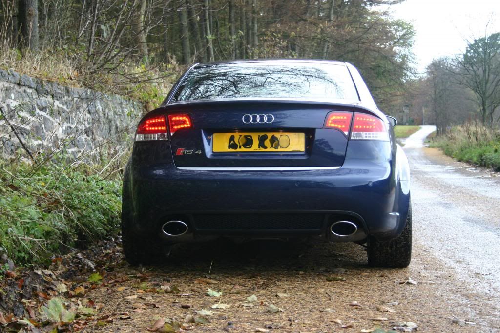

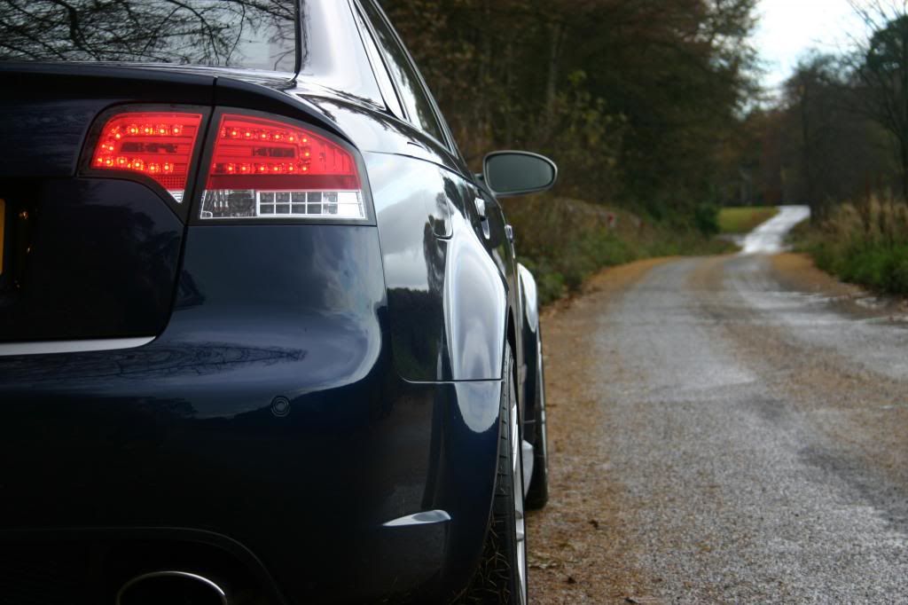

Hi Alex any photos of the rear of the car to show the lights?
Look good!
ShouldveBeenAGerman
Posts: 336
Joined: Tue May 25, 2010 9:23 am
Re: H&R springs fitted
Post by ShouldveBeenAGerman » Wed Nov 07, 2012 7:22 pm
Looks great!
Well done for fitting yourself
<Shameless Plug> I've got my set for sale here http://forum.rs246.com/viewtopic.php?f=64&t=98796 </Shameless plug> :biggrin3:
alex020869
Posts: 357
Joined: Fri Feb 11, 2011 11:18 am
Location: Edinburgh
Post by alex020869 » Wed Nov 07, 2012 7:48 pm
Simon,
You are correct with regards swapping the spring in the wheel arch rather than on a bench. I just clamped the spring then disconnected the strut and had it facing out the wheel arch. The new spring doesn't need to be compressed but having an extra pair of hands to help with putting the nut on a couple of threads is invaluable. I needed to support the strut and compress the spring whilst someone put the nut on.
No issues with speed bumps. I have 2 different types of speed bumps in my street and no scraping. Still drive over them at the same speed as before.
Women however, are a different problem altogether lol.
Faz,
Hope these pics are of use to you. If not i can take some more for you.
