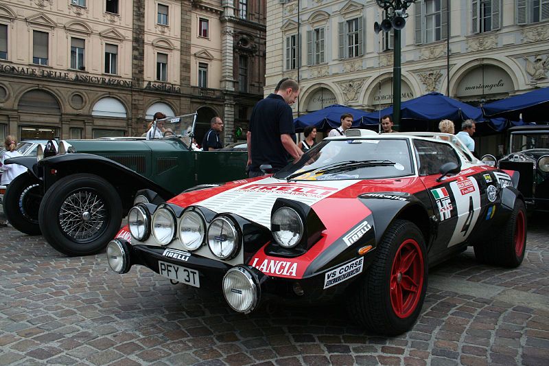

As an old git, I always remember the Lancia works Stratos running what looked like ridiculously narrow tyres on snow stages.
- what those guys didn't know about winning rallies wasn't worth knowing
Spot the difference?
Best to cut down through the snow rather than float over the top of it?
