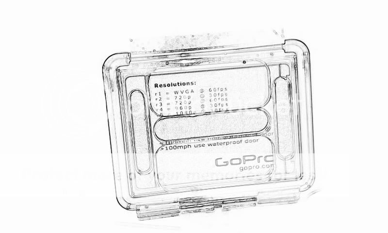

What backing did you use on the GoPro, the open or closed vent cover?

Re: I can't tell the difference...can you tell the differenc
sonny wrote:What backing did you use on the GoPro, the open or closed vent cover?
open...this one
