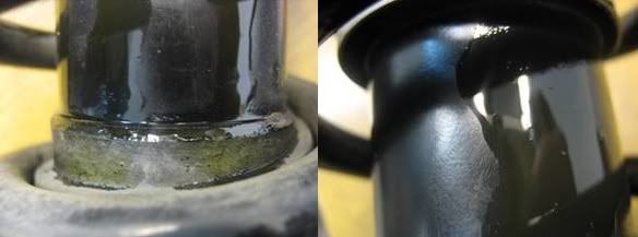

Oil on the shock is "ok" depending on where it is.
Oh - just thought of something else... The rubber top mount of the front shock is oil filled. These can split and leak onto the damper and make the damper knock a bit.
This image to me looks like what you'd get if the rubber oil filled mount at the top failed. The fluid is leaking from the top around the outside of the damper. As far as I can find out when DRC fails it's the inner seals that let go so it sholdn't make it to this part of the shock. This isn't a DRC failure and 99.9% won't be covered at all. However labour aside shouldn't be anywhere near the cost of replacing a DRC strut.
This looks to be an extract from the Audi DRC TSB. You can see on the second picture the outer shell casing of the damper covered in a oil residue. Often referred to as "misting" this isn't a DRC failure and is common with all shock absorbers - VOSA MOT guidelines specifically say that a presenting with this condition is not a cause for an MOT advisory or failure.
A leaking DRC shock to be replaced - large obvious wantity of oil leaking from the piston seal down the damper shaft.
Hope that helps.
