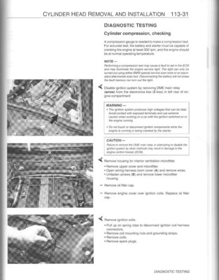

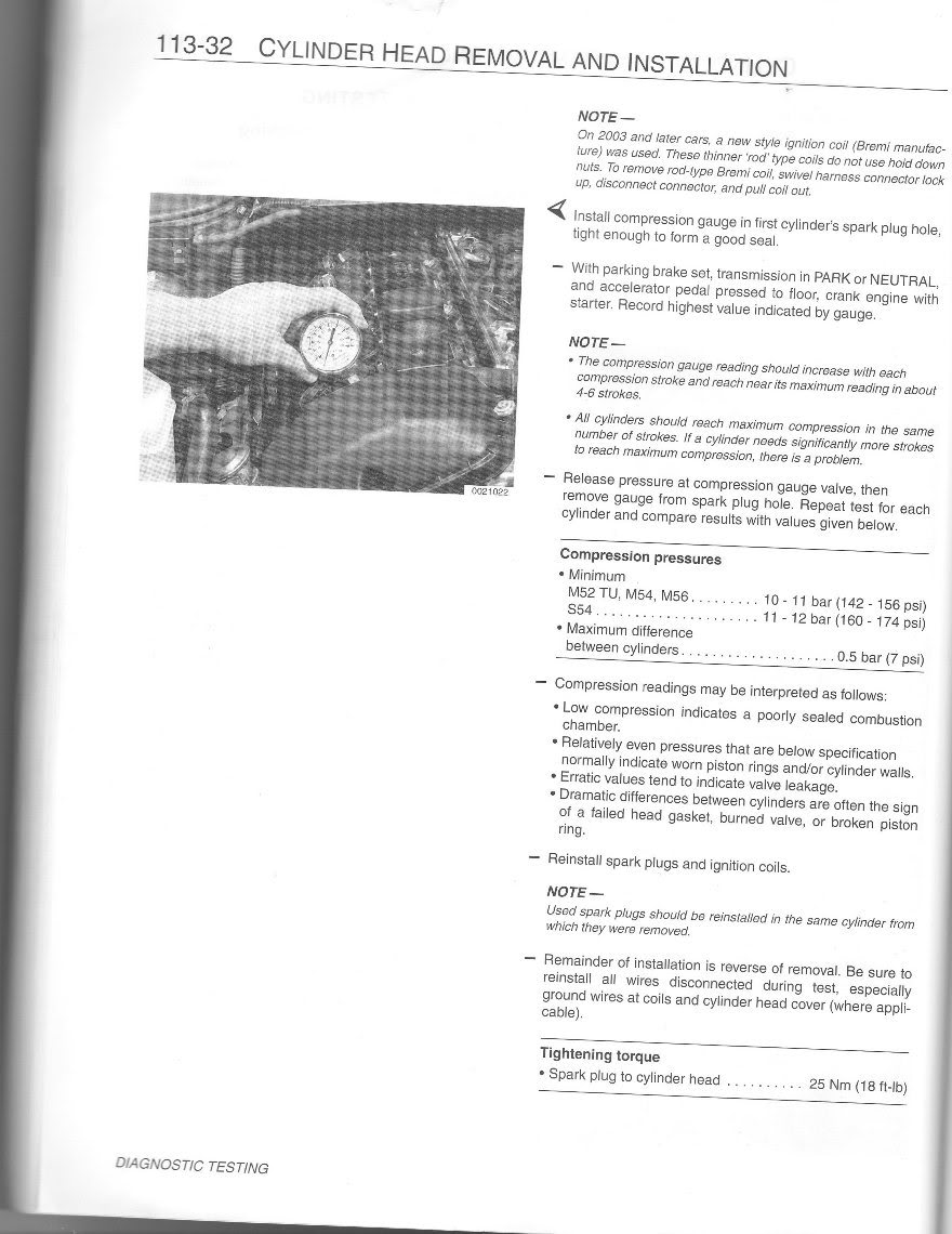

without being an alarmist they shouldn't be that low (I'm guessing 175 to 190, 12 to 13 bar, is spec)
there are 2 tests, dry wet
do dry first, then wet
engine should be at operating temp and cycled 4 to 6 strokes
generally an engine should make 1 atm x comp ratio...
spec for the e46 M3 is 160 to 175 psi (11 to 12 bar) or so cr = 11.5:1 (11.5 bar to one)
max deviation is 7 psi
wet is the same but a teaspoon of oil
if test is substantially higher rings may be worn
does anyone know the shop spec for the RS4?
Re: A Query for those technical out there
Yet only a few weeks ago it made 407 bhp on a dyno and adsgreen suggests the figures are near spot on? I can't see how in the space of a few weeks the piston rings have become so worn that they are all below minimum tolerance which is what that bulletin you have attached suggests because all the pressures are similar. Has anyone else done compression testing on their cylinders and can share their numbers?
I'll do the 3k-8k rpm test tomorrow and see what the results are. If near the same as they were before then either the readings were down or something else is amiss.

I'm guessing the numbers are wrong, ie, low...perhaps the throttle wasn't held open, it wasn't cranked long enough, etc.P_G wrote:Yet only a few weeks ago it made 407 bhp on a dyno and adsgreen suggests the figures are near spot on? I can't see how in the space of a few weeks the piston rings have become so worn that they are all below minimum tolerance which is what that bulletin you have attached suggests because all the pressures are similar. Has anyone else done compression testing on their cylinders and can share their numbers?
I'll do the 3k-8k rpm test tomorrw and see what the results are. If near the same as they were before then either the readings were down or something else is amiss.
I think the compression is fine for the reasons you stated, but perhaps the test results are incorrect
I'm trying to get the manual spec numbers...
