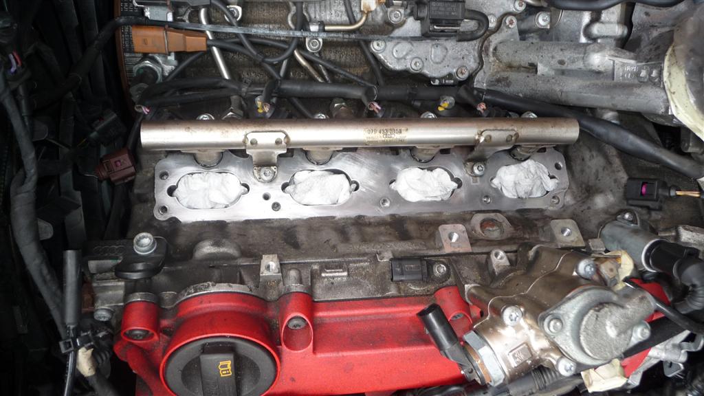

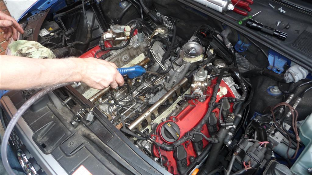

I'm told they're scotch bright's that are used for paint work, there's no way they would scratch anything and cause problems.
7 ports cleaned, 1 to go then the rebuild starts!!

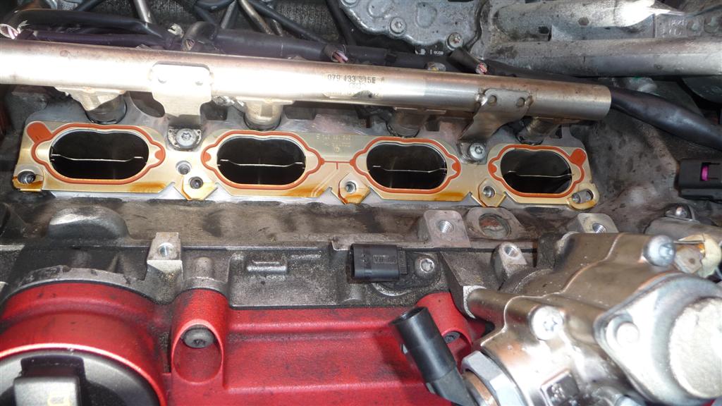

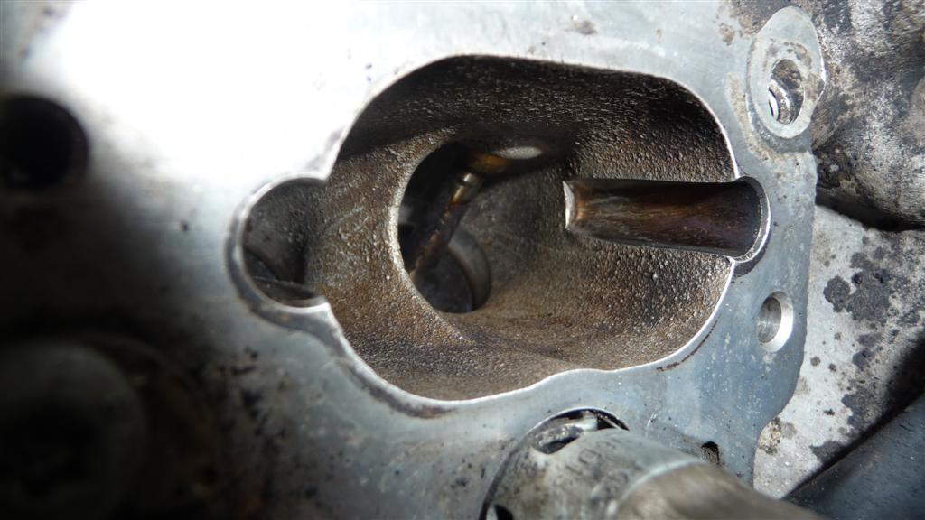

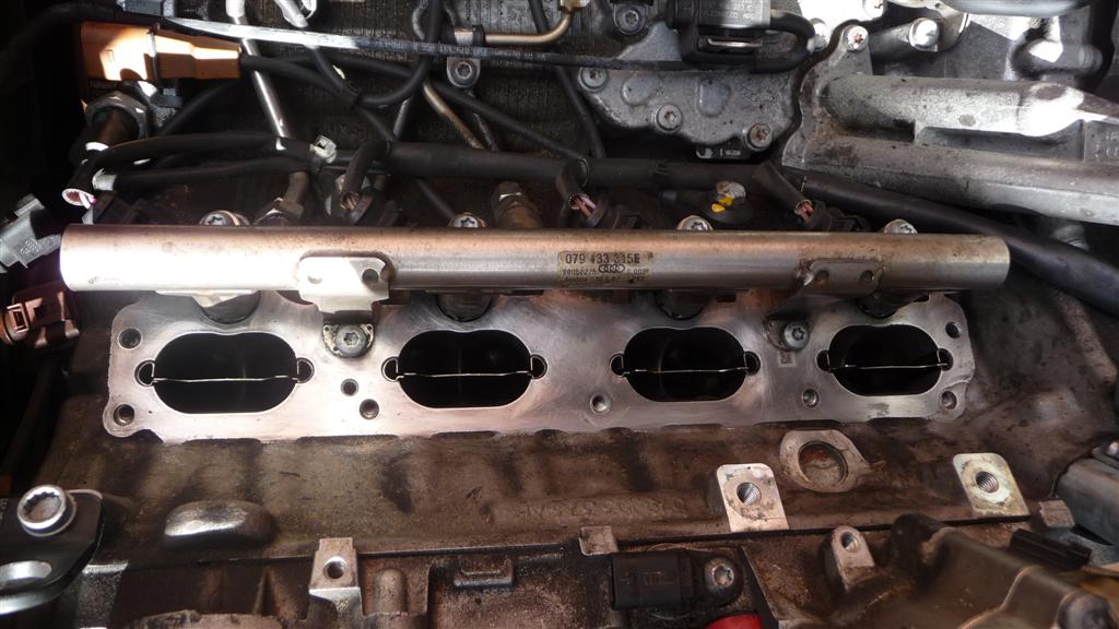

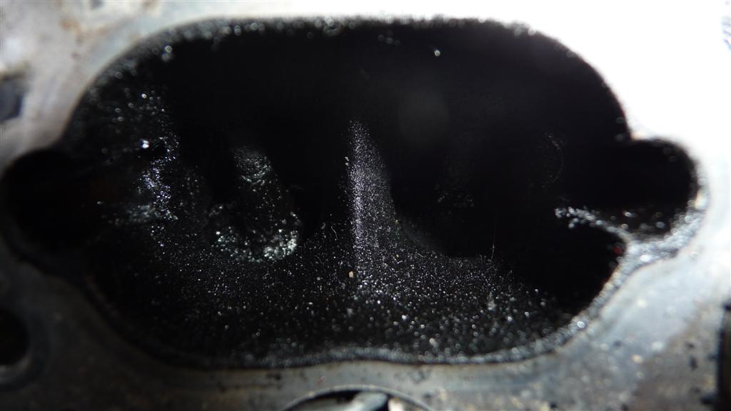

good job

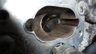

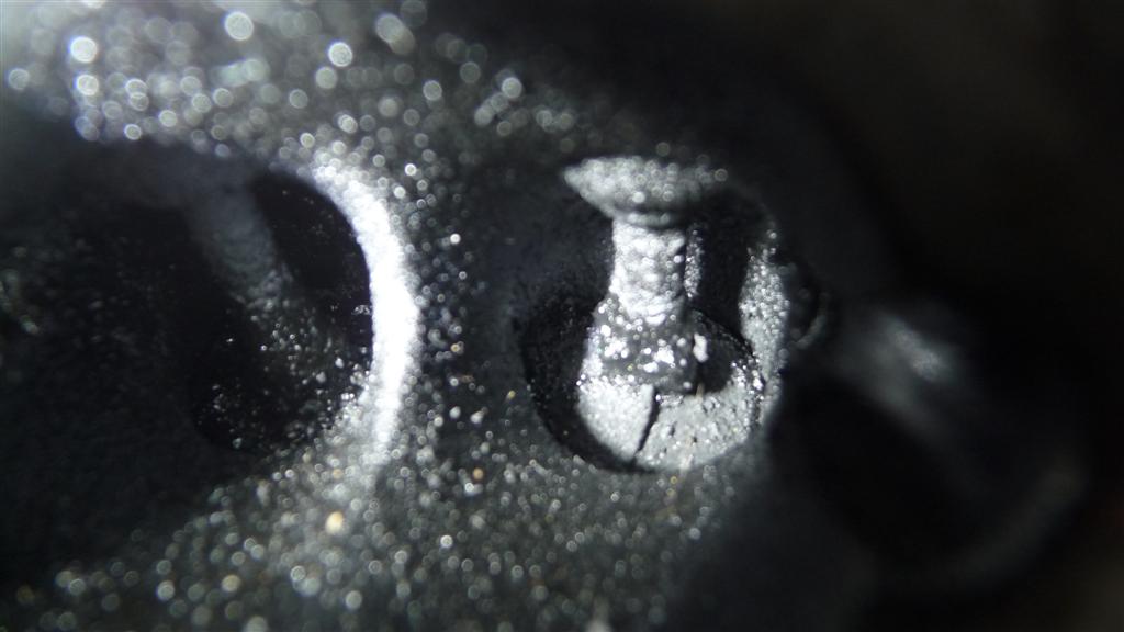

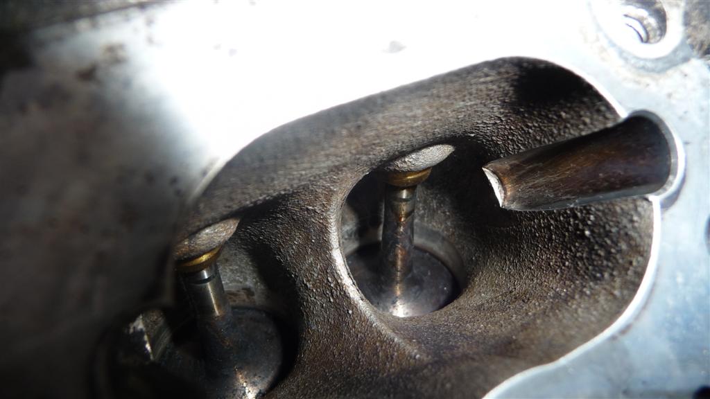

do you have any pics of the valves?
that doesn't look bad for 50k miles, about the same as mine were

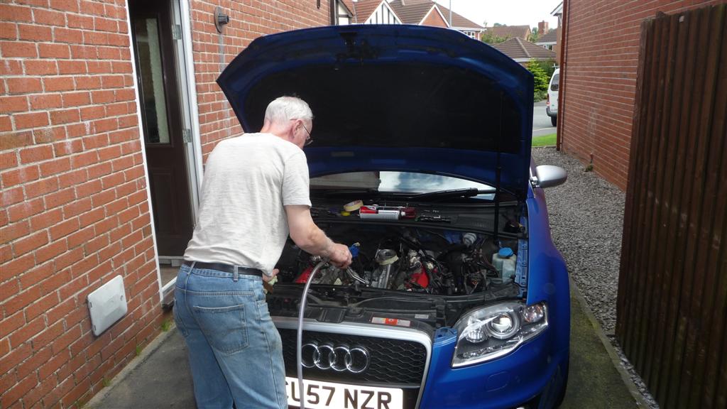

All done!!!
Car started first time but complained about coolant, remembered the plug wasn't attached to the tank, oops!
Started again, all ran well, seemed very smooth at idle.
Am taking her for a spin later, will post more pics, findings, lessons learned, risks and issues later (can you tell I'm a Project Manager?)

After seeing those pics without a doubt that is the next thing I am having done.

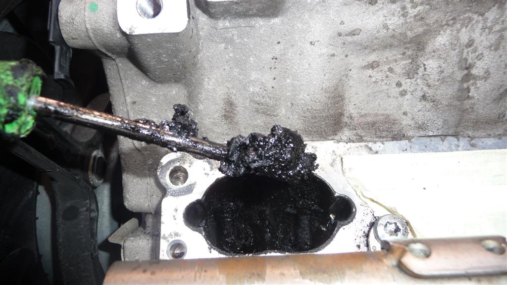

That pic with the carbon on the screwdriver blew me away!
Nice work

As we were cleaning a side each it was like a competition to see who could get the biggest piece, that one didn't even win!RSKiwi wrote:After seeing those pics without a doubt that is the next thing I am having done.
Nice work
I was surprised at how much was in there, made me wonder how the engine even worked with all the gunk.
