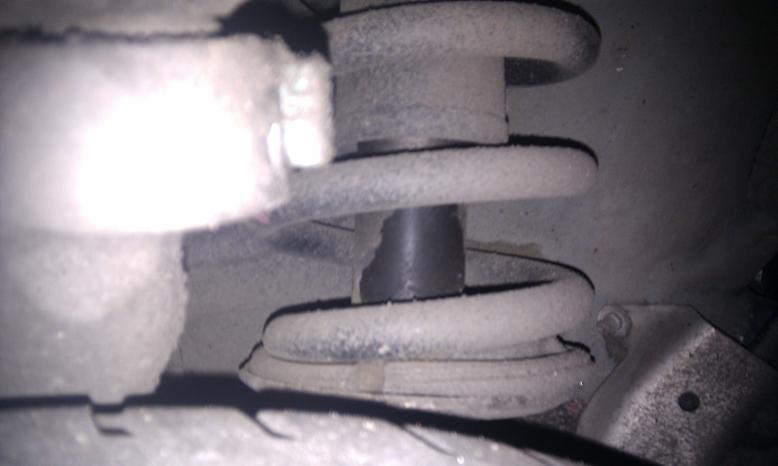

How can Audi say this is normal?
If the system is pressurised - and it leaks, the pressure will drop. Even a child can understand that.
Anyway, I have a few pics of my front shock but I'll show them later. Currently car is with Audi and know that some Audi reps do read this forum too....so, will await the outcome.
Well heres the update....a a few photos. Between the first and second pic is 100miles), the first picture being the latter.
...seems that leakage (or weepage - didn't know there was a difference), is normal, so car back home with nothing done. As car has very few miles (5k in last year), intend to hand it over to the wife to use for the next few weeks and check again (although she is pi**ed off and just wants to trade the bugger against a STI 330).
Will I be renewing Audi warranty??? Emmm .No.

Think if it was me, i would be telling Audi that i am going to take it to an MOT station at their cost if proved faulty. If the shock is wet to touch then i think everyone would agree that it is leaking. Therefore, it should be replaced. Bet the MOT station would fail it.
Alex
Alex
RS4 B7 Mugello Blue Saloon
TBH aiden having seen the Audi disgnosis pics that is classified as weeping and not leaking. It looks damp but leaking is seeing physical fluid on the shock.
And as PetrolDave suggests, it is at 15-16Bar pressure on a small amount of fluid; if the pressure were to drop below 12 (designatied minimum tolerance value) then they will test and if necessary replace. Did they do a pressure test for you?
The repressured system last year (5k ago) at my cost and car had been fine. Didn't do anything this time other than look.
