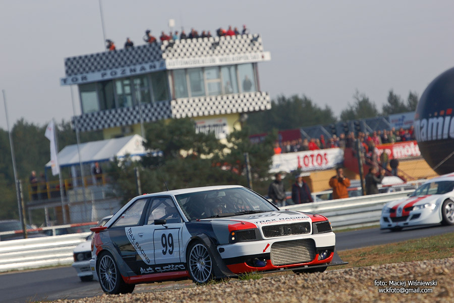

Post by AKmotorsport.net » Tue Dec 28, 2010 7:55 pm
PetrolDave: there is always something to fix after a manufacture. He is going for mass market. I don't own a rs4. I will have RS4 B7 gearbox in my race S2.
Everybody chose it's way for mods. Some put 22 inch wheels and some try to make their car handle best possible way. To get there you need LSD all around + good brakes + best possible suspension (shocks, springs, sway bars + some other mods). With a setup like that you can go for a racetrack.
For daily driver RS4 is very good car form the factory, but it can be modified to handle better than stock. For daily driving I use RS6 C5.
In my race car I'm running something like 275/35/18 wheels.
I have rear LSD and I was looking for front one for RS4 B7 and I hope I have found it. Will know first week of next year.
