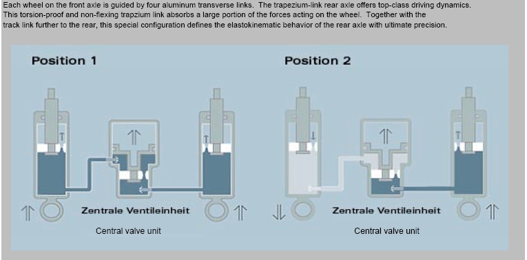

Mike_Bike wrote:the system volume must change, if it were constant when one shock went into bump it's opposite corner would raise by the same amount.
the fluid makes the diaphram 'gives' or absorbs by compressing the gas, from what I understand...the shocks are isolated by the accumulator
and the fluid is non-compressible
also some of the state change (pressure delta) is made by forcing fluid thru the orifice making a pressure drop/loss
although the 'fluid' doesn't go from side to side (since the volume is constant and filled with a noncompressible fluid) the hydraulic force is transferred, which is the principle behind its operation...

Ok so looking at the diagram the accumulator acts as a damper between the two dampers if you like? It will transfer some of the fluid from the compressed shock absorber to its opposite one in the system? Correct yes/no?

There is an extra port in the centre valve by the looks of things, when both shocks are compressed (so a bump in a straight line) the valve is open and the fluid in the dampers can pass through both the normal ports in the shocks and the one in the centre valve.
Then under roll when one shock is in droop and the other in bump the valve shuts isolating the two shocks and removing the third port which makes the dampers stiffer in roll (two passages instead of three = more resistance)
that is my guess from looking at the diagram

That was my thinking also,if you went into a big dip in the car and compressed all struts it has to go somewere ie the accumulator

if you compress both: they both pressurize (compress) the accumulator and the forces cancel, resulting in little movement...
if only one compresses: fluid (actually pressure) is forced to the accum and fluid thru the shocks piston orifice
this is balanced by the other shock which is expanding so it will take pressure from the accum that the compressed one supplied conteracting the internal forces, ie, counteracting the opposite damper...
the net system volume stays the same
for a given shock you have 2 chambers, say upper/lower, and when neutral the V for each is 50/50, piston in the middle, when compressed the piston moves altering eaches volume, say 40/60, but the total remains the same...fluid doesn't really 'flow' to the accumulator per se, a force is hydraulically transmitted...
it's a clever system, and I really like the way it drives/rides/feels
very soft and smooth over small disturbances, and firms up when the impulse or movement gets bigger

lengster1 wrote:Ok so looking at the diagram the accumulator acts as a damper between the two dampers if you like? It will transfer some of the fluid from the compressed shock absorber to its opposite one in the system? Correct yes/no?
that's a good way of looking at it, but not really fluid movement, but pressure or force, transmitted by the incompressible fluid...
so hydraulic force is moved back and forth, not so much fluid...

lengster1 wrote:That was my thinking also,if you went into a big dip in the car and compressed all struts it has to go somewere ie the accumulator
the fluid actually goes thru the shocks orifices on the piston...the 'force' is absorbed by the accumulator...and the counteracted by the force from the other shock...
think of 2 garden hoses of the same ID, length, etc., each fed from a spicket with 50 psi...
if you connect them together no water will flow...and the pressure in the middle will be 50, not 100...
now put a sealed isolation diaphram between them...
